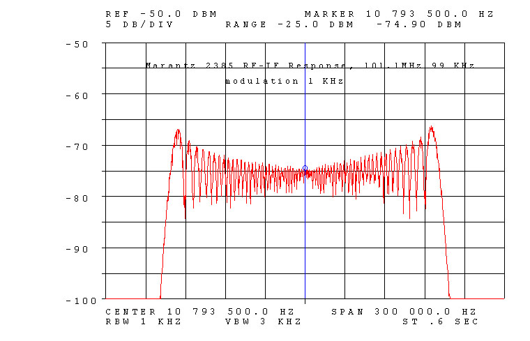

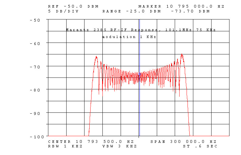

I guess I can try to generate other types of modulation, but here you will see a couple that will be very familiar to anyone working on the IF strip of an FM tuner. These happen to have been taken from a Marantz 2385 I was working on last year.
Because the spectrum analyzer I'm using is a swept type (HP 3585A), it "sees" the results of sweeping the fundamental frequency back and forth at 1 KHz (in this case). The only way you could get something that looks like AM modulation is to capture the fundamental, and the high and low limits only. Otherwise, any sample or sweep will show many of the discrete frequencies as it does here.
I'm not really sure what you did John, can you post what you are seeing?

Point well taken, but look at the levels, are they not a little too much to ignore? I would have to do the entire test over, just to be sure, because the actual waveform frequencies are guessed at (by Janneman, I presume), and not measured. Also, we don't have the spectrum changes with level, that are not put on the paper. This is unfortunate, because I did many of the tests, myself, and this would bring out any real deviations.
However, I give it over to you, that the added IM byproducts 'could' be accounted for, perhaps. I still am not sure about this, because FM modulation of the the fundamental test frequency would create the same sort of symmetrical sidebands. Perhaps, my other associate will resolve this dilemma in a few months (that is what he told me, last week) when he decides to show me how to measure PIM by HIS method.
Hi John,
I'm guessing you are responding to my post. I agree, the levels of those blips are way too much to ignore, and should indeed be added into the TIM calculation. I'm just saying that they are not inharmonic and that they are not unexpected when hitting a 741 that hard.

It is difficult to separate AM from FM in the graph by anyone, that can be absolutely proven, without completely emulating the test. I am not in a position to completely emulate the test at this time.

Before you go, Jan, PLEASE note the SYMMETRY or lack of it, of the pips that you labeled, and then recheck your math and the predicted frequencies of the 2F-N products that YOU put into the graph, and see if they ARE symmetrical as well. They aren't, by my calculations, how about yours? Did I overlook something?
John, they all line up. That's just the way it is. Let go of it and move on. I will also move on, the peanut gallery is agitated again and they should find peace.
I don't think so, check again. Please look carefully, this time at 2f2-8f1, and 2f2-6f1. Symmetrical to 2f2-9f1, and 2f2-7f1, respectively? I think not. Yet, the frequencies on the graph are symmetrical. Look, I don't mind being proven wrong, just do it properly. This is now between Mitch and Matti, I am only the messenger.
