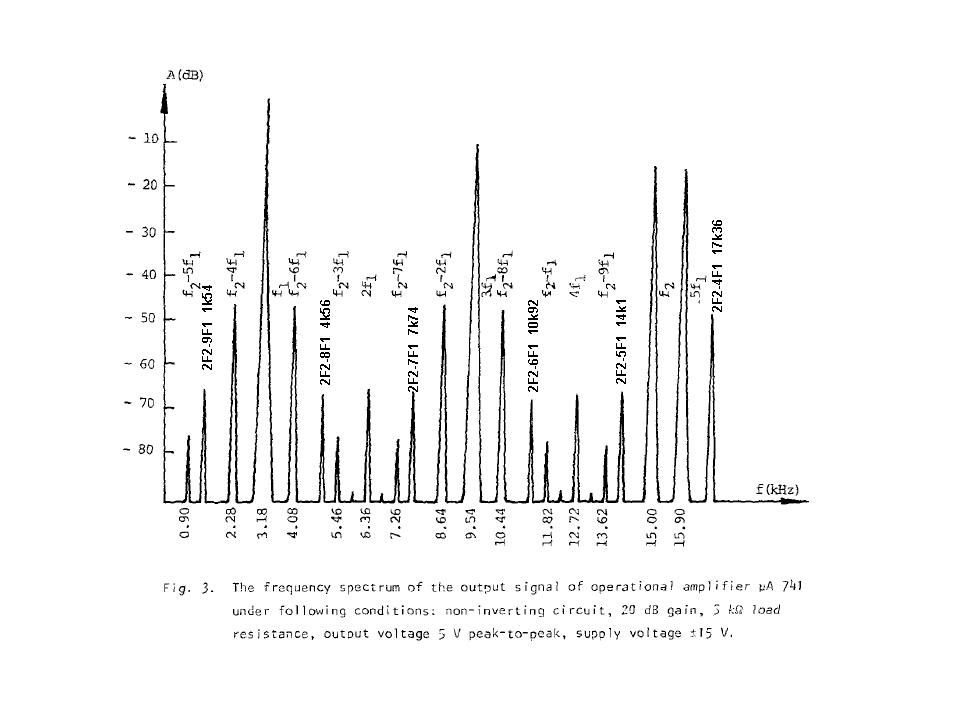

Janeman, look at around 5K and 1K for a balanced pair of sidebands. NOTE that they have no ID on them.
Ahhh yes, actually there's several pairs of them. Hmmm.
Did you guys really disregard those? No questions from the audience at the presentation? SOMEONE must have noticed that at the time and have an explanation. No?

So this is the Fig 3 John has brought up. What is that confounded 'blip'?

Thanks Jan, you have to be kidding? Hopefully the scale is linear enough to get close but those will all be related to the input (remember two intermods can beat and gererate even more). With this much distortion you can go up to many orders.

John, if you plot the following components:
2F2-4F1;
2F2-5F1;
2F2-6F1;
2F2-7F1;
etc.
where do these components fall on the graph?

Jan, apparently they DON'T, that is why they are NOT labeled! That is what makes this a 'breakthrough'. However they ARE symmetrical around each major test tone. Doesn't that look like FM sidebands? It is up to SCOTT to prove otherwise. Scott, talked to Sequerra yet? He has been hinting this stuff to me for YEARS, and now we can run with it. Why not?
Jan, apparently they DON'T that is why they are NOT labeled! That is what makes this a 'breakthrough'. However they ARE symmetrical around each major test tone. Doesn't that look like FM sidebands? It is up to SCOTT to prove otherwise. Scott, talked to Sequerra yet? He has been hinting this stuff to me for YEARS, and now we can run with it. Why not?
Come on John, you said earlier they were not labeled because they were 'overseen'. Now all of a sudden you have some hazy reason why they are not labeled. It does not look like FM sidebands, it looks exactly as labeled. Maybe they are FM sidebands, but YOU make the claim, YOU prove it. Don't try to dump it on Scott. Stand up for what you say man!

Sorry to say they do, I don't want to be meany and prove it. I ran through a few off the cuff this afternoon. Dick designs tuners, can he make the IF a non-harmonic of the input/LO? I want him to tell me that.
