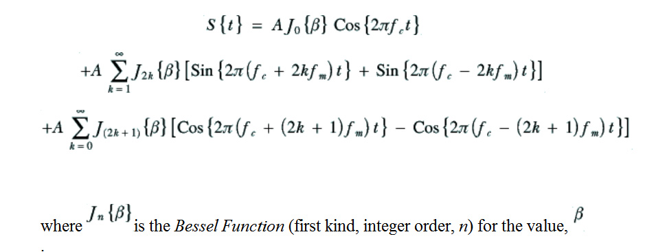

The problem is with an intimate understanding of FM modulation, how it happens, what it looks like on a spectrum analyzer. I only have a partial understanding of this, so I am reluctant to 'teach' others about it. Yet, I have 'hit the books' and maybe the test equipment in future, to get a better understanding, so that I can even teach a wider audience, what we have found.
The 'smoking gun' is FIG. 3 of my Matti's and my AES paper on TIM. It is OBVIOUS from looking at the measurement, that there are extra distortion products that DO NOT REPRESENT what we would EXPECT from the test itself. Not knowing what they were, we just IGNORED them. After there was plenty of other distortion products in the same figure that showed what we were trying to measure and point out, at the time.
I have been shown that these are FM products, NOT IM products. How do we know? We know, because these products are NOT harmonically related to the test signal components and appear is completely unrelated to the test signal itself. Any engineer would get nervous over this, because that is not supposed to happen.
All I can ask of anyone or everyone, is to read up on IM distortion products, before telling me that I don't know what I am talking about. That is all I ask here.
I posted a link to a fairly easy to read derivation of an FM signal yesterday and I will repeat this is just plain wrong. Your measurement could be contaminated by mains or any subharmonic (FL lights have a spectrum out to over 3000Hz BTW), any horizontal or verticle display frequency, and ALL their subharmonics. I have a test CD from SONY labs that is clearly contaminated with 15,750Hz (made under strict laboratory conditions).

We probably have a bit of a case here of the blind leading the blind. I suspect that you and I are equally ignorant of the details of fm. We each perhaps know enough (or think we know enough) to be dangerous.
I would really like to have somebody more knowledgable step in here and explain how fm with very small deviation creates inharmonic spectral lines. I was always taught that narrowband fm is essentially like am but with the phase of the sidebands just different. I completely understand that this is not the case for high-deviation fm, where Bessel functions are essential to a proper understanding (but I do not believe that PIM falls in the category of high-deviation fm).
All of this does not mean that we should not ask each other tough questions. All of this does not mean that the person making an initial assertion should not back it up as much as possible and try to directly answer the tough questions.
This kind of interchange is how we all learn, including both those more experienced and those who are less experienced.
There are many things you and I disagree on. Those discussions have always challenged my thinking. What doesn't kill you makes you stronger. I have probably learned more from discussions (and arguments) with you than from most any other people. In some cases it is self-taught in trying to examine arguments to put forth myself in those discussions. I can say exactly the same thing about Matti. I certainly did not agree with many of his assertions, but I learned a lot from him and a lot from challenging him.
So let me ask a few direct questions.
Do you agree that what we are dealing with in PIM in at least semi-decent amplifiers is essentially narrowband fm? If not, why not?
Do you agree or disagree that the application of Bessel functions is necessary to gain an even decently approximate understanding of narrowband fm?
How can Bessel functions create in-harmonic spectral lines?
How do you know the EXACT frequency of that blip. It would seem to me that you would have to know that frequency with fairly high precision to know that it is not an N/M frequency (even if you did not EXPECT it there).
In how many other DIM tests did you see the presence of this frequency component that you did not "expect"?
You personally may not know the answers to some of these questions. That's OK, but I would still like you to let us know what you think the answers might be. Even more importantly, if you have been discussing this topic with others much more strongly versed in fm theory you should be able to get those answers from them and relay them accurately to us.
Standard text book derivation of an FM signal, the Bessel functions describe the magnitude envelope of the spectra. The frequencies present are all harmonically related to the input.
No, you need to do due diligence in finding the unexpected lines before making extraordinary claims.
