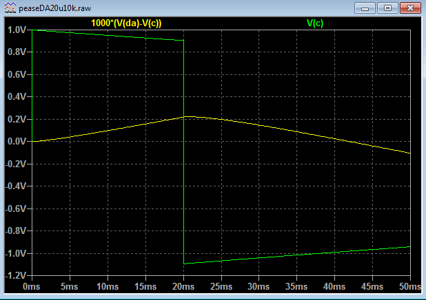

I did include the .asc of the Pease Mylar cap linear DA model in http://www.diyaudio.com/forums/the-...owtorch-preamplifier-ii-9966.html#post5335040
anyway, here's the step response diff (x1000)
~72 dB down for the 20 ms pulse ~ 1/2 a 25 Hz square wave
That looks reasonable to me, although the pulse droop is different than in John's photos. It shows that the caps differ for a time around the transients then settle to the same baseline. It's what would be expected from a multi-pole ladder filter compared to a single pole RC filter. It would be helpful to see a less horizontally expanded view too, with a few cycles shown so we have a better feel for the bigger picture.
What I don't get about the scope images in John's article are the short sort-of-hysteric differences around pulse switching transients. It looks like either some nonlinear distortion in a cap or some problem with the test apparatus. Unfortunately there are no time-scale expanded images of the transients, and no explanation by the authors of what they think the images show, especially in that region.

Looks like the square wave is not symmetrical about zero (non-50% duty?) so we see a varying DC on the cap. As theory predicts for an ideal cap. ;-)

You guys seem to miss the 'forest' for the 'trees'. Typical low cost, medium-high volumetric efficiency caps have multiple problems compared to the highest quality film caps like Polystyrene, Polypropylene, or Teflon.
DA is just part of the problem, but non-linear distortion, tempco, microphonics, and hysteresis are also factors, depending on the cap type.
Asymmetric signals are the norm in audio, not pure sine waves like we like to use for testing. DA shows itself in a real way with asymmetric signals, as a non-nullable error and that is why the test signal that Walt and I used is asymmetrical.
Is this differential comparison test perfect? NO. In fact, Richard Marsh declined to participate in the paper, because he thought the test was not ideal in depicting DA accurately. However, I saw that the test was relatively easy to implement (thanks to Scott's AD524 that is very good in this application) and that it invariably showed that 'something was wrong' with how most cheap caps handled this sort of test signal, compared to better caps, yet could look pretty good with just sine wave testing. It can be seen that the actual signal path is modified in a different way than the best caps due to DA, non-linear distortion, etc and this is what is important to note. Now, of course, ALL caps will change the waveform, if the RC time constant is set close to the edge of the input pulse, square wave, or whatever complex waveform is used, but since the 'good' caps measure similar to each other, no matter who made them, or even what material (Teflon, Polystyrene, or Polypropylene) then the 'bad' caps are made of material that has high DA and should be avoided. I suspect that even COG ceramic caps have fairly hi DA, so they might be avoided as well, especially in higher values.
This test set-up is not perfect, but we did compensate for any RC time constant differences and even some nominal internal resistivity differences that some caps have. The idea is to simply minimize the error signal by adjusting it out, if possible. The test waveform, determined experimentally by me, through testing hundreds of caps, brings out the worst case that I could, while still staying within the audio range, and it was deliberately bandwidth limited in order to minimize any TIM or slew rate aberrations, and even the effective difference between any residual inductance in the caps. Still the test is not perfect, and can be nit-picked to death, but then you have 'missed the forest for the trees'. '-)
