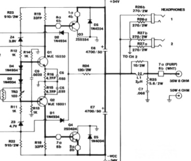

but, Polypropylene caps are high volume low cost capacitors.
