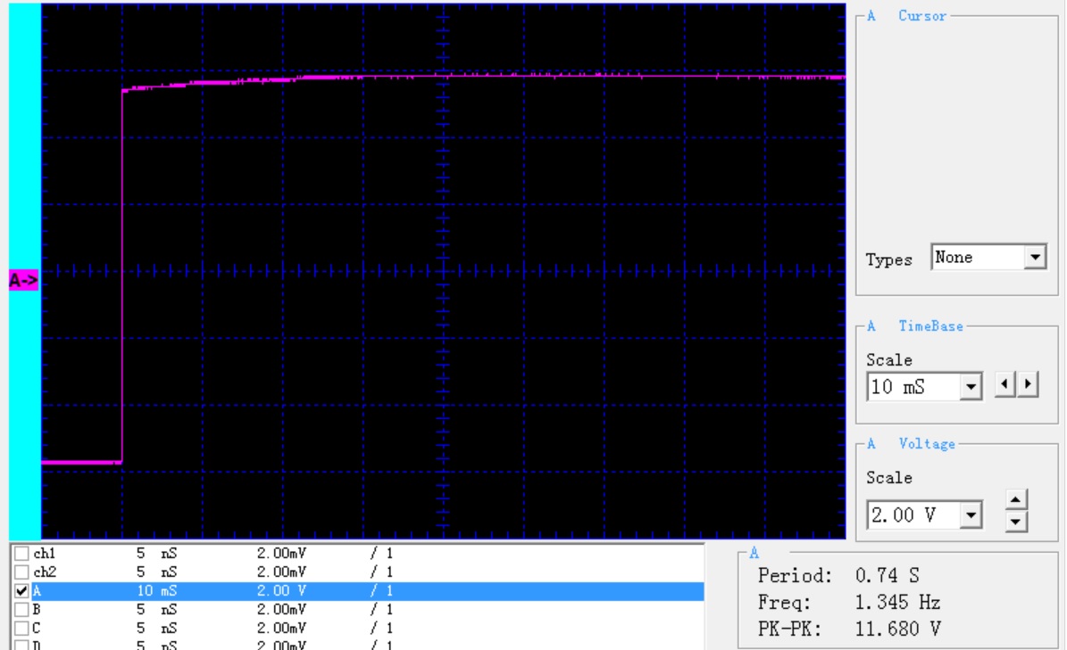

I finally had time to post some pretty pictures.
First is the classic step function. Not quite perfect but close enough. This is essentially the signal you get when you close a switch to a power supply.

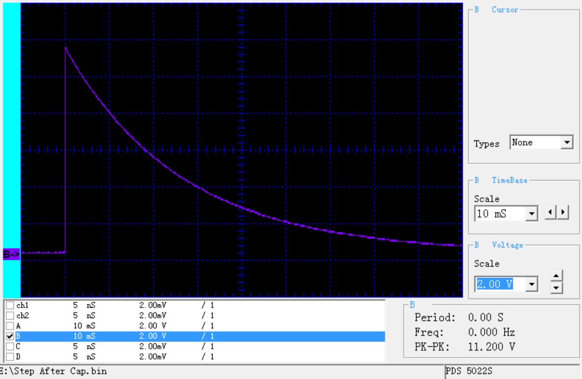

Next is the output across a 10,000 ohm resistor when the step function is passed through a capacitor with 5% "D" according to my bridge. Some folks seem to confuse this with linear algebra's definition of linearity, but clearly the graph is not a straight line.

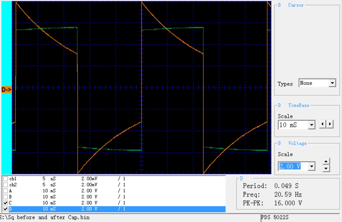

Third is a classic 20 hertz square wave image (Not perfect) and the square wave passed through the capacitor of 2.2 uF. Note that due to phase shift the apparent amplitude has increased by what looks like enough the perception may be the tone is louder. This is due to the phase shift that may also present itself in addition to the increase in amplitude.

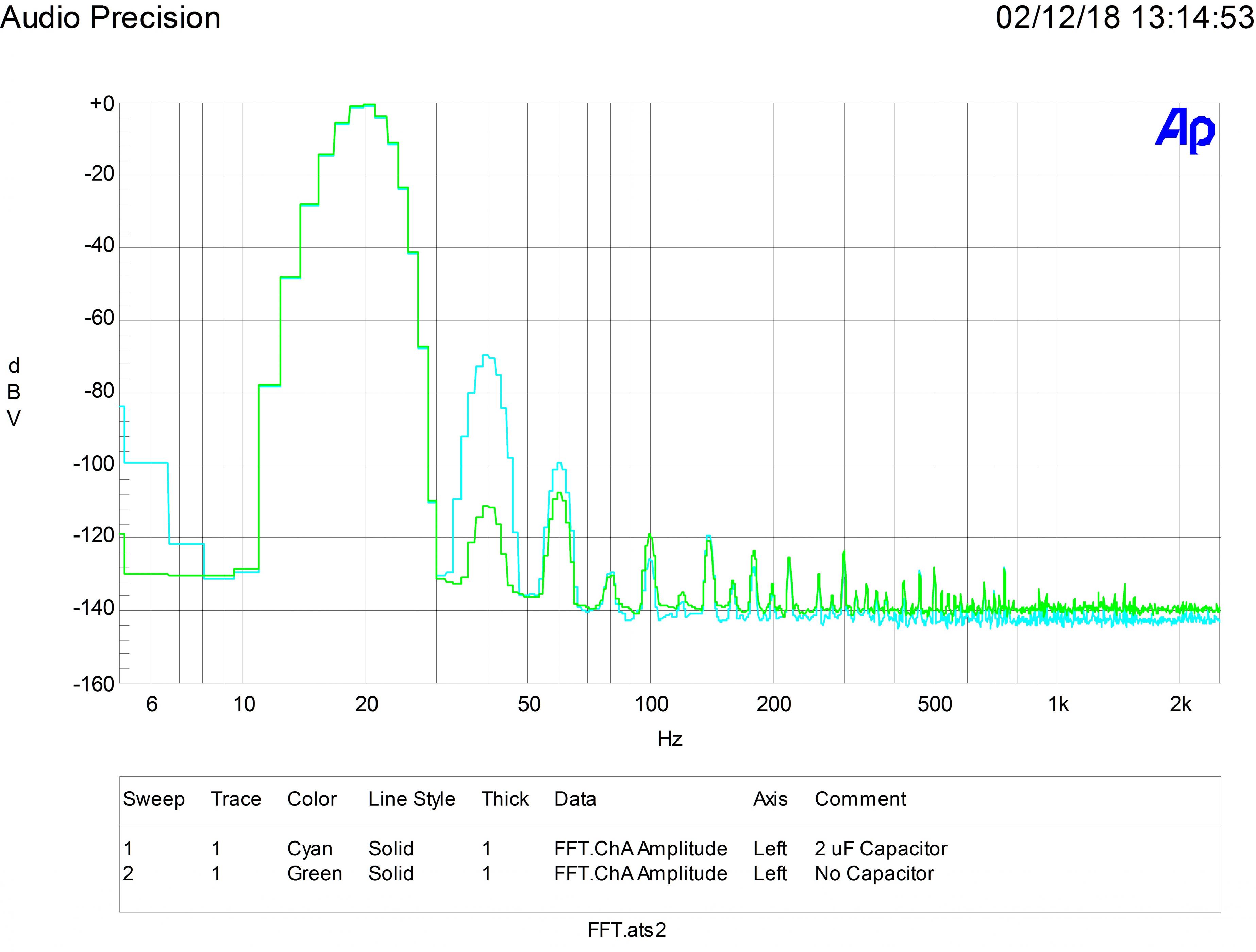

Fourth is an FFT of the 20 hertz sine wave passed through the higher DA capacitor compared to a better one built intp the AP unit. A quite dramatic increase in the harmonic distortion.

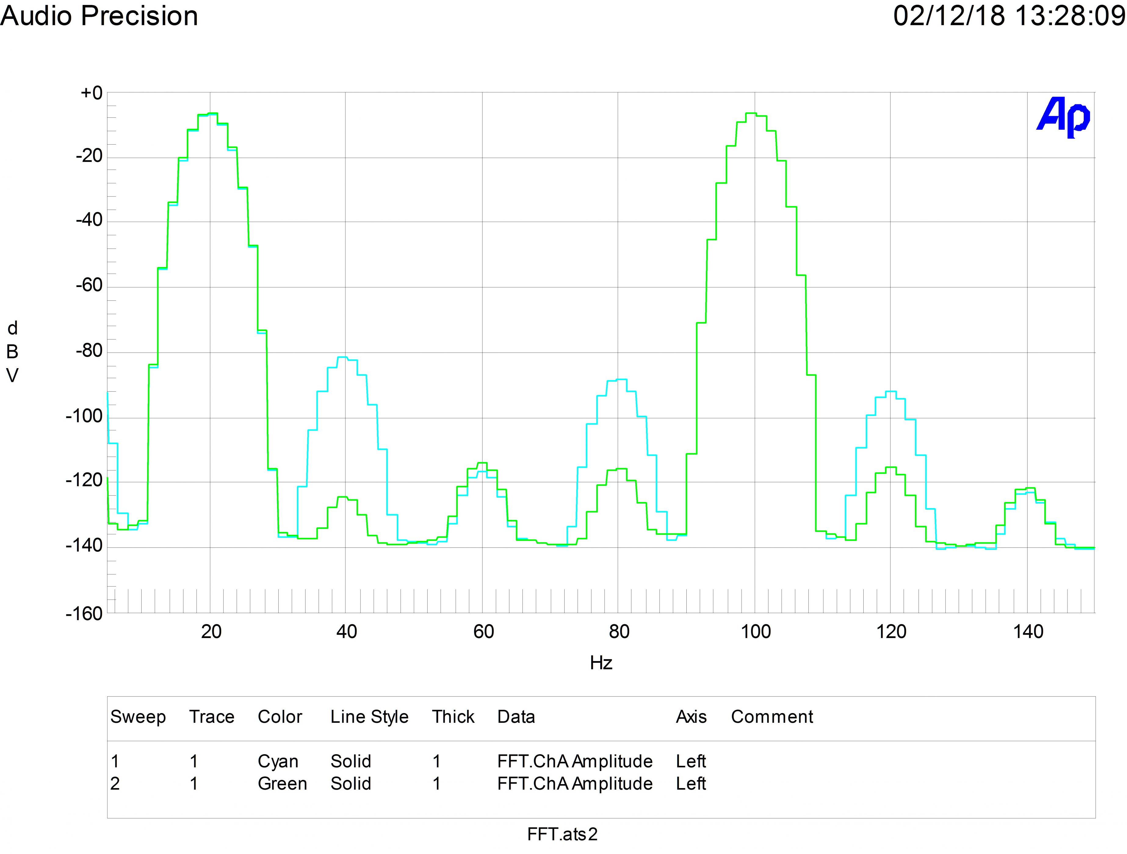

Finally is the IM distortion caused in both the good capacitor and the high DA one. Note there are always side bands due to the heterodyne caused by the nonlinear capacitor VI curve. Much worse with the high DA capacitor.
Naturally the curves are real as demonstrated by the 60 hertz incursions.
