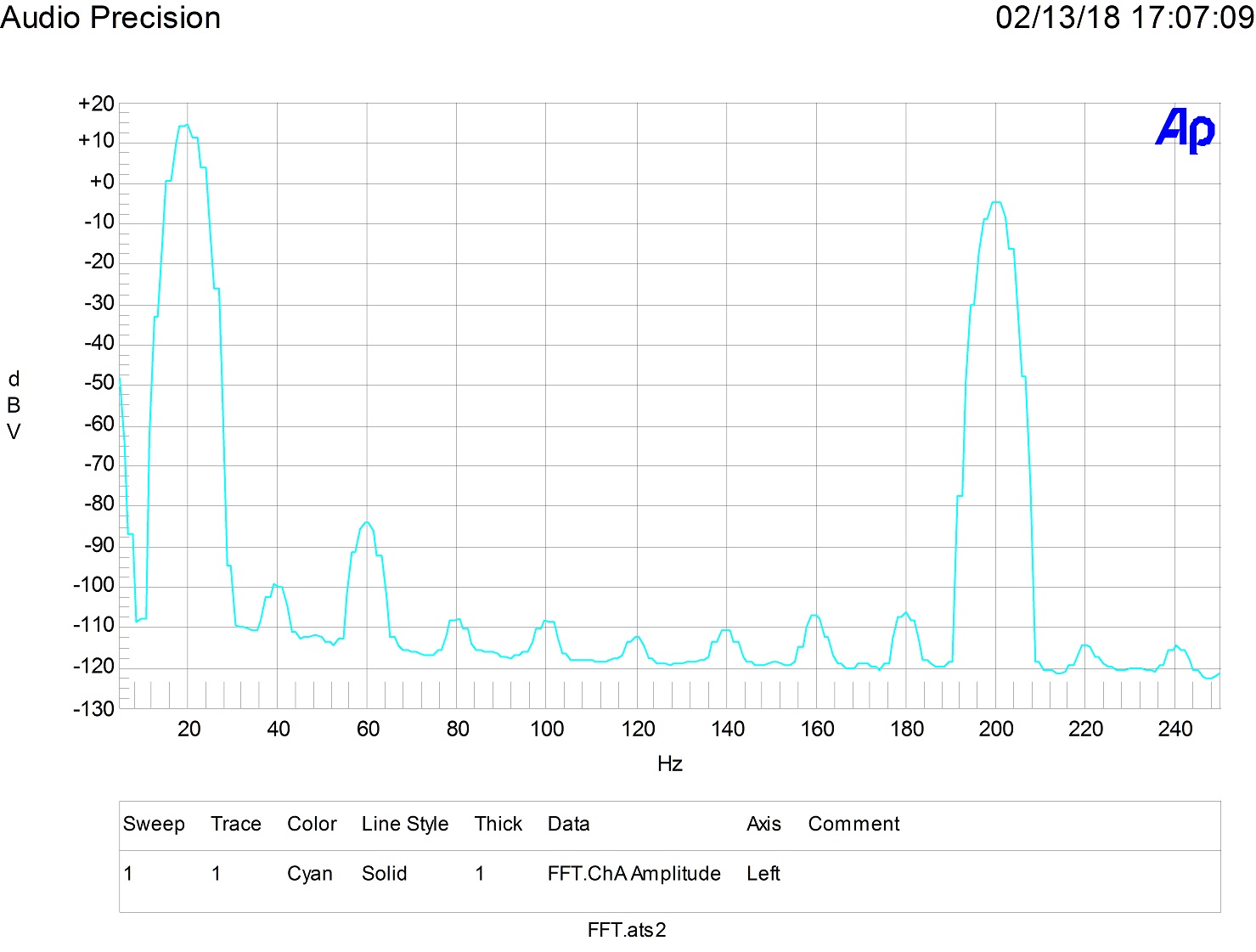

More fun. A 1.8 uF 160 VAC 250VDC Bennic brand metalized polypropylene capacitor into a 10,000 ohm 1% metal film 1/4 watt resistor. 5 volts RMS at 20 hertz and .5 volts RMS at 200 hertz. DC coupling out of the AP. Nicely shows the harmonic and intermodulation distortion. I will run the test again tomorrow to be sure it holds up.
More fun. Nicely shows the harmonic and intermodulation distortion. I will run the test again tomorrow to be sure it holds up.
Nicely, really? Since the 60Hz can't be differentiated from hum no claims to its origin can be made and since 20 and 200 are exactly divisible there is no definitive proof of IM here either. You do love confounders don't you? Besides if the 60Hz is hum everything is -115dB or better not exciting.
EDIT - That's an 8.8Hz corner so there is considerable AC voltage on the cap and the fundamental magnitude is off on the plot.
