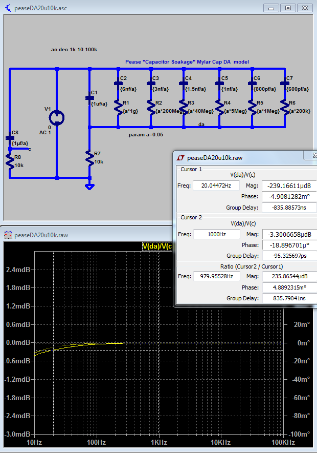

so you hear < 1 us, 250 udB @ 20 Hz?
20 uF, 10k Mylar coupling C with Pease DA model extra RC branches, scaled
trace is Pease' DA modeled Coupling Cap vs Spice C
cursor inset for delta dB, phase, group delay
  • peaseDA20u10k.asc
    peaseDA20u10k.asc
