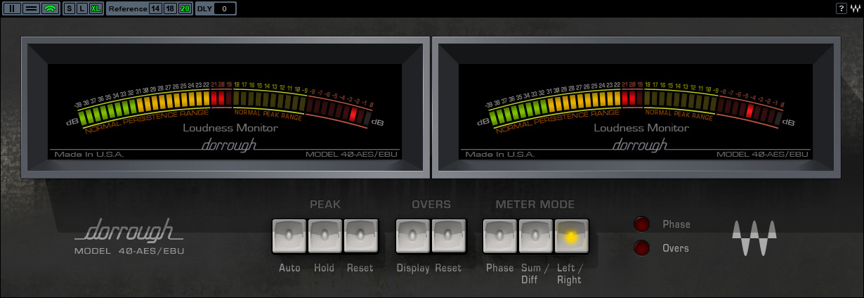

What was used commonly for peak/ RMS metering for the past 25 years is the Dorroughs 40A and it’s software equivalent. The later versions recorded the number of overs. Calibration pots allowed it to be set for whatever Average and peak levels you needed.
The You Tube link shows the simultaneous display of Peak and RMS values of the signal. EBay has weekly listings for the original hardware version ( usually needing recapping).
YouTube
Waves and Premiere have even more advanced long term averaging displays
Brainworks BX meter goes even farther and more sophisticated
