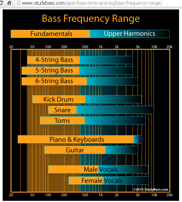

IMHO of course ---- the main reason music from high hi speakers don't sound like real instruments being played in the room and never will is that the speaker dispersion pattern doesn't match any musical instruments' Each instrument has a radiated pattern... drum, violin, horn, etc... all produce different acoustic radiated into the room patterns. The speaker has one fixed radiated pattern for all instruments.
