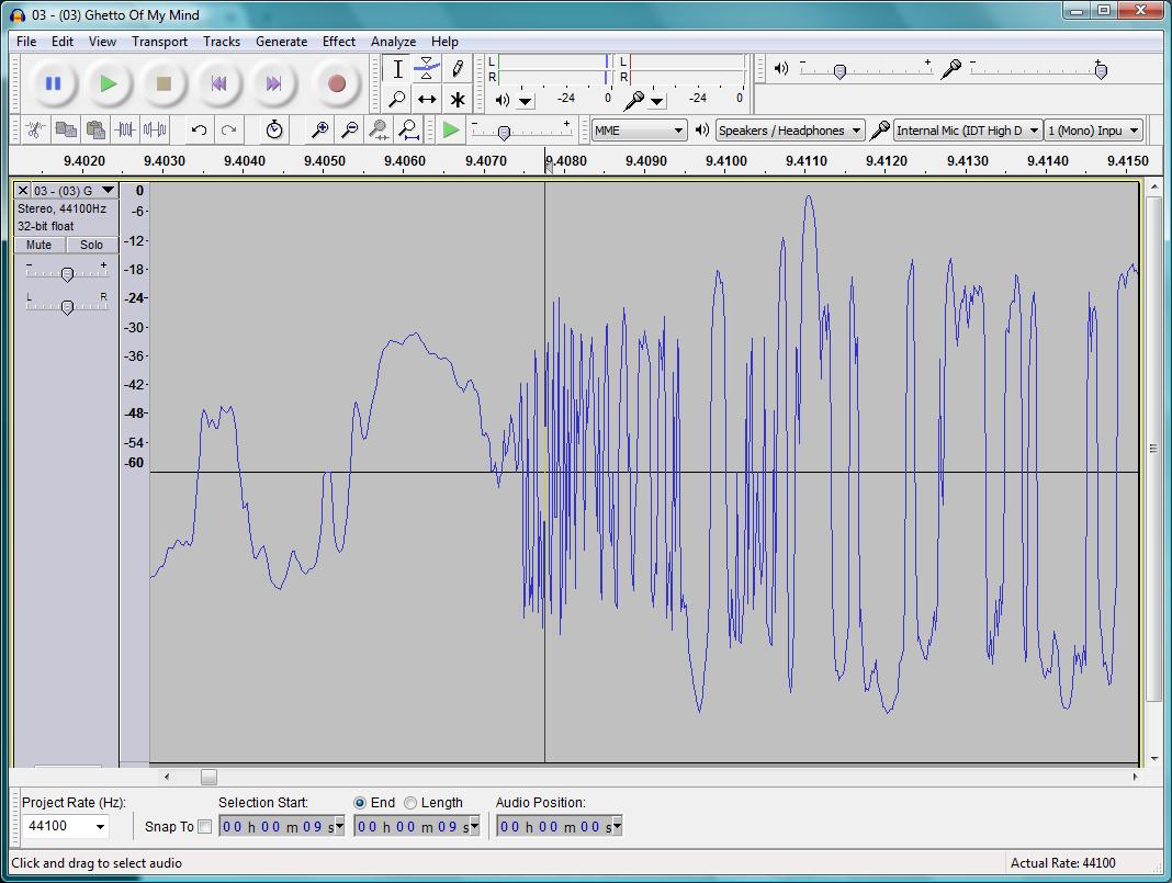

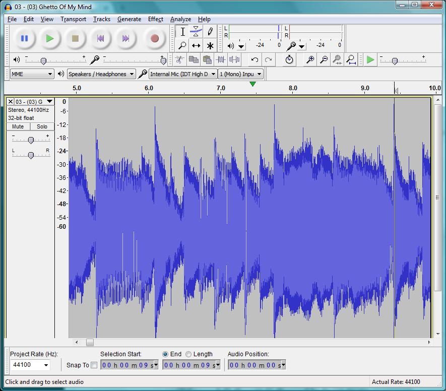

Back onto Rickie Lee and the track 'Ghetto of My mind' which has the highest DR* number:
DR22 0.00 dB -24.72 dB 6:16 03-Ghetto Of My Mind
Now I don't have any sharp tools in the box for analysing this, but here is what the blunt ones show. Attached are a couple of shots from Audacity, just with varying zoom. As you can see the percussive hits go waay above the rest of the program level. What I can't tell with a mk1 eyeball and the version of audacity on the PC I'm using won't calculate is if there is anything abnormal about the crest factor. Percussive sounds generally of course have a high crest factor, but I am intrigued as to how high.
The other interesting bit is that there does seem to be a significant degree of asymmetry in the percussion. So for those who can cope with the genre it's a possible for testing if you are sensitive to phase.
I would be interested in any comments from those versed in the art as this seems unusually uncompressed for a popular CD and an indication of what was thrown out in the last 10 years or so (this CD was 1989 and DDD).
* Assuming for now that DR is just two random letters assigning a measure of 'goodness' rather than having a meaning translatable to something else 🙂.
