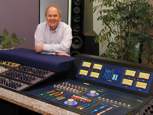

Bob Ludwig for one!Anyway, who is using Vu meters nowadays ?
Don't you see the crest meters in the center ?Bob Ludwig for one!
And the big yellow VU meters around the outside. You asked a question, I answered. Had you asked 'Who only uses VU meters and nothing else' I wouldn't have said anything.

Because we were talking about monitoring signal to avoid digital clipping .And the big yellow VU meters around the outside. You asked a question, I answered. Had you asked 'Who only uses VU meters and nothing else' I wouldn't have said anything.
Not about the various instruments you can use to show average, minimal, max, peak etc.. levels to get visual ideas about dynamic.
Looking for controversy?
It is like your question about this -18dB VF dBFs.
No, just poking a pin into inflated pomposity. YOU were not following the twists and turns of the thread, and you asked a non-specific question. You got an answer which you didn't like so you are trying to twist words around. Meh.
