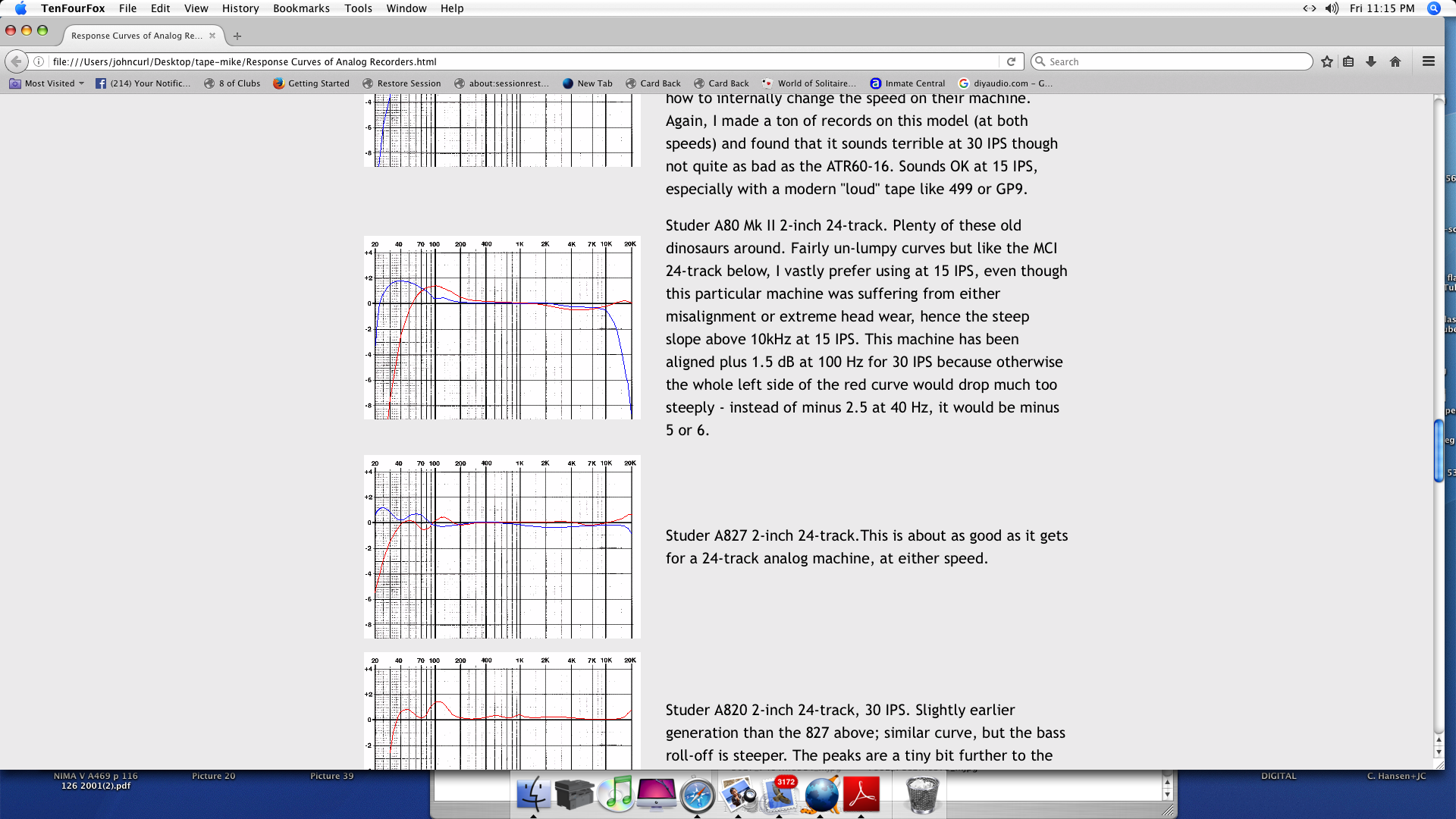

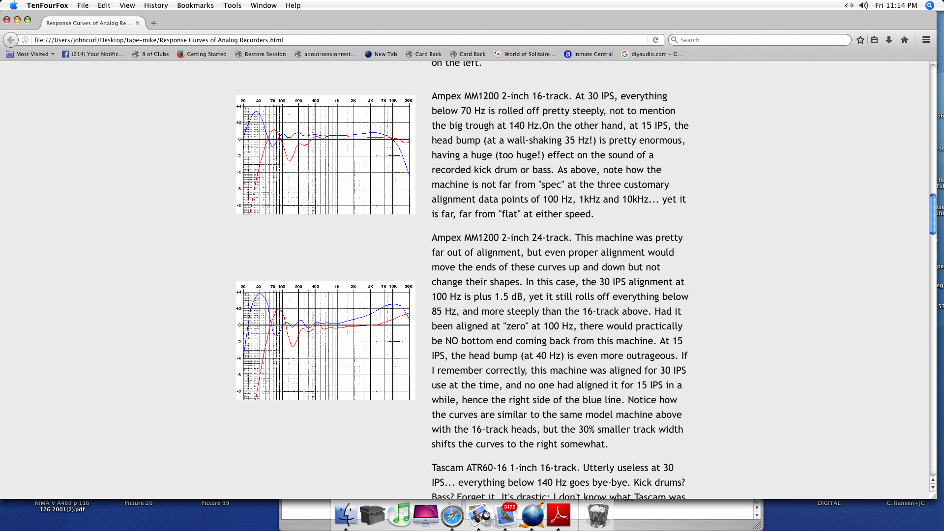

While I find Jack Endio's web page useful to illustrate the differences and general shape of low freq head bumps, I have found that many of his graphs do not match what I have measured in my work. The Otari MTR90 responses vastly overstate any head bump that I have ever measured, while they tend to have more bump than many others, they are never that exaggerated.
Response Curves of Analog Recorders
Your eq comp does give better 30 ips play than most, excluding certain John Stephens 821B's, which I have measured as flatter than what you present and extending to 24 hz at 30ips. Note that this is not true for all 821B's as he kept changing the circuitry and you can't know just by model number what you are looking at with a Stephens.
Those graphs are useful for comparative purposes, they are not to my opinion and experience accurate.
Cheers
Alan
