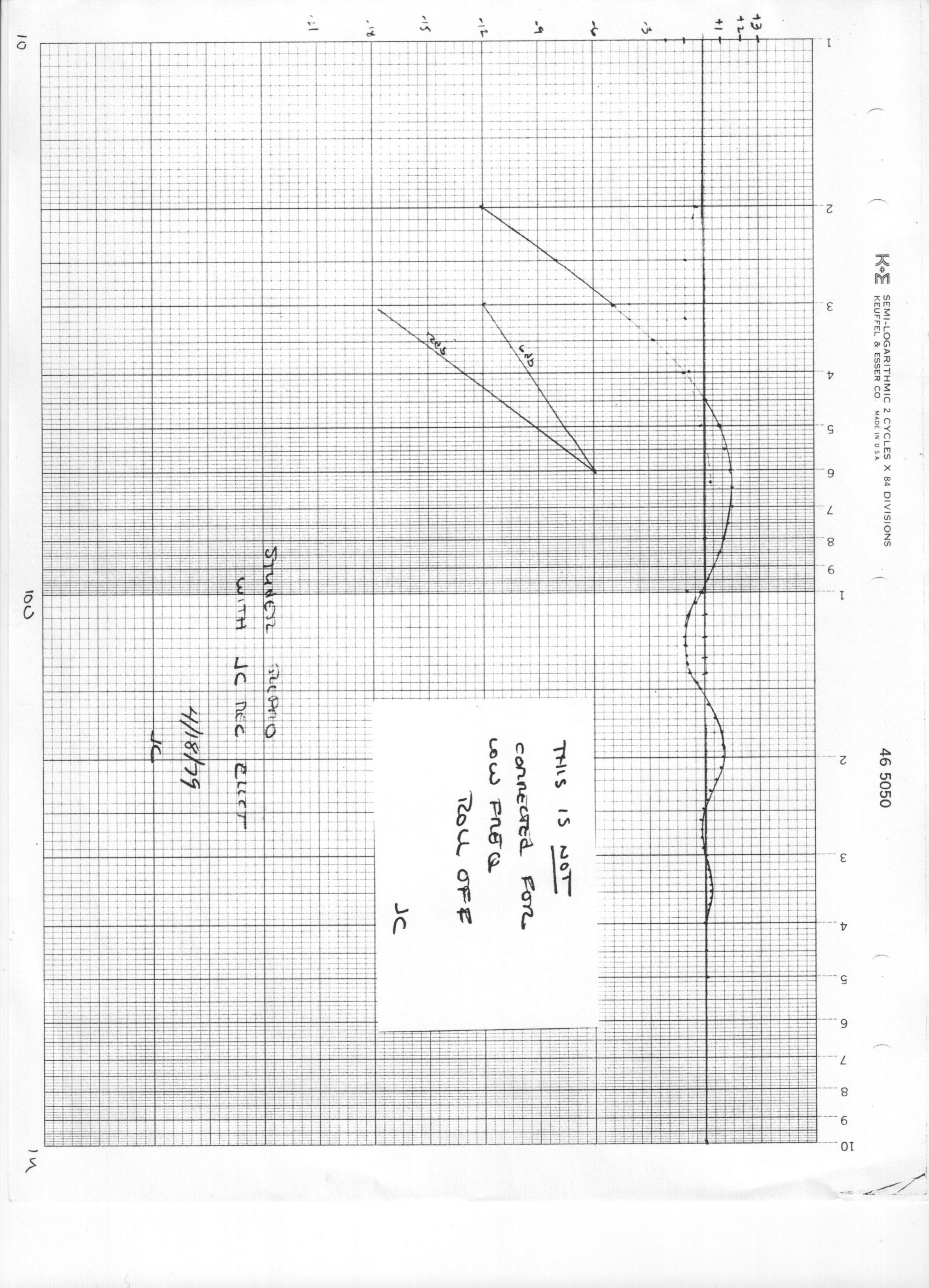

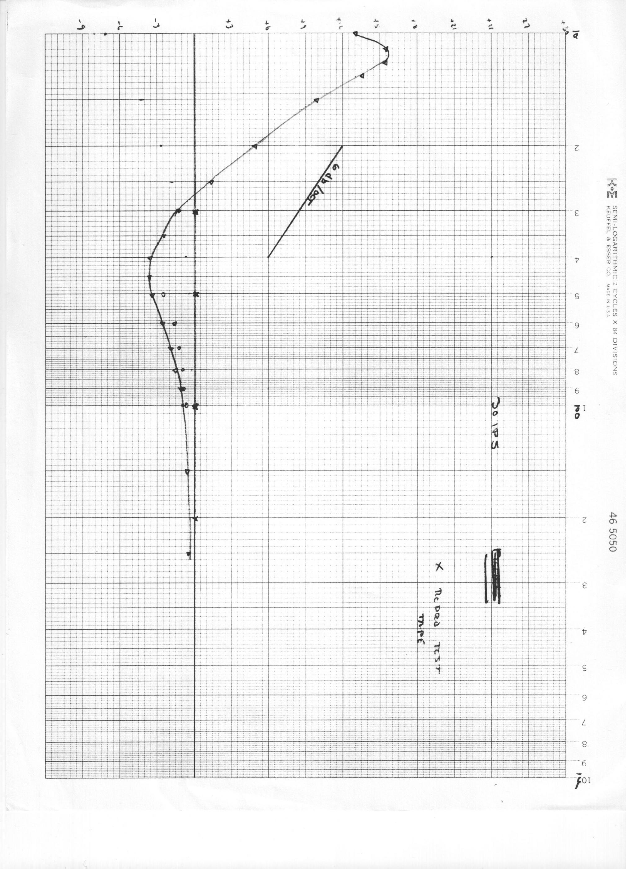

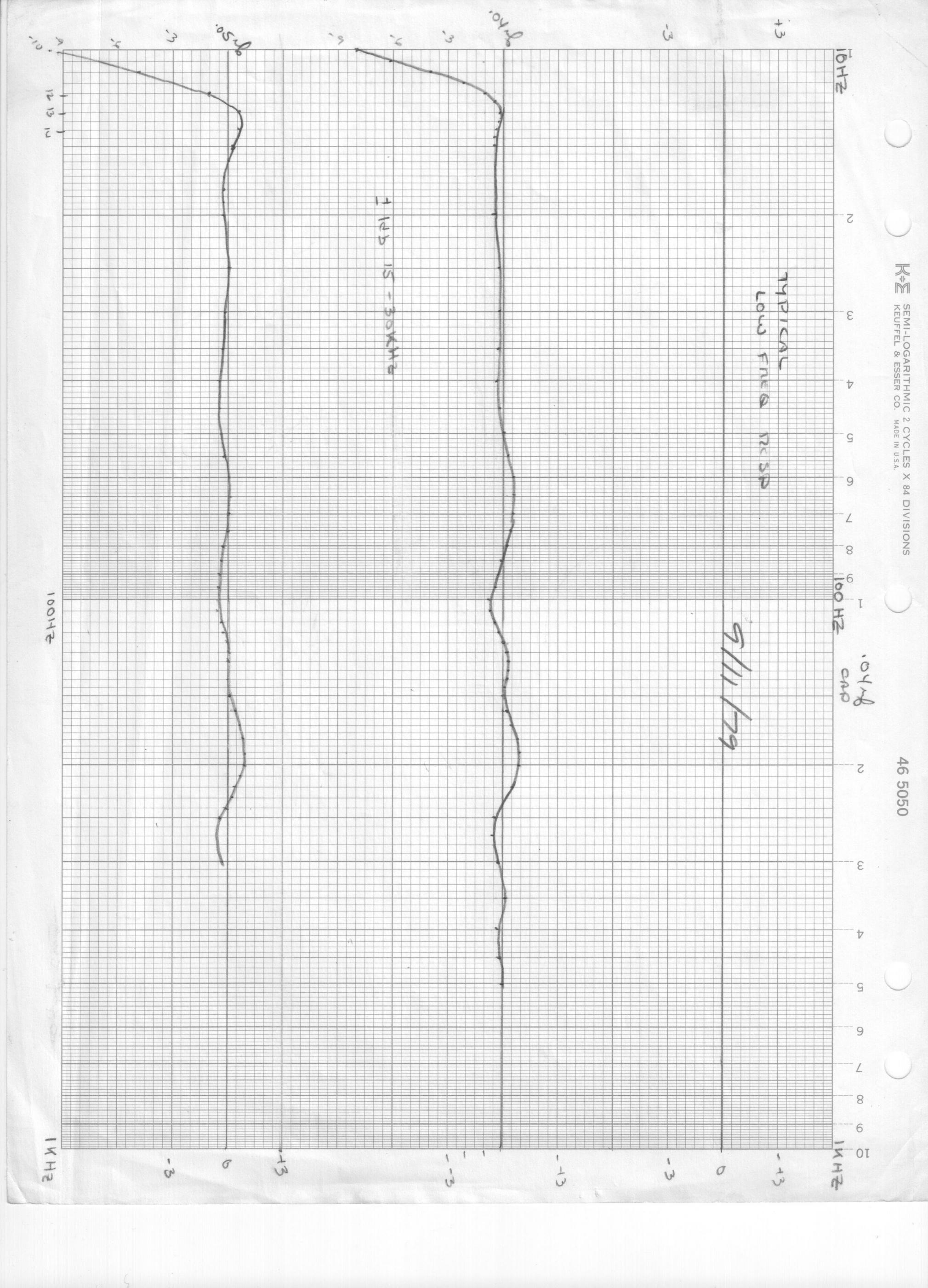

Anatech, let's discuss this further:
There is a paper written by J. McKnight when he was at Ampex in the '60's regarding the 'optimum' capacitance, resistance combination for flattening the reproduce response for essentially lower speeds of analog tape, but there is more to the problem than initially meets the eye.
In 1968, I was assigned to test the reproduce head response with a new transformer and the standard heads at the time with the AG-440 analog tape recorder. What I found with a GR Q-Meter was that the the head-transformer combination had a Q of about 1 at 20KHz or so. Kind of low, wouldn't you think, so since I was also delegated to start on the next generation of electronics, I decided to find out why the Q was so low.
I found that the transformer-head combination, with its approximately 6mil lamination stack had very high eddy current losses that made the head-tranformer combination rise at 5 1/2 dB/octave, rather than the ideal 6 dB/octave, and that the resonance did help to partially make up for this loss. Of course, there was the scanning loss (almost nothing at 30ips) and the air space loss between the head and the tape that could be a factor, BUT it was the 6 mil laminations that did the bulk of the damage even in the upper midrange. Changing to 2mil laminations fixed the problem for the most part.
Now what is the origin of the I-V input, at least for me?
It so happens that Ampex had made a true master recorder from tubes in the early sixties that used I-V input called the MR-70, and it completely suppressed a rather low head-transformer resonance of 5KHz or less and yet had extended bandwidth at 15-30 ips. It was known to be a better tape recorder than the AG(Audio General)-440 and so I used its approach in my later solid state playback circuitry. It just so happens that the Studer A-80 VU MK 1 used I to V as well, but they changed it with the MK 2, for some reason. Still, 40KHz playback without head resonance is possible and practical at 30ips, as I have done it with 4 separate mastering recorders so far.
...And, at 30ips, you introduce another problem, the resonance in the low frequencies that enters in an critical part of the spectrum. (~30 -> ~60 Hz ?)Still, 40KHz playback without head resonance is possible and practical at 30ips, as I have done it with 4 separate mastering recorders so far.

Hi John,
Thanks for the information. I do know that Studer eq'd the head bumps out on their product line. Others, like Tascam, concentrated on 15 ips (wise choice for them) and just left the head bumps in place and didn't talk about them. Their machines sounded pretty good, but there is just something about a Studer that wins the day.
I have worked on an old Ampex machine, and some Scullys and helped on one MCI machine. Of all the tape machines I have seen, nothing was more gentle on the tape than the Studer products. For the money, Tascam had a very good product as long as it was properly set up (tape path needed shims everywhere). I'm not going to mention the Fostex or Tascam's answer to the Fostex machine (MRS-16 ? ).
Almost every machine I have ever worked with needed those capacitors to resonate with the head. With the Ampex having a "Q" of 1, that is on the border of too high. Would resonating it with a capacitor allow the response closer to 0.7 by chance? Was it a question of "close enough for rock 'n roll"?
I understand what was going on with those Ampec machines now.
-Chris
-Chris
