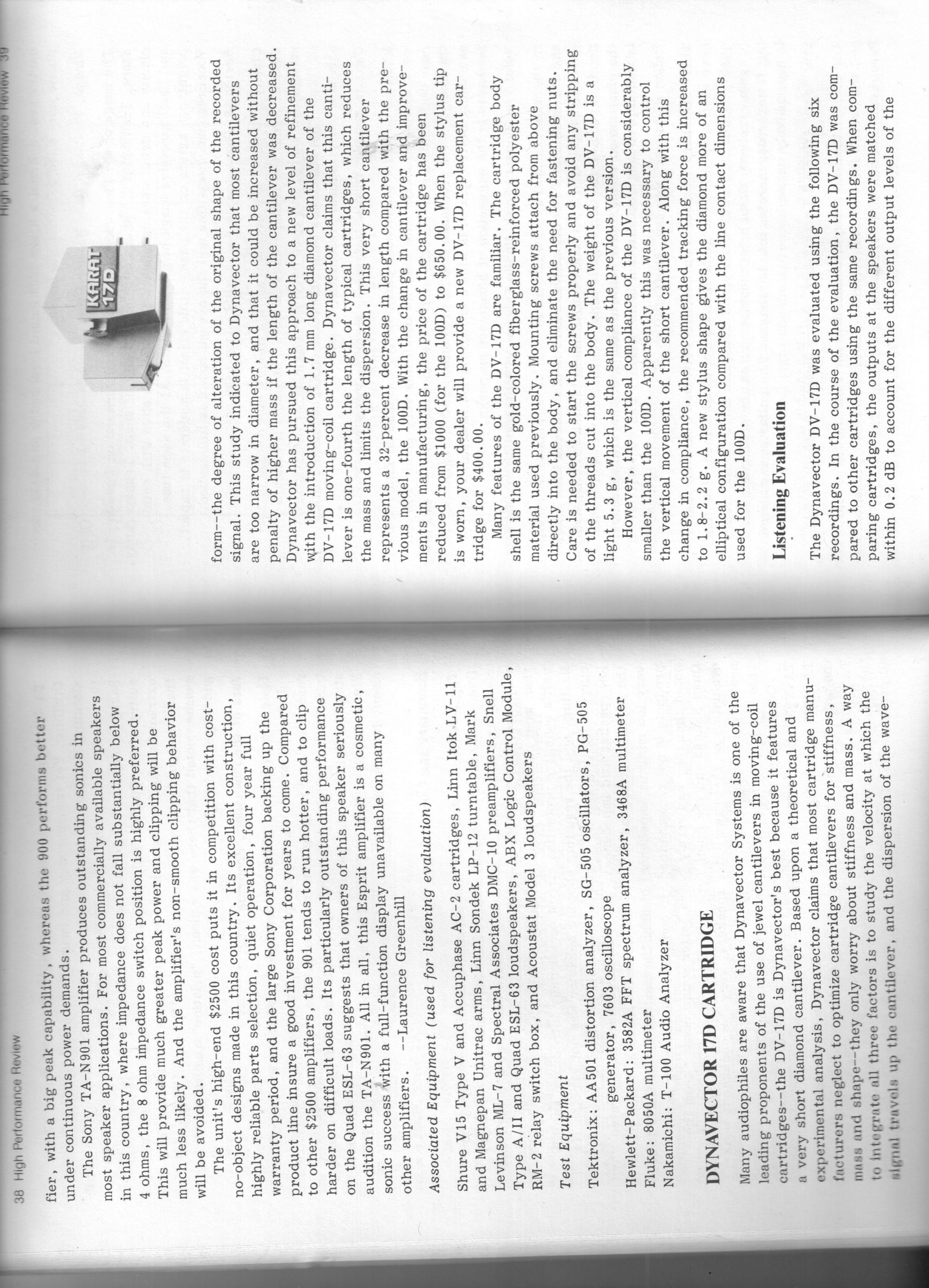

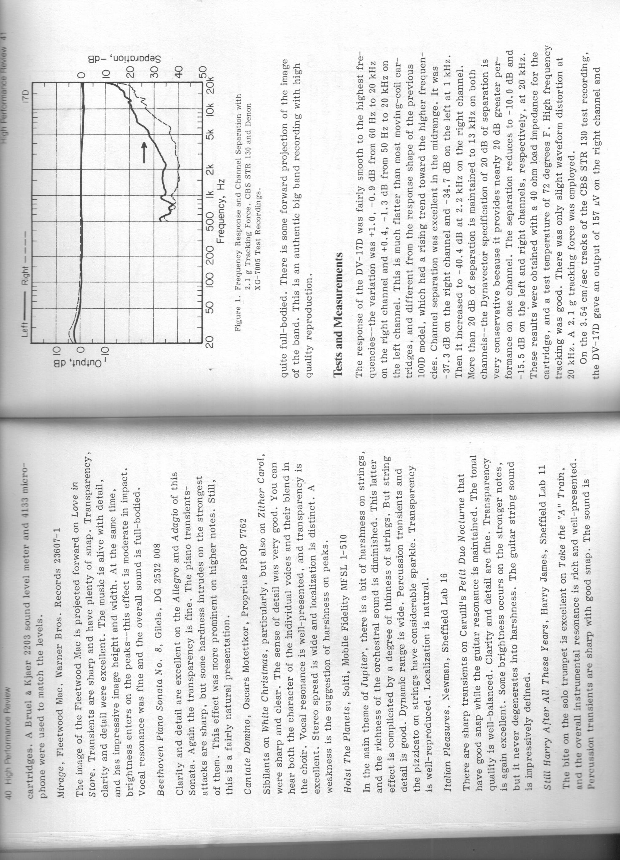

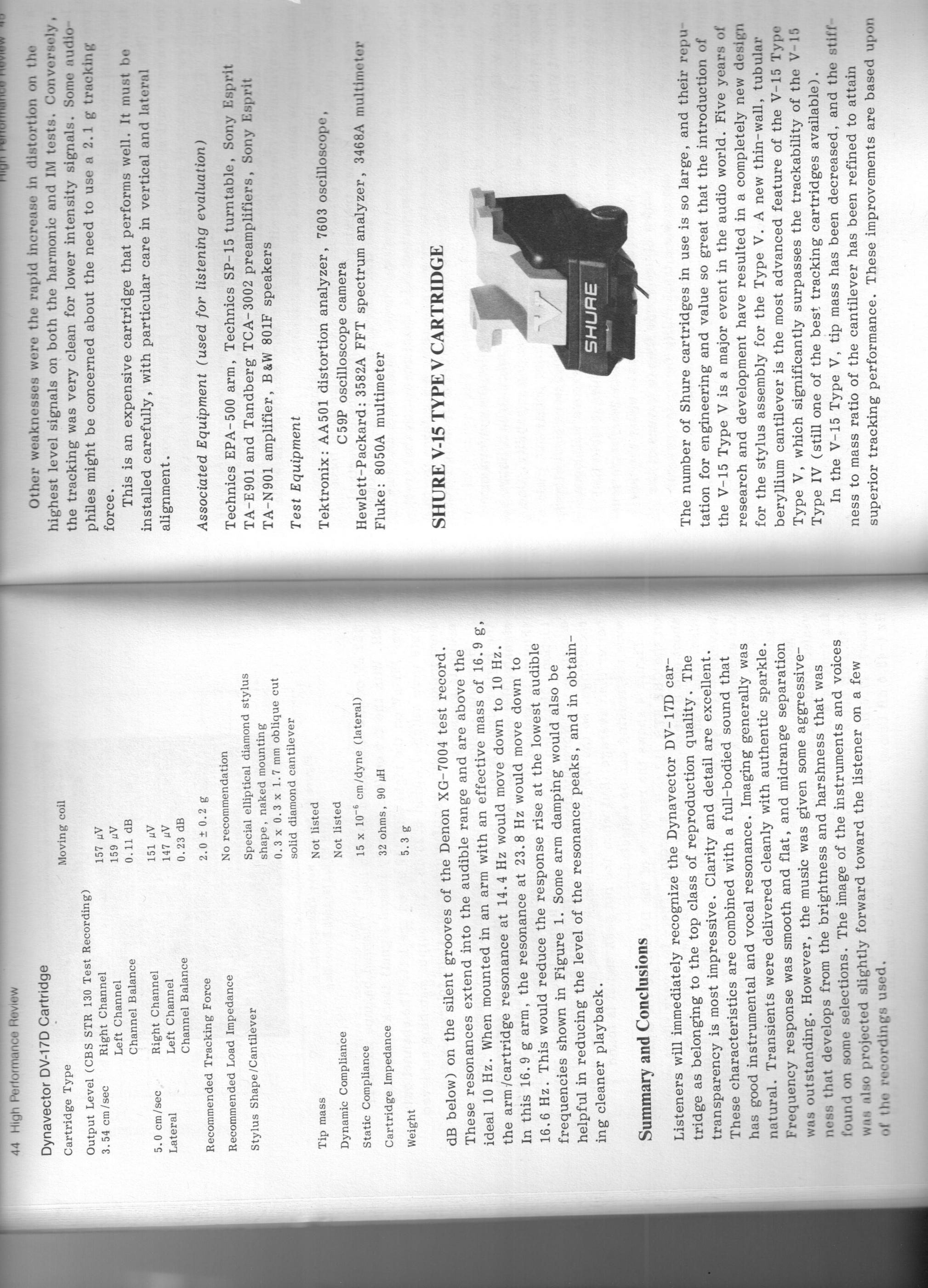

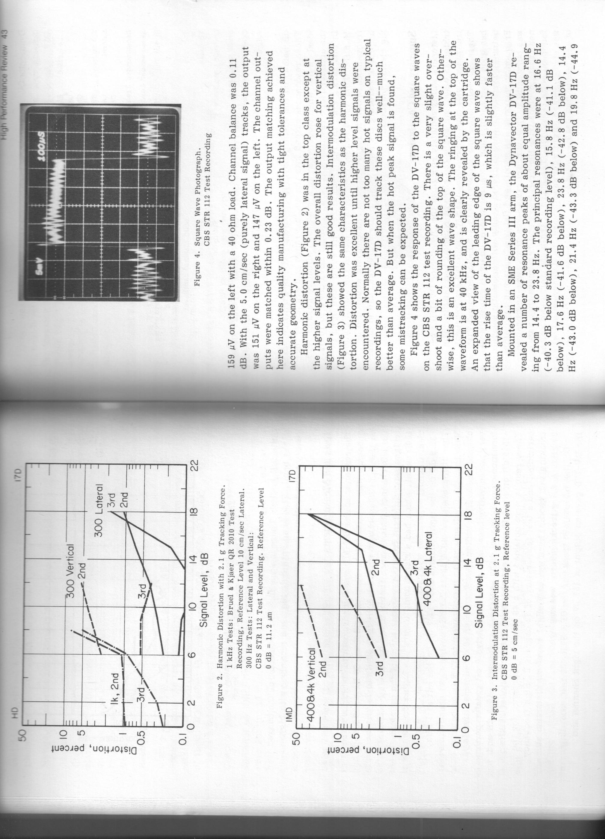

In real measurement, the Dynavector is an excellent MC cartridge. However, read between the lines everyone, in this review. Note terms such as brightness, hardness, harshness, thinness, etc in the listening evaluation. This was my overall impression of this cartridge when I once listened to it. However, it is an ACCURATE cartridge, with accurate frequency response, 40KHz resonance, 9us rise-time, etc.
My preference is for a more 'romantic' sounding cartridge, but I suspect the frequency response would be essentially the same from my Lyra cartridge. Anyone out there have some independent measurements of Lyra cartridges?

Thanks for the review John. I have one somewhere, but finding it would be a major effort. I accept that many listeners do not like a cartridge that is ruthlessly revealing of a recording. The Dynavector does this. In spades. Like all things, however, GIGO applies. Put a first rate recording under the 17D (assuming you are using a suitable arm, of course, like the DV507) and the result is stunning in it's realism.
