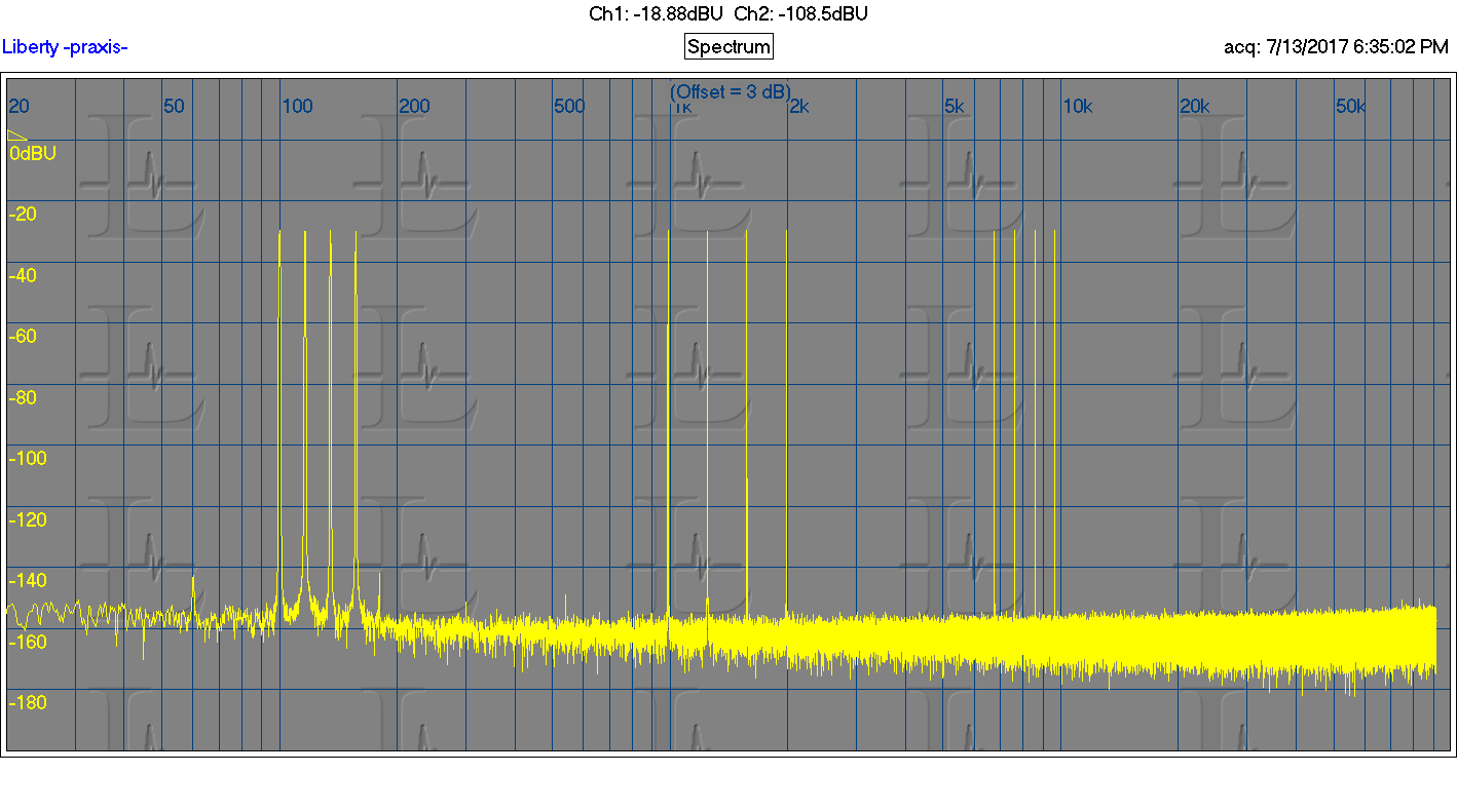

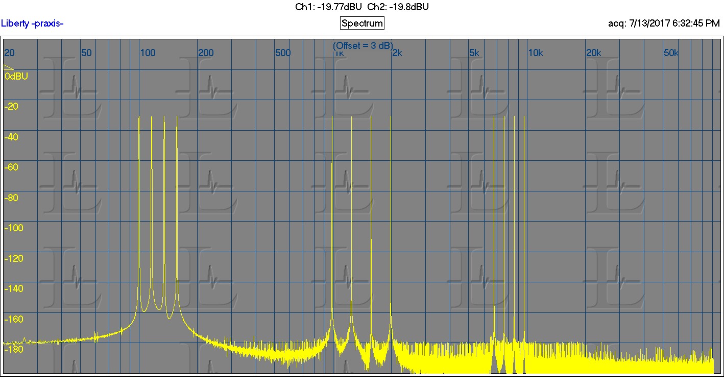

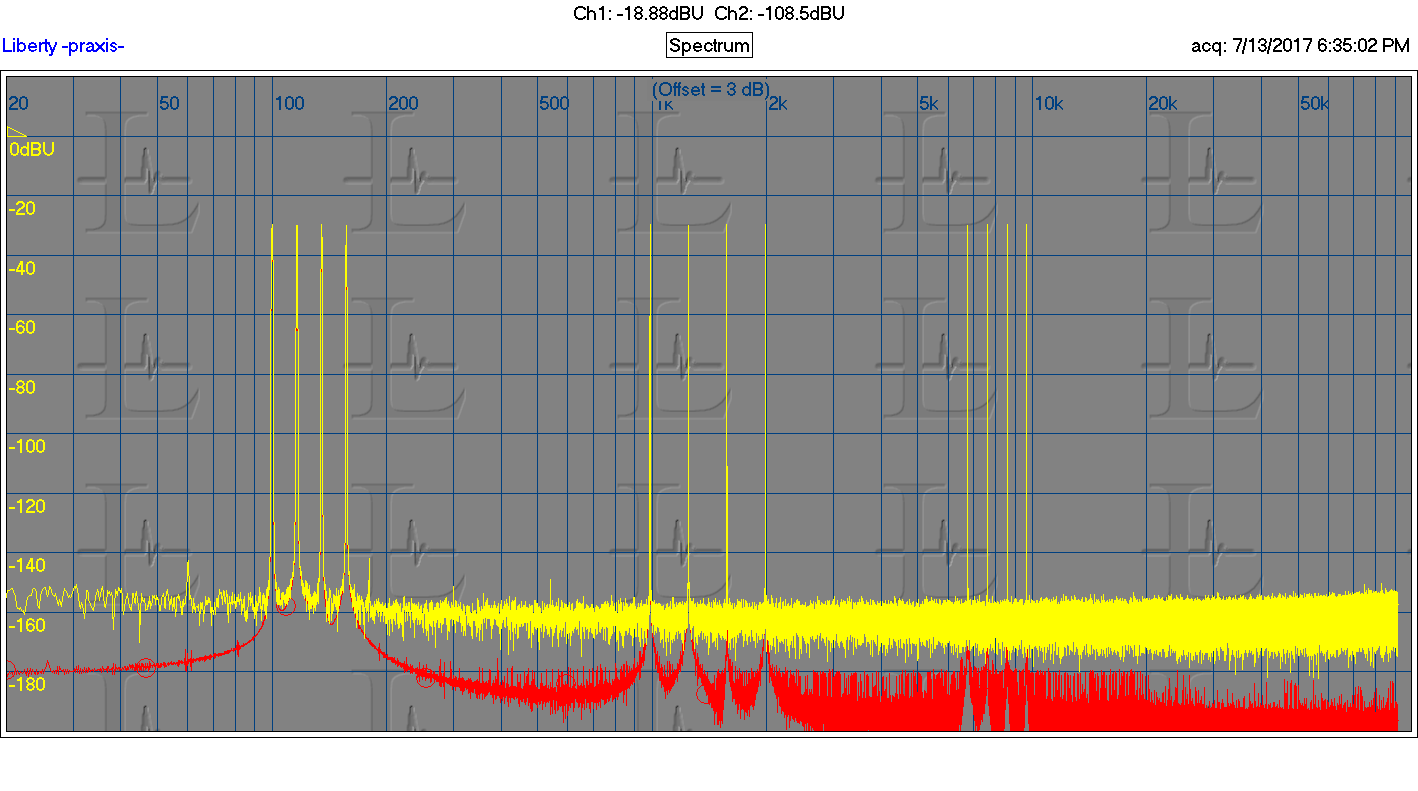

Here you go. Three band set of spectral contamination tones. The tones are selected to have both IM products and harmonic products not land on other tones. New IM Test Signals
First picture- composite of digital and analog overlaid. Second is digital loopback (essentially best possible in perfect world with 24bit 192KHz sample rate and 1M point FFT.) Third is analog loopback through an RTX6001. The noise floor is the limitation. It seems pretty free of any IM products or artifacts.
I can provide a digital file if someone has a place to upload it to. I use this with speakers. You see both response issues and distortion products. The noise floor is nowhere near that low with acoustic measurements.
(Kudo's to Jens on his RTX6001. Its really good and would probably make for a really good DAC. DIY Audio Analyzer with AK5397/AK5394A and AK4490 )

can you make it for 30 to 60 tones?? and bundle it as a PNP package. zero operating learning curve.
THx-Richard
I'm not sure I could find enough prime numbers or whatever it took. More tones won't give more information just a higher crest factor. Its difficult to find tones that when interacting they don't land on each other. Its the second and third order IM products that are challenging.
For PNP I can supply a FLAC file. The rest is on you. Or for around $8K I can supply the software (ARTA most likely) the RTX6001 and an Earthworks mike and preamp. I think there is enough left over for it to be worthwhile for me.

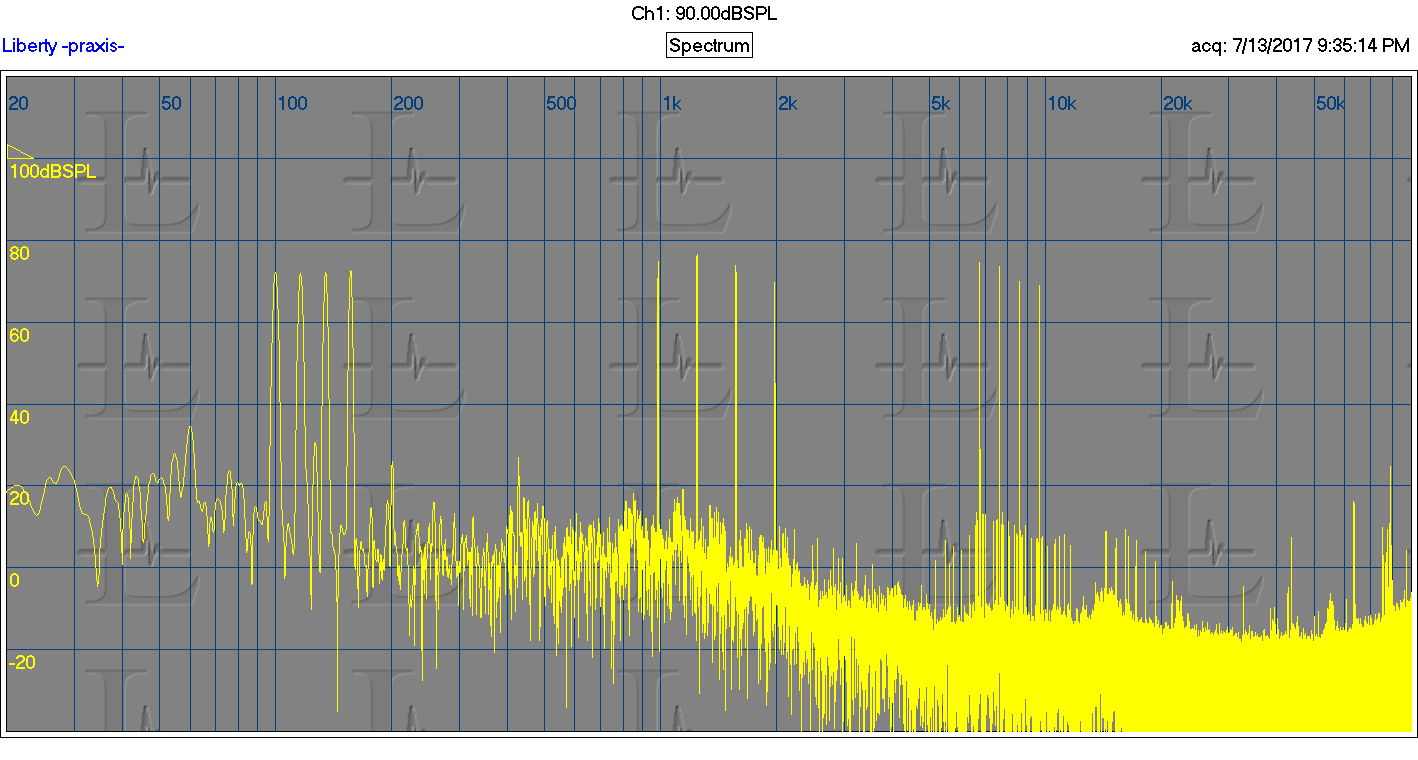

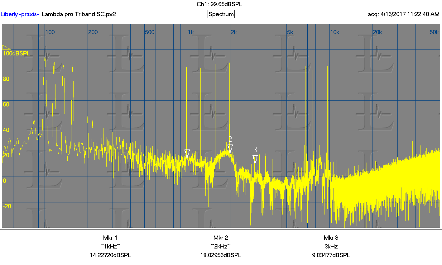

Here are two electrostatic headphone tested with the triband spectral contamination signal. You can see some of the associated IM products around 60 dB below the signals. I think that's pretty decent performance for an acoustic transducer. The Stax Lambda pro was tested at 100 dB SPL (really loud) the other, a prototype sample was at 90 dB SPL. You can see the "doppler" distortion sidebands around the HF tones. I'm not sure you can generate 95 dB SPL without modulating HF riding on it on a moving diaphragm.

yes acousic transducers really are the only place for these
high number multitones, where they have much use
merely decent electronics by even just THD frequency and level sweeps, conventional IMD have to be purpose designed to have 'new behavior' with high number multitone tests
