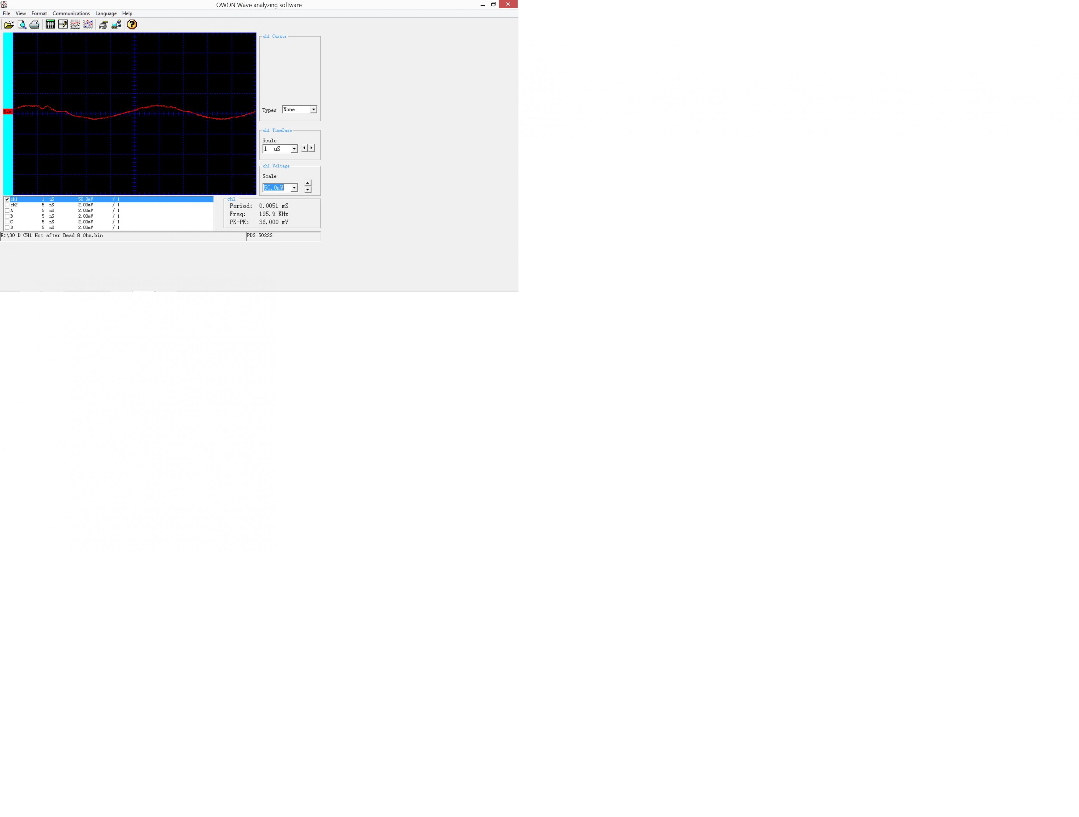

This is the HF noise from the amplifier before and after a simple ferrite bead filter.
Third image is the amplifier feeding audio to an 8 Ohm resistor through 1000' of cable.
Actually hard to measure as the other channels spray a lot of noise.
Now all I have to do is wind another 62 beads.
