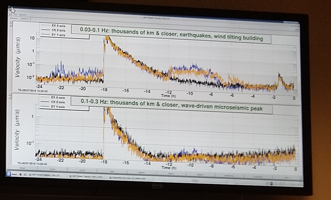

Talk about confounders, while at LIGO we were lucky enough to see the effects of the 7.7 magnitude earthquake that took place Friday deep in the Marianas Trench. The upper display is in micro-meters per second rms in a .03 to .1Hz BW on a log scale so for a decaying exponential of the earth ringing down from the "impulse" excitation you get a roughly linear decay as seen. The noise floor before was better than 10nm per sec. at deep sub-Hz, pretty amazing. I was told the blue and orange plots were the important ones and that the noise after the earthquake was a local dust storm.
I got the impression this display was sort of just for show like an indoor/outdoor thermometer plotting temperature and generated real time from raw data.
I think jn would appreciate the fact that just before we arrived someone plugged the safety shutter input into the wrong jack. The laser cavities are pumped up to as much as 500kW and are tuned to a DEEP null at the detector and even a slight loss of phase lock activates a shutter to protect the optics at the detector, needless to say the alarm was ignored and the magic smoke got out. The upside was we got a better tour because everything was shut down.
