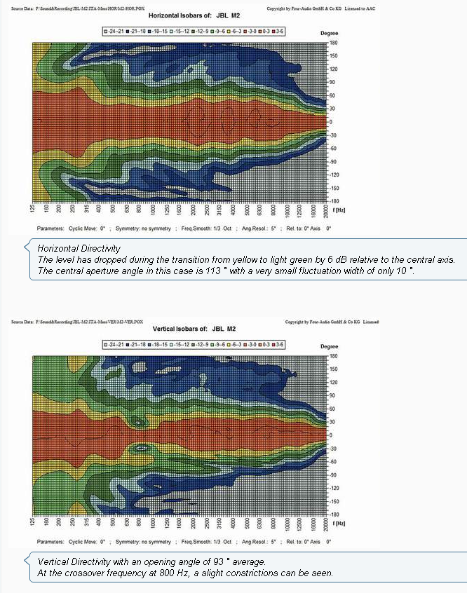

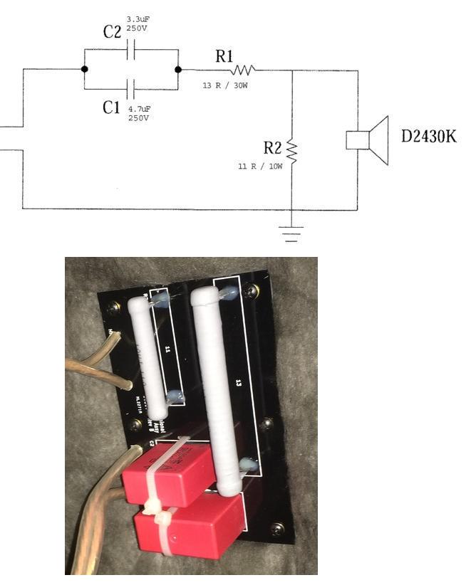

Did I see 20 dB of HF boost in the DSP curve for the JBL? That can play havoc with the dynamic range of the DSP and associated amp.
There is a –6.6dB at the input of the DSP ( input overload margin) and a –1.8 dB at the High channel Out.
It seems they are relying on the architecture of the DSP chip theu use.
e.g. the ADAU1701 of the old MiniDSP can take 24dB of combined DSP equalization boost on any particular frequency with no overload (I’ve tested it with single frequency sweep).
Not to mention the voice coil of the tweeter.
There is a passive x-over/L-Pad btn power amp out and compression driver coils. Some 9dB in-band attenuation with this (plus the impedance resonance peak taming).
And the horn has an acoustic peak at 3 KHz, something that really pushes the perceived "clarity" a lot. Its eq'ed in the frequency domain but I would like to see a waterfall plot and off axis to see if its uniform and doesn't have any "hangover".
Do there two plots satisfy you? (I’ll ask my commission from JBL)
JBL Master Reference Monitor - Page 74
Testbericht - JBL M2 - Master Reference Monitor - Monitor für große Studios und Abhörräume / SOUND & RECORDING Ausgabe 12/2014
