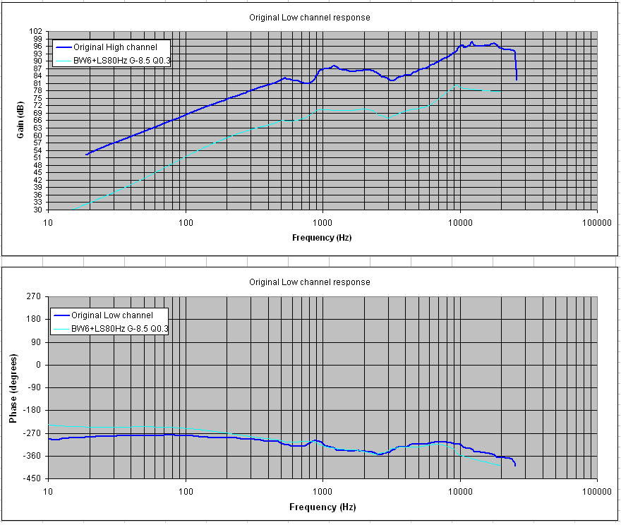

You are welcome.
Fifteen EQ. Filters most probably can (>edit: could) do this.
A 2x4MiniDSP HD with it’s 20 EQ. Filter bank per channel can do it.
This is what is achievable using the old 2x4MiniDSP with it’s limited 12 EQ. Filter bank per channel.
Three more EQ. Filters are needed for to emulate the original DSP electrical output of the High Channel.
(I’ve implemented these three filters individually and they match the original electric output curve fine).
There is also a 10% frequency misplacement of the original data set in these attached graphs.

Did I see 20 dB of HF boost in the DSP curve for the JBL? That can play havoc with the dynamic range of the DSP and associated amp. Not to mention the voice coil of the tweeter. And the horn has an acoustic peak at 3 KHz, something that really pushes the perceived "clarity" a lot. Its eq'ed in the frequency domain but I would like to see a waterfall plot and off axis to see if its uniform and doesn't have any "hangover".

The 2x4HD in addition also has about 2k taps per channel of FIR eq available, for still more filter shaping; or for near-arbitray phase response correction. A rather amazing little gizmo, actually.
