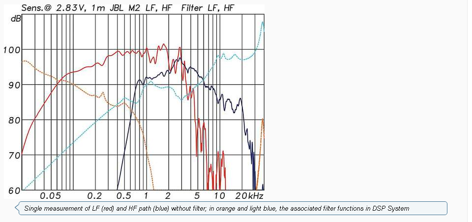

What I haven't seen is the actual non-corrected response curve of the combination, just driver and horn without a network attached.
Attachment source:
JBL Master Reference Monitor - Page 74
Measurement originator:
Testbericht - JBL M2 - Master Reference Monitor - Monitor für große Studios und Abhörräume / SOUND & RECORDING Ausgabe 12/2014

Any horn with sharp discontinuities in flare rate is flawed by the resulting reflections. There can't be any magic fix for it if it's within the passband.

You mean like with this tweeter
H1499-06 27TBCD/GB-DXT
Which is good enough to be used by Bruno in his Kii. It is much like the kind of kinked horn as used in the large JBL, just round instead of square. This apparently aids with directivity control, but I unfortunately do not know the theory behind it. EV has also used kinked horns.
So, I don't understand the intricacies of this design. But, it appears to be very good in controlling directivity, at the cost of some FR compensation that is required (at least for the DXT-tweeter). That is clever engineering. Making electronic corrections has become cheap, so that creates an extra degree of freedom in loudspeaker design.
