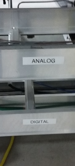

LIGO humor
These guys have a sense of humor, BTW there is only one digital line. These are 12" wide catwalks with wires laid along them.

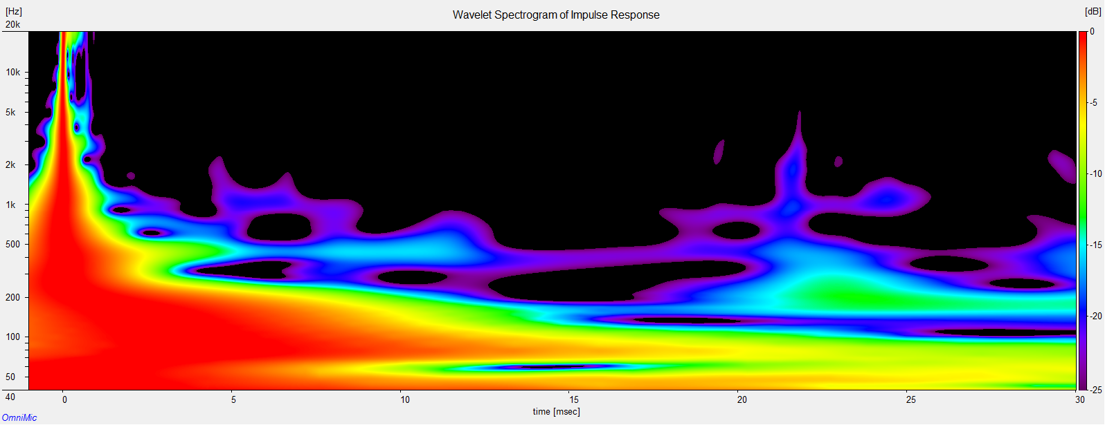

The Wavelet Spectrogram plots are a more recent time/intensity/frequency display, in color, which MIGHT be more relevant. I am wary, though, that it might also be subject to human interpretation error (like oscilloscope waveforms, or CSD plots, or maybe even Step Responses or frequency responses) that make us always tend to think that something that is more easily seen with eyes will also be similarly audible.

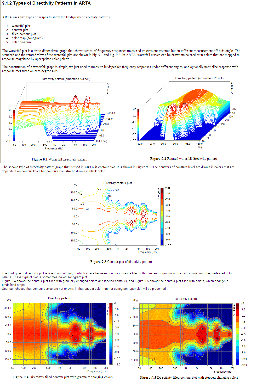

It is interesting how two graphic presentations of the same information can be so different that for me I'm have some difficulty visualizing the data in a familiar way.
Hi Demian
The two sonograms (horiz-vert directivity) are not identical and they seem very good to me. What is not specified is the measuring distance and the 0dB reference
See attachment (Help section of ARTA SW) for an intuitive transition from the familiar waterfall to the somehow newer (old news in ultrasonics) sonogram

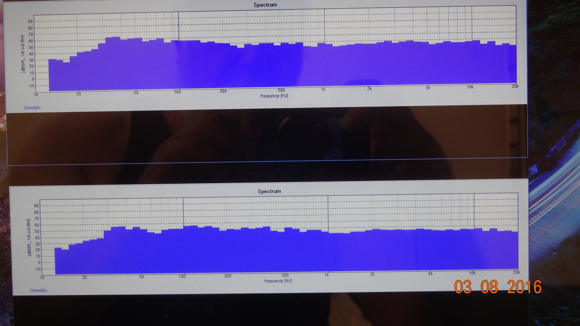

Here is the raw data of averaged SPL at the listening position for the room + speaker (using pink noise) you can see some room gain affecting the bass rise on the left speaker due to its proxy to a corner environment. Spkr-room will go flat down to 30Hz -- without any EQ. Over-all, it is very good result IMO. One always wants to have best results as possible before EQ. Next is to fine tune/EQ it.

Your speaker response is pretty damn good. I wonder if the midbass hump is intentional in the speakers? That's a common thing. And don't expect sound to improve with EQ necessarily.
