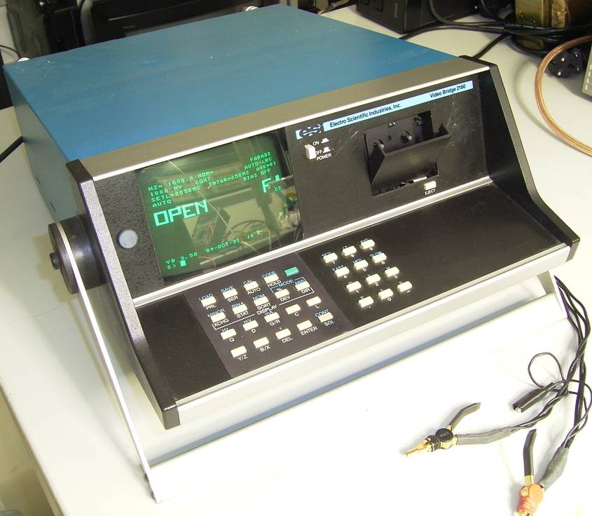

ESI Videobridge!
Heh! Wow Demian, how incredibly cool retro computer-age!! Think of the TTL chips inside!! Cool. And the TAPE DRIVE!! Sweet! And it works too!
Love it! 😀
Actually I have 3. Spares so I dont need to worry about repair.
Its S100 based internally with a Z80. Really vintage but as accurate as any current instrument. And repairable.
Only one has the tape drive. One is a later model with measurements to 100 KHz.

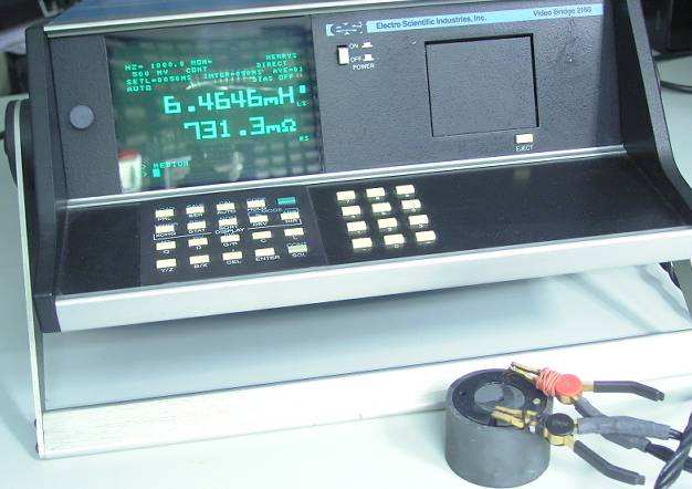

And with measuring clips shorted?
I simply do not believe in those math, .4646... some "floating point" error in co-processor, starving for extra bits?
IMHO, there is simply two ways..boring electronic(also with very nonperfect components, noise dirty, also with unacceptably complicated math for design... ), simply, only for engineers, and other way, interesting "audio" quantum processes, a lot of purity, unknown technology and a lot of imaginations...
This should be learned from begining...
And a diverted approvements for both "ways" 🙂
Leave my bad English aside. I am to old for gramatic purification.🙂
Yup🙂, there is a lot of details in measurement. From calibration(reference inductor is expensive), to usefull writting shown on display.
And necessity for a batch of numbers behind decimal point, for inductors?
P.S.
I have sentimental feelings for such gadgets..as for my student age...
But,they are for special place in my room, not for measurements..
Note that is a random picture, not Demian's setup. He has been in the game long enough that if he says this tester is accurate, I believe him. If you wrote off every instrument that had a display with more DP than you thought reasonable that would be a lot of stuff you wouldn't use, new as well as old.
All you have to do is to round up to 6.5mH, and the calibration is moot!
We used to have the same problem with early calculators. Where did 8-9 places get you? We had to ignore the extra digits, until later calculators would let you round them to just 3-4. Accuracy is important, but in this case, not that important.
Demian,
How much difference would there be for an inductor you were using for a cross-over network in reading between let's say 100hz and say 2.5Khz, enough to worry about the shift from measuring with a variable frequency? Would the value shift enough to be more than a very small percentage of the reading or are looking for the difference between 100hz and 150Khz to see a significant shift in inductance?
Still waiting for your call.
Depends on the coil. One wound with solid core wire could be pretty significant. I was using custom inductors wound with Litz wire on the last passive crossover (years ago). You need to get Litz wire suitable for a frequency 5 to 10X your target crossover and the system works much more like you would expect. None of the commercial "litz wire" or foil inductors had as high a Q at the crossover. Easy to quantify with the Videobridge and measurements of the final network.
Apsolutely!
I would rather to see parasitic capacitance for inductors(or Q factor), instead for digits accuracy inductance.
