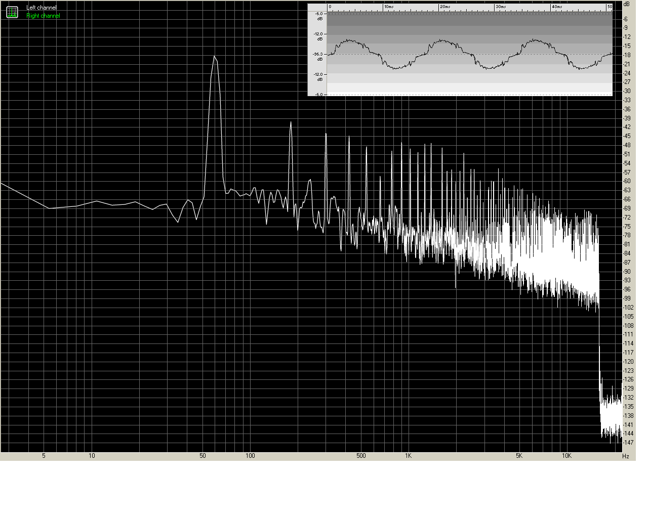

Buzz is the proper word for what I have experienced with the through the transformer core capacity coupling btn live and chassis.
Ed I am all for using words which have a definite meaning. Makes for a positive communication.
It's also my understanding that hum is almost always a result of magnetic coupling ( if not entirely a result of mechanical coupling from a vibrating transformer). And buzz almost always a ground loop issue
https://www.dropbox.com/s/snli120yfug1aiw/Copy%20of%20hum.wav?dl=0
https://www.dropbox.com/s/mmlutbaavng31bg/Copy%20of%20Buzz.wav?dl=0

Ground loops are often explained as a loop that couples to a magnetic field. But more often when you have two paths the resistance is a bit different and so they end up being a voltage divider. I avoid using the term ground loop as I have only once seen a loop big enough to actual have enough coupling to cause a significant hum. The solution was to cut one wire.
I do try to use loudspeaker, audio power amplifier etc to be clear. When I use noise it is a general case of an undesired signal. 1/F or thermal noise are also specific terms to be used when applicable.
I also suspect that you notice the buzz noise we are discussing when it is above the threshold where it is clearly different than noise. I suspect the next time uou play with it you may notice at lower levels it is more random noise like.

I have played back the buzz wav. file many times, progressively lowering the volume. Up to the point of just detectable sound, what I hear is not like random noise. Below that I can not hear it ,so what can I say?
Have you also had the cases where rfi is causing increased noise?
Rfi is always present within the buzz. Buzz has all the odd harmonic components of the main’s fundamental plus rfi that the loop picks up from the environment. You can see the spurae along the buzz waveshape.

For my knowledge noise can be everything added to the signal - so the spectral content and the sound can be anything. On the other hand, the sound spectrum of random noise (white, pink) is well defined and can be easy identified by listening tests.
Hum is for me something like 50/60Hz more or less sinewave, with little harmonic content.
Buzz might by heavily distorted hum, for instance rectified mains voltage, current spikes of rectifiers or leakage current of wall warts. This is often high-pass filtered, thus lacking fundamental and the low harmonics.
All in all these labellings are not strict so verbal descriptions are problematic. Whenever somebody mentions a strange noise, I would recommend to share a sound sample to make identification easier.
