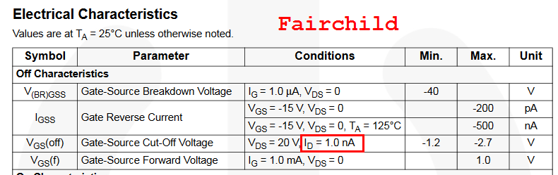

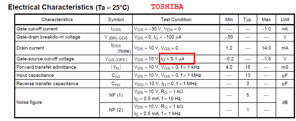

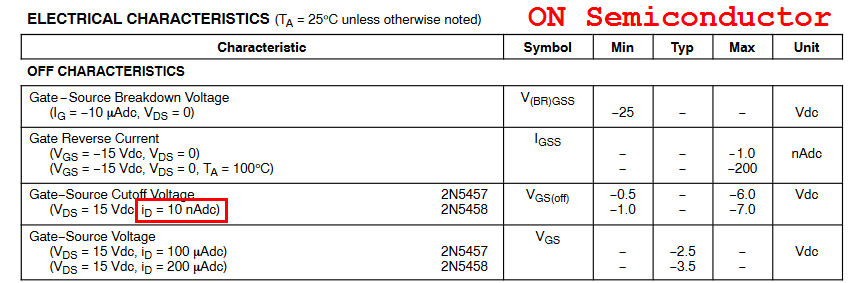

Depends on the manufacturer I suppose. Here are three of them: Toshiba, Moto / ON Semi, and Fairchild. What I see here is nanoamps.Obviously the difference between your 60nA and the manu's 1uA are substantial.

... I am measuring Vpinchoff while forcing Ids=60 nanoamps. That's where I ran out of guts, worried about leakage from fingerprints, humidity, etc. ...
Id is a forced condition, not measured.
In my little jig, Ids is forced not measured. Yes.

OK you have 1, 10, and 100nA try all 3 on the same FET so what's the Vp to plug into the Id vs Vgs equation at 500uA? I happen to have the stuff on my desk today maybe I can try this.

Good, please do. In my case I am sorting transistors, not fitting model parameters. All I need at the moment is a few conveniently measured quantities that help me partition the pool of devices into groups-of-alike-parts. Thus far, using just two pieces of data per transistor (Vgs60nA, Idss10V), seems to be doing an acceptable job.

The effect was quite large for a couple of 2SK222's that I tried .304V and .253V Vp when fit from 100uA to Idss to the standard square law model and .482V and .435V Vgs at 50nA.
