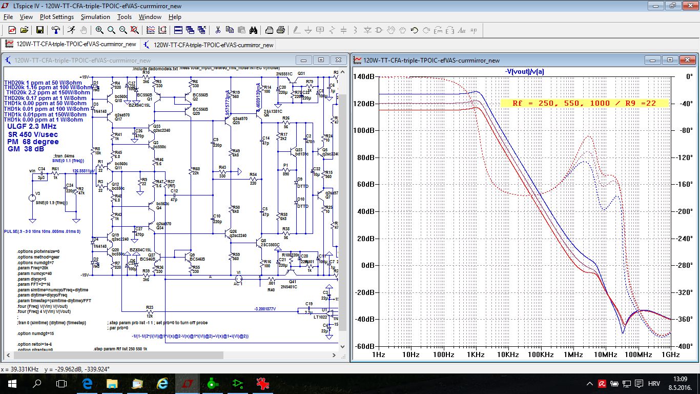

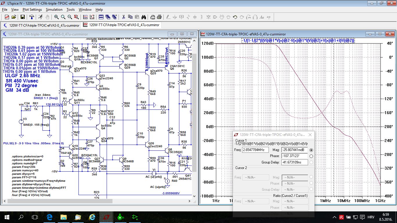

What would you say if looking the right side, the Loop Gain plot, is it CFA or VFA?
In isolation at one closed loop gain one can't tell from that. At the risk of opening a pointless argument I will state my criterion. In a CFA the CURRENT that drives the VAS flows in the feedback network, that is changing the scale (not the ratio) of the feedback resistors changes the open-loop transfer function of the amplifier.
What this demonstrates is that there is no agreed definition of CFA or VFA, everyone has their own definition. The real question is, who cares if it is, in someone's opinion, CFA or VFA? In every instance, that definition doesn't guarantee a blameless amplifier.

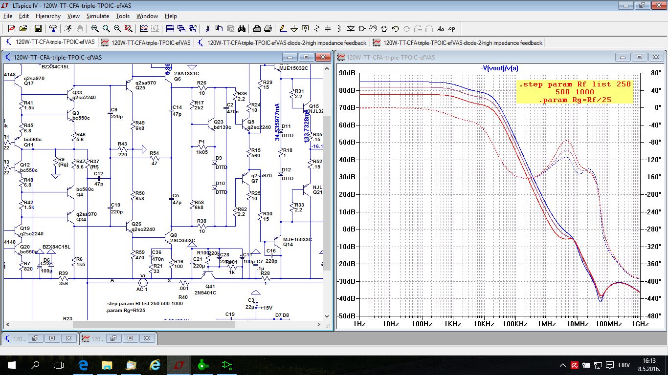

Here I used simple probe an stepper Rf(CLG=Rf/R9+1) and it's clear that this is CFA.
I said the scale not the ratio. In this example Rf || 22 Ohms which determines the OL transfer function (if CFA) hardly changes at all. Try 250,22 500,44 1000,88 or for that matter 10000 and 880 a VFA would not care, but there is peaking and other stuff going on that could obscure the point. As I said a pointless discussion.
This might indeed be CFA but this example is not a good test.

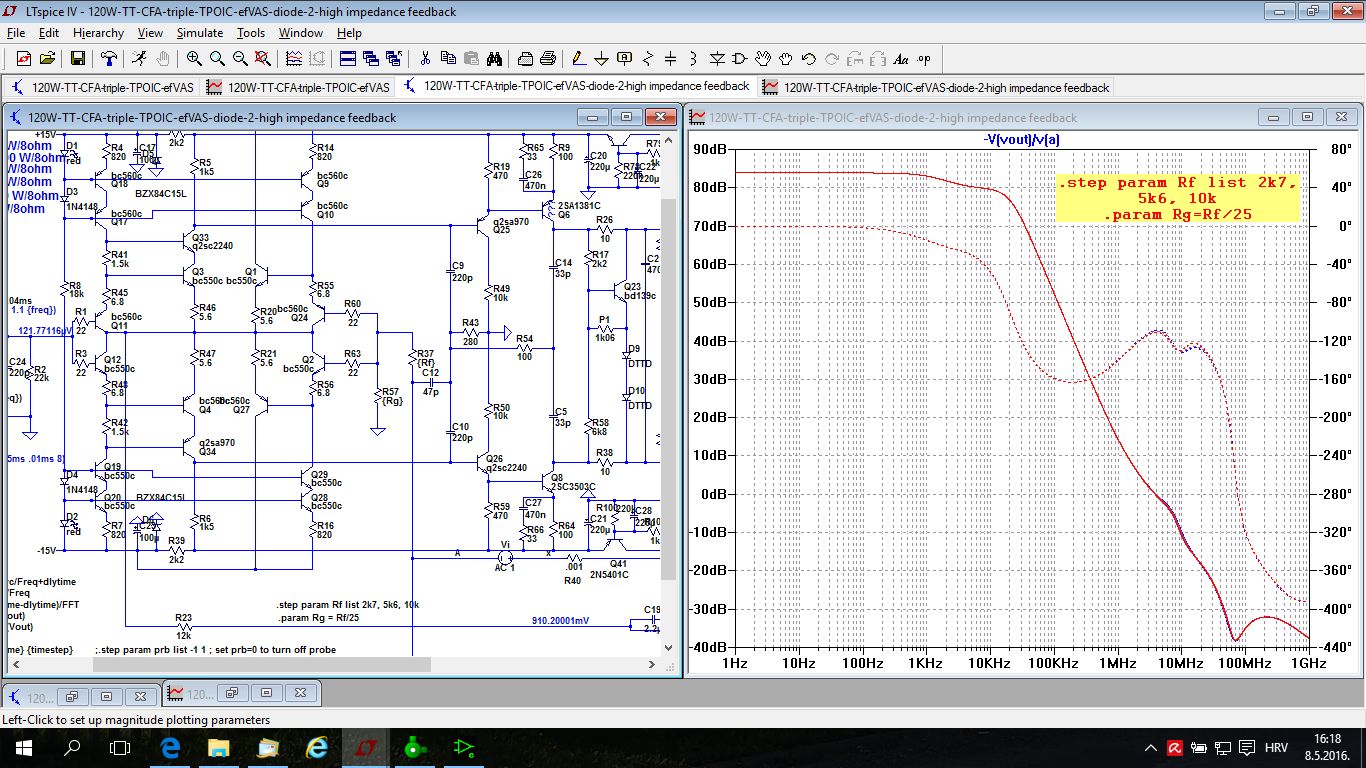

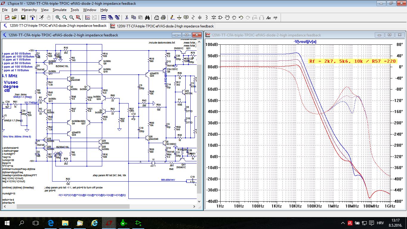

I think I simulated it correctly now.
P.S. Scott, probably this is pointless for you, but we, others, can learn something from it.
