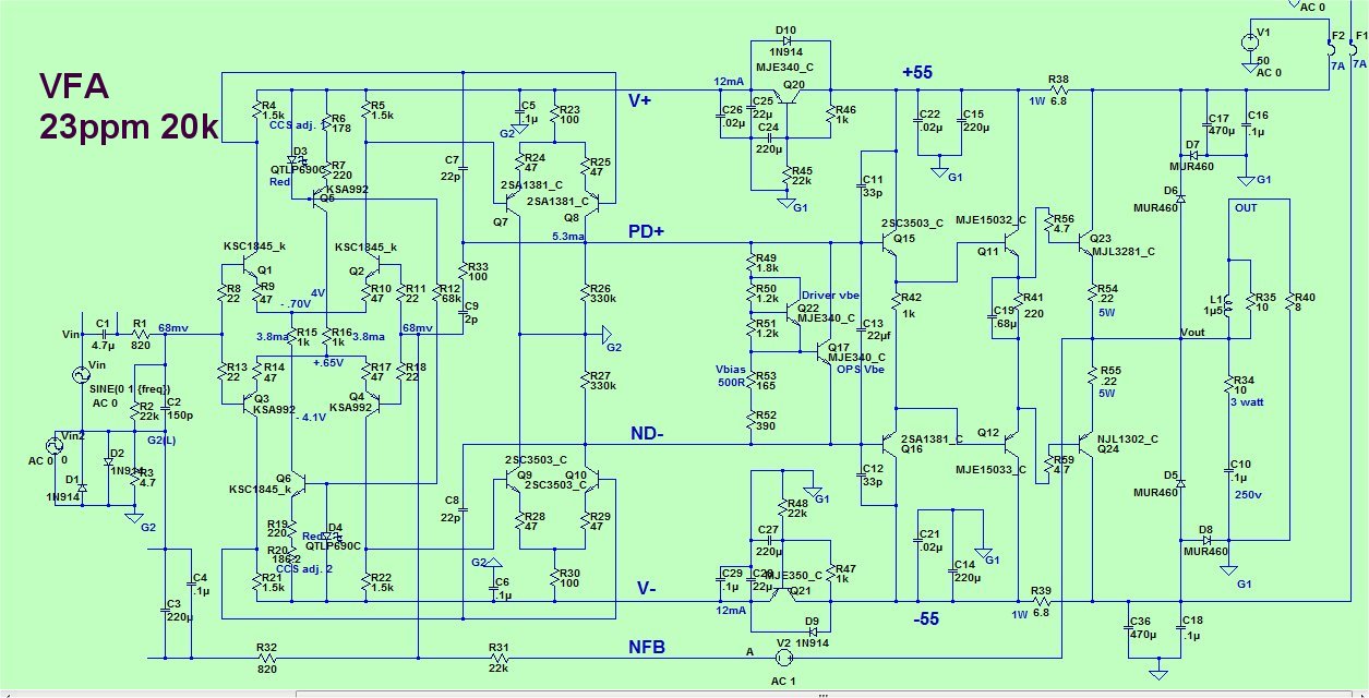

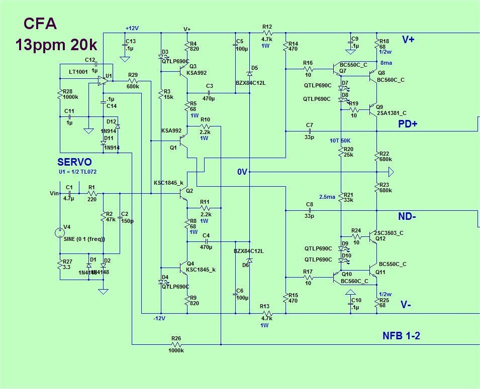

A true "blameless" is an amp that has fewer semi's , under 30ppm , and
lower open loop gain.
The two (below1/2) were actually tested and came close to the simulator
predicted 20-30ppm. Not only can these be abused (shorted) , but I could
hear no real difference with many genres ,or home theatre use.
Absolutely clear, clean and very resilient.
What's next for an "EFA" ? A simple 10 semi input stage needs good
matching - BC846BPDW matched SOT "dualies"....
"credit card" input stages (below) , but I will keep >1W components through-hole.
PS - I bet those two designs would be indistinguishable if plugged
into the same output stage. Below 50ppm all descends into the "haze" of
reliability and other factors (noise/PSRR/ease of construction).

Not to be raw , but it is the performance to count ratio.
A higher count design (like Dadod's), has <5ppm as the goal.
The higher count version of my former second attachment has 16 , instead of 10 - semi's.
The extra 6 allow better/more choices of input devices , higher rail voltages
(cascodes).
Here , the extra's just enhance the base design. In this case , reliability just
may be enhanced (wider supply tolerance) , as well.
From the DIY point of view , it is much easier to advise on builder mistakes
with a simpler design. Many more new members will attempt <16 device
project and get better than OEM results !
Some of the 30 count input stages may approach sub ppm , but as long as a
10-16 can still be <20 (and last) , would we ever hear the difference ?
This is all about compromise , including cost/complexity/reliability.

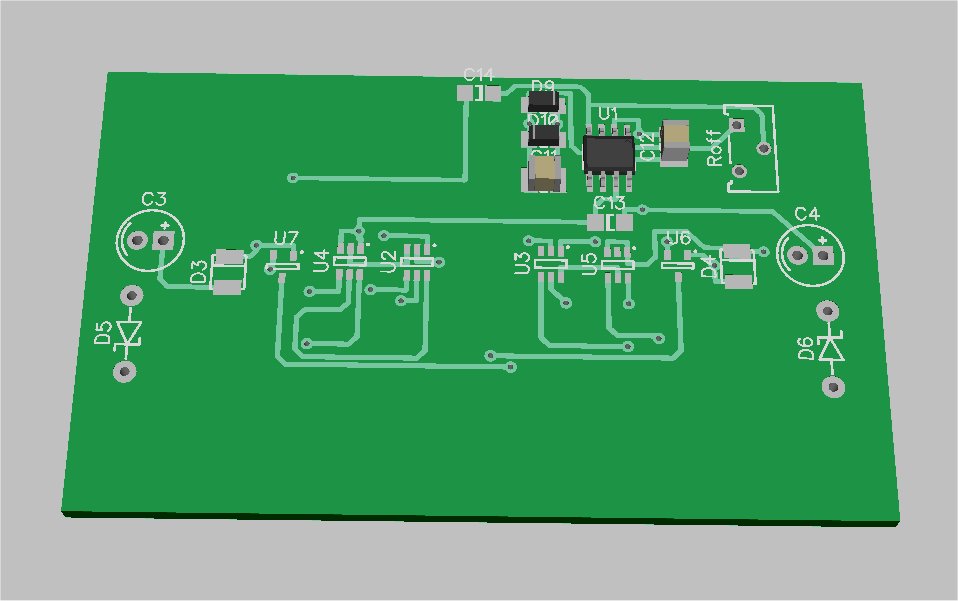

If and when the auto-placement and auto-route of a modern CAD can
figure out ground layout ( maybe some can) , then audio will no longer
be an "art".
Auto - route is nice , but does not group by currents/ground returns/loop area
of a trace.
Diptrace DOES have the rules automated
for digital circuits. Even a much more sophisticated MPU design would be
automated from beginning to end.
If you obeyed the electrical constraints of the design , you would end up with
a functioning end result. If you let Diptrace design the audio (layout) , you would have
a mediocre functioning circuit - analog is "picky".
OS
