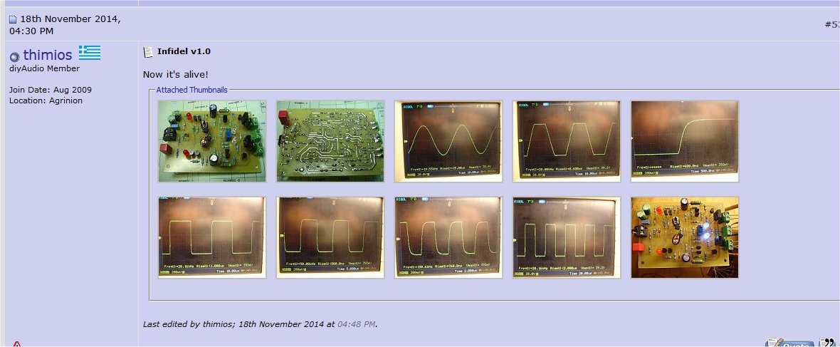

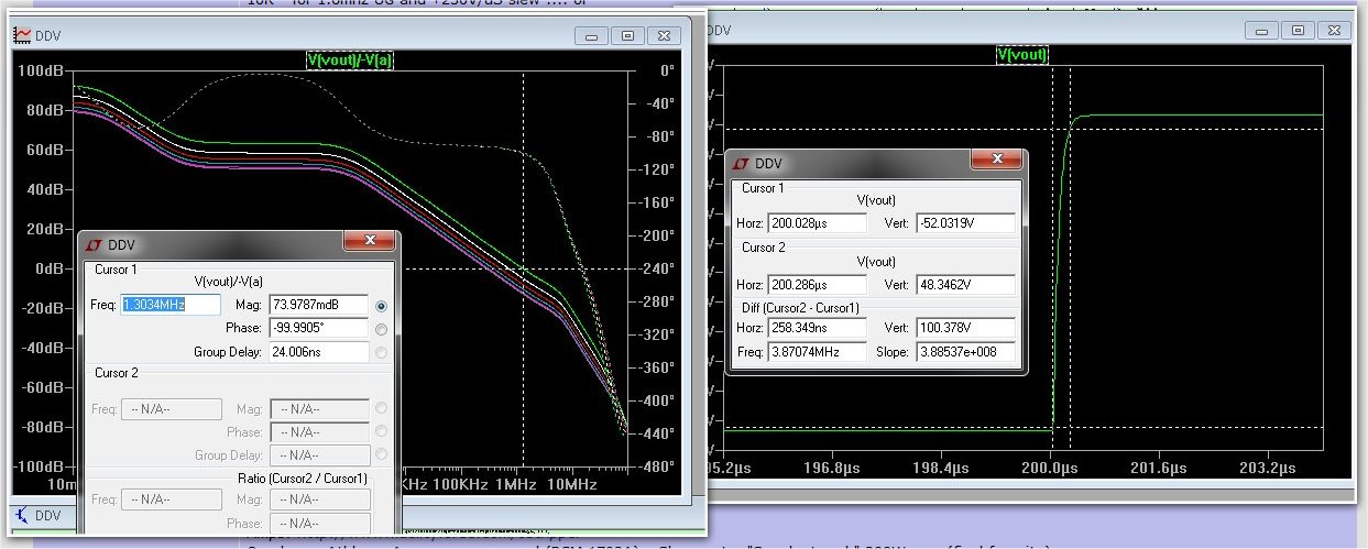

It has the UGLF and bode "slope" of a CFA (below) .... link where I went through all this and Thimios actually built it - http://www.diyaudio.com/forums/solid-state/248105-slewmaster-cfa-vs-vfa-rumble-105.html#post4120777
With the high Z NFB ... yes, it is a VFA. But internally it slews and has
the gain margins of a CFA.
Much more CFA "like" than VFA.
(below 2) we actually simulated and built it. It is a "EFA" (excellent flippin' amp). 😀

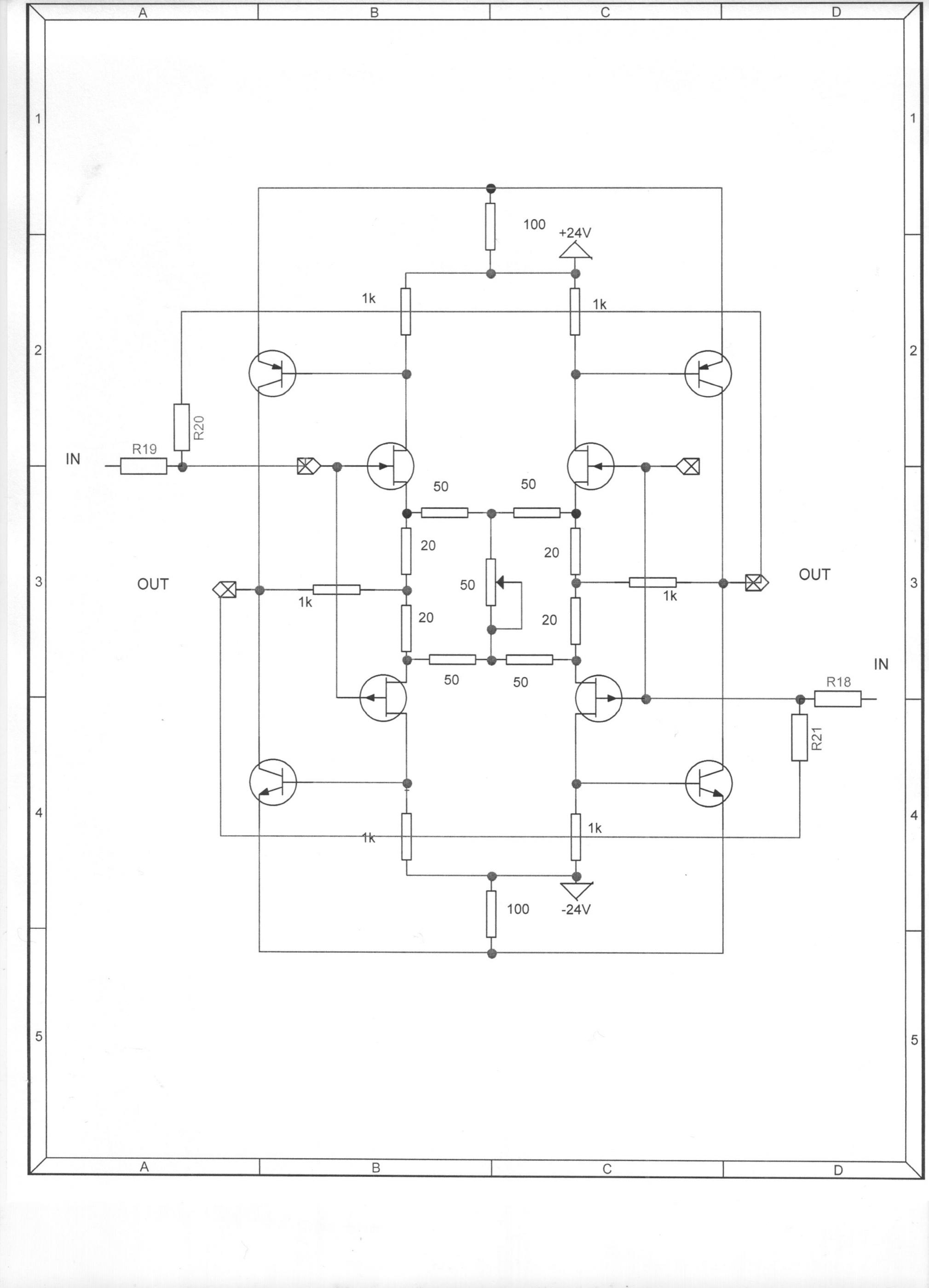

Sorry if my post started that again, I just wanted to show a power amp with fully balanced input.
I tried to get that and keep pure CFA configuration adding only one buffer, but there was to much distortion. Now there are two buffers, one to have high impedance feedback input and second one to get fully balanced input impedances and high CMRR.
No problem.Sorry if my post started that again, I just wanted to show a power amp with fully balanced input.

What about this schematic?
I used a similar conceptual design about ten years ago for Dave Wilson's built-in subwoofer amplifier..... 900W/4 at very low thd. Fully balanced from input to output.
In fact, I got the idea from you.... you sketched it on a napkin in Berkeley many many years ago when we were trading info on low distortion ideas.... and I told you about the cancelling C of devices tests I did and nulling thd. Back when I lived in the Bay area. I left the bay Area about 20 years ago... so it was years before then.
Funny how things come back when you need them to but are otherwise completely forgotten about.

I wouldn't add the extra complexity unless there was some compelling need for a balanced input Z for a signal source.
I have never found such inputs needed for best sound/performance in a home audio environment. But sometimes there is a compelling audiophile Marketing need.
THx-RNMarsh
This is curious. You fret about hi-rez recordings yet are completely happy to have zero common mode rejection in your system. Surely signal integrity should be high on the list with the highest resolution recording and converters?
Good idea, because it does not. That's according to your own criteria, and also according with e.g. the LM6171 data sheet.

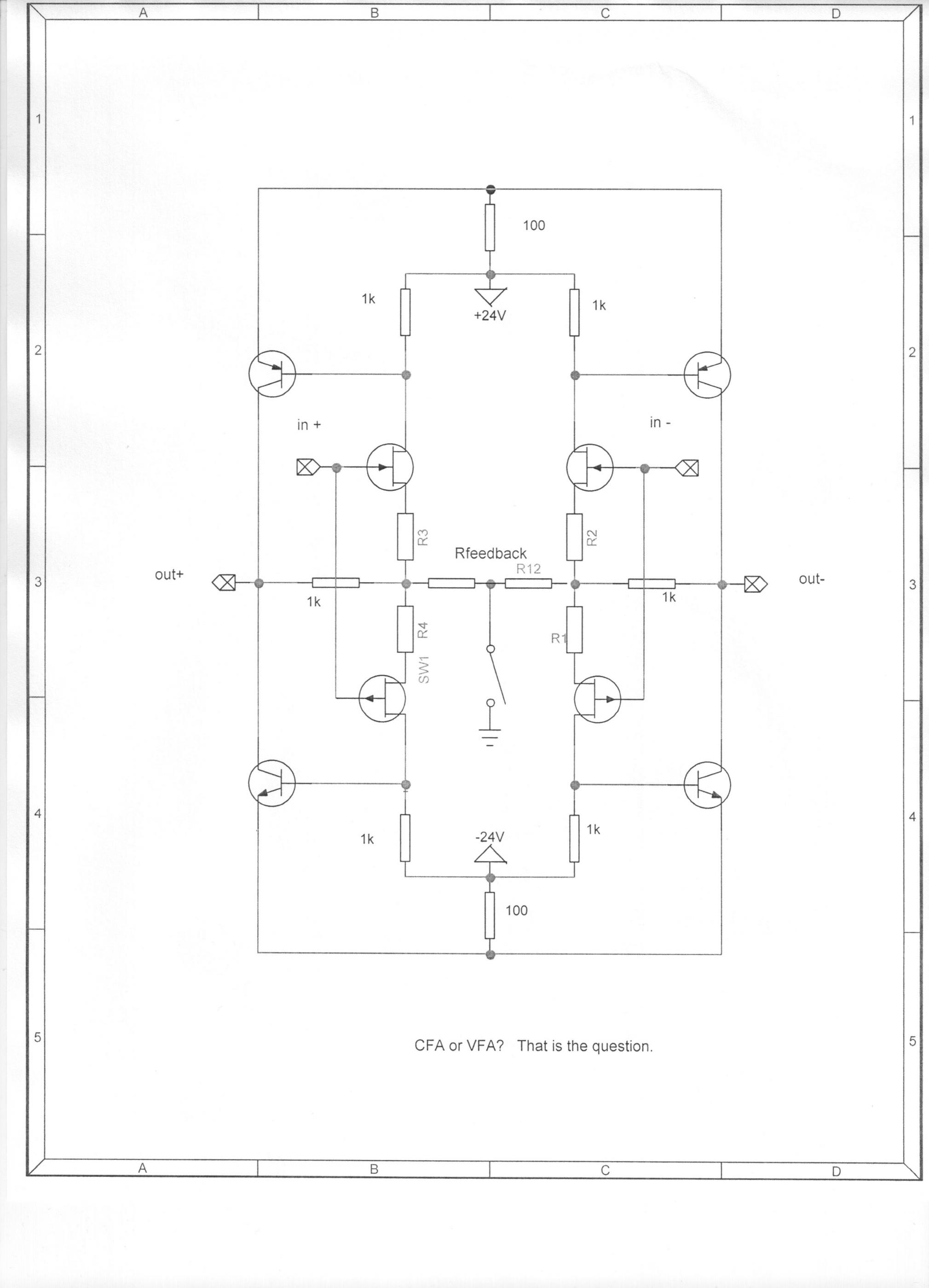

That's not necessarily a CFA since we do not know what is inside the gain block marked A, and critically, how its compensated. Dados design is a true 'H' bridge CFA in my view.
I'm with Ostripper and Richard on this one.
Sorry Scott - you are one smart guy and I have enormous respect for ADI - but I'm sticking to my version of what constitutes a CFA. No hard feelings I hope 🙂
With respect to power amplifiers as discussed here, what's important to recognize in this discussion (and I think I only came to realize this sometime after making my case about 2 years ago) is in terms of behaviour, its really a continuum between the two. As you raise loop gains in CFA, their behaviour morphs into VFA and you have all the familiar comp issues to deal with.
