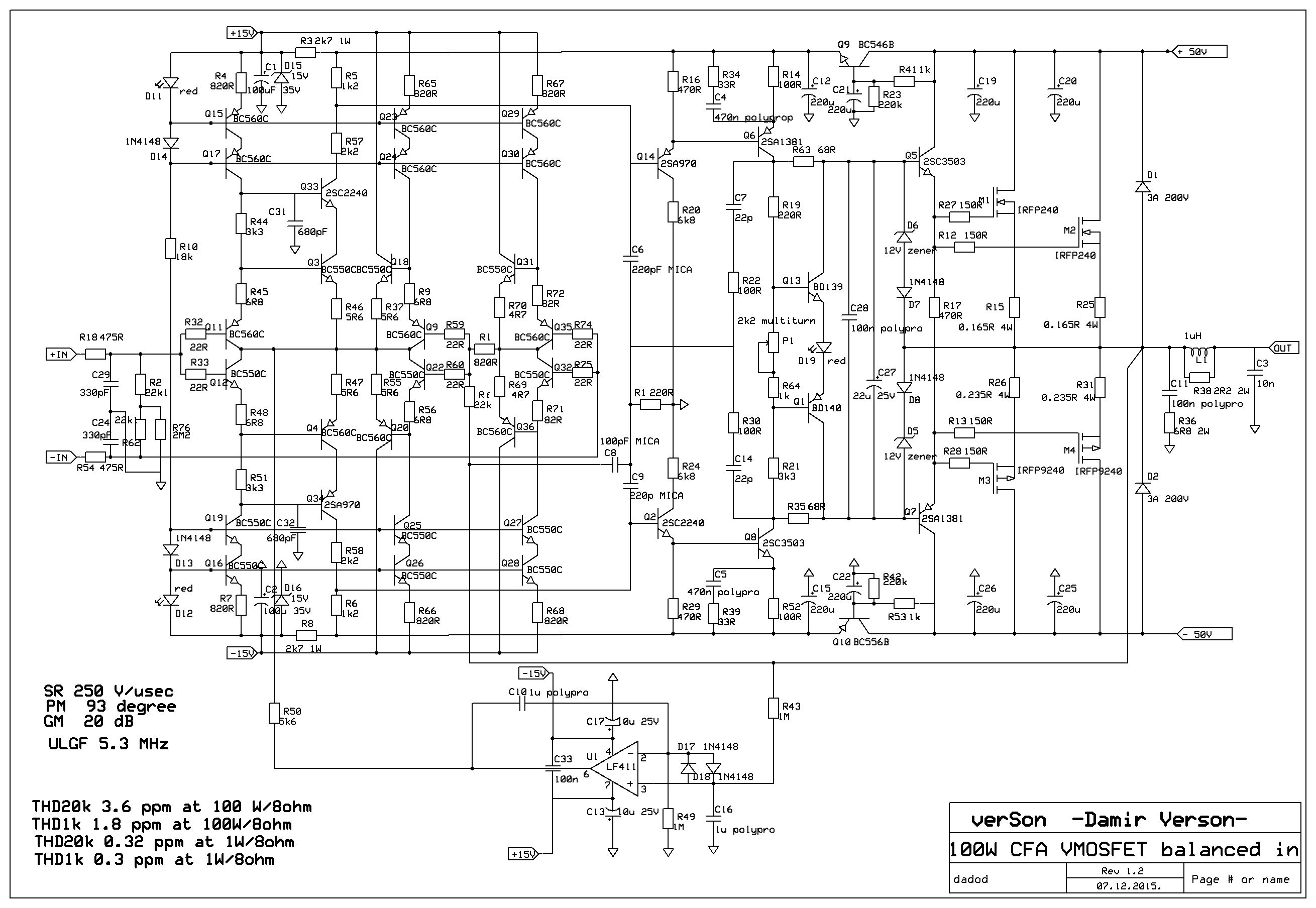

I agree - balanced all the way. I don't know how Doug could force that blameless thing on the world when he had the opportunity to do a decent balanced design. Leach got it right back in the 70's all ready.
Can I just check what you mean by 'balanced' here? The one thing you very rarely see in a power amp is a balanced input unless its a couple of op-amps converting to single ended for the amp proper.
Of course there are two ways at least to interpret this. One is truly balanced input (not some bogus inverting stage to convert single-ended to push-pull). Keith Johnson used to manage this from the phono cartridge, or the tape head, to the loudspeaker. I also discussed with him the possible inference of the superiority of tubes based on the necessity of balanced topologies to achieve symmetrical large-signal response, with KOJ at the time expressing his heavy weighting of symmetrical slew rates as psychoacoustically important. I don't know offhand how this surmise or suspicion was determined, although Keith has fabulous ears and makes great recordings.
I think what may be more common, and was perhaps intended, is the distinction between single-ended complementary input stages, (and the following symmetries perhaps), versus the "blameless" single-diff-pair input stages.

Is this one balanced enough?
The servo isn't. The power supply regulator isn't. But close
If I can handle 18dBu inputs then yes
I did mean to ask on the other thread how you were dealing with the peculiarities of the VFETs.
By balanced I mean symmetrical or complimentary. Input is single ended - feedback into the other side of the input stage. Truly balanced complementary designs probably best with VFA as with with CFA you have a lo z -input node to deal with.
Also, nothing wrong with using op-amps or perhaps THAT device to convert balanced to single ended!

That's how I am currently doing it and the THAT chips are marvellous at the job (although they can end up being the main distortion contributor when you are down to ppm levels). Just keep thinking there must be other ways to extend the balance, but I think thats tube amp thinking clouding my vision as Brad noted.
Jan
I don't get it, servo and power supply regulator(cap multiplier?) not balanced?

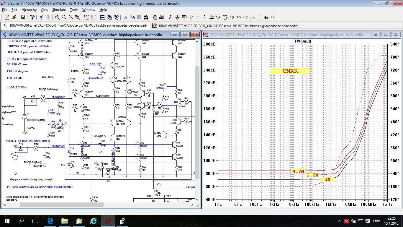

This is a balanced input to unbalanced symmetrical complementary power amp output. CMRR is quite good.
This is not PA, it will clip before 18dBu, what do you mean by handle?
What you are interested about VFET, I have no problem with them. I am listening all days the version of this amp with no balanced input and pure CFA mode.
I am a bit confused here. I was thinking that single ended(contrary to push-pull) is single output transistor(or tube) and it should be in Class A for audio.
JLH 10W amp is single ended as I see it. That naming is mostly used in tube amps.
MiniDSP HD has pro level balanced outputs. As I'm moving to digital crossovers seems a good time to move to running interconnects hot. No logical reason, just cos I canThis is not PA, it will clip before 18dBu, what do you mean by handle?
Mainly how sensitive Id to Vgs is with temperature as the curves are very close at sane bias levels. A bit of loud music to warm things up and your quiescent goes all over the shop. I don't really want to bias the output to 0.5A per device!What you are interested about VFET, I have no problem with them. I am listening all days the version of this amp with no balanced input and pure CFA mode.
