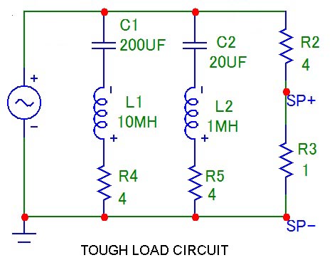

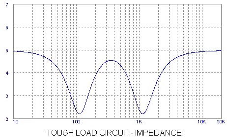

Interesting about the performance into tough loads. We use the
Tannoy 15" HPD coaxials, which are efficient and benign, as a reference.
We also can run them through a "tough load" as part of the
listening tests, which attenuates the sensitivity by 14 dB and also
loads the amplifier. This allows a good subjective comparison and
gives us a sense of the amplifier over a range of loads.
Very nice Nelson - thanks for sharing.

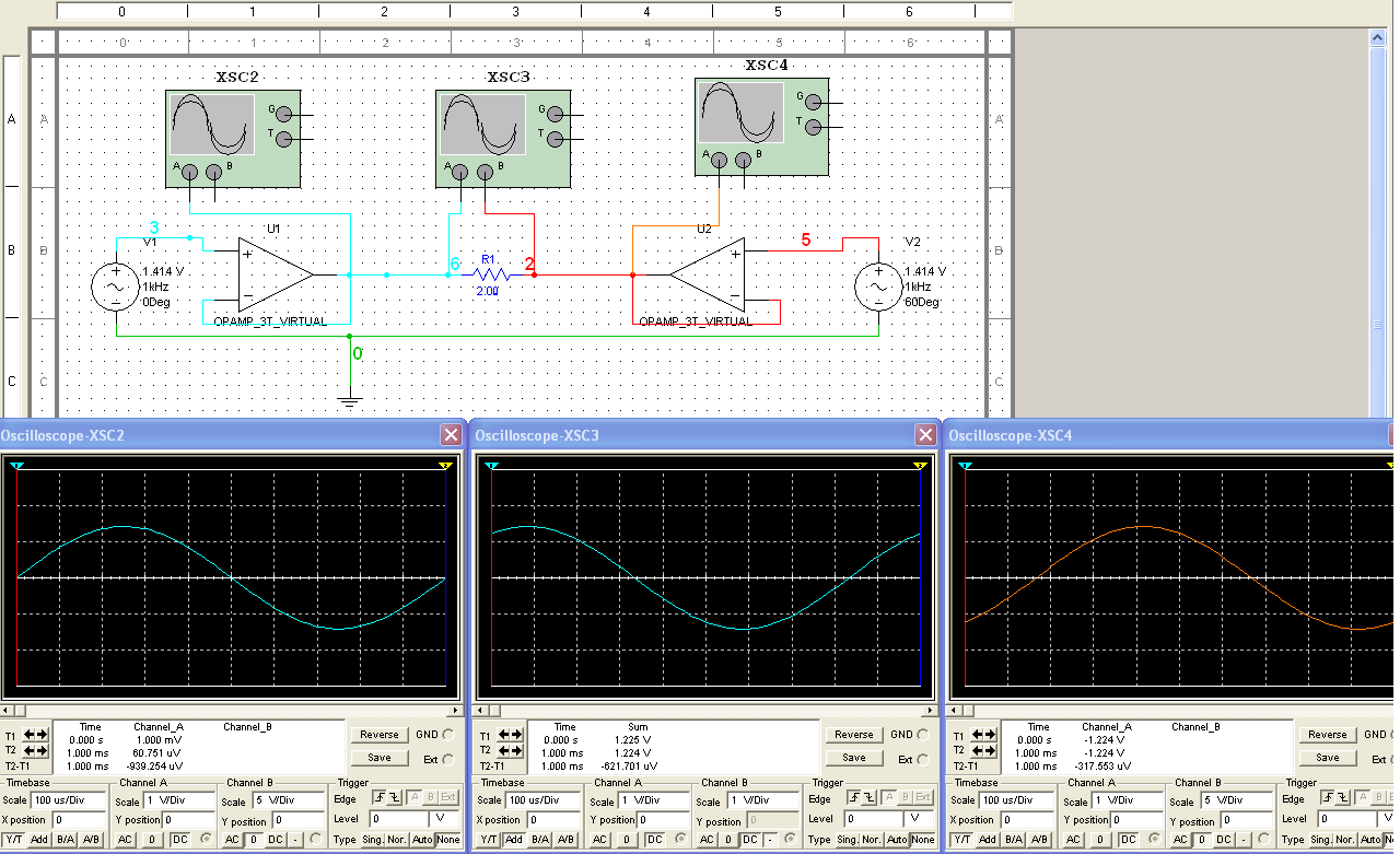

The new model of PowerCube uses active loading.
http://new.audiograph.se/wp-content/uploads/2013/12/Watercooled_Loadbox_OperationManual.pdf
That’s a very clever implementation. See pages 5 to 10 for details
Simulation and some calculations will reveal the secrets for voltage-current phasor diagrams, then a semi-manual diy version is feasible 🙂
George
