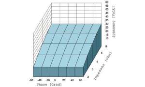

Most of the back issues of The Audio Critic are available on-line. I'd strongly suggest reading their power amplifier reviews for a good explanation of the method and some of the data that can be obtained this way.
Sadly after checking a few he just re-uses a std paragraph. Can't find a detailed description of how the box is put together. OK admit I'm lazy as not hard to work out the L and C values for each of the tests...
to wit (hoping this is fair use)
I began with our specialty, the PowerCube test, which is best performed with two simultaneously driven channels, although the readout shows only one channel. As I’ve explained many times before, the PowerCube test measures the ability of an amplifier to drive widely fluctuating load impedances. As far as I know, The Audio Critic is the only American audio journal to publish PowerCube measurements. The instrument for the test is made in Sweden; it produces repeated 1 kHz tone bursts of 20 ms duration into 20 different complex load impedances across the amplifier (magnitudes of 8Ω/4Ω/2Ω/1Ω and phase angles of –60°/–30°/0°/+30°/+60°). The graphic output of the instrument shows the 20 data points, at 1% THD, connected to form a more or less cubelike polyhedron. The test shows up the differences between otherwise similar amplifiers when it comes to real-world loudspeaker loads rather than just resistances.
