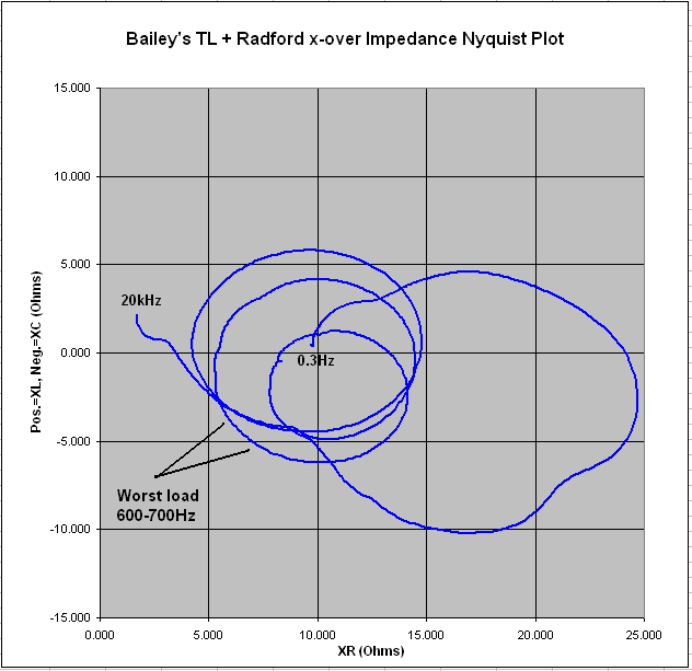

I have yet to find a driver motor unit that is itself a difficult Z load.
In all cases, the low Z values I’ve measured across the terminals of a speaker box are to be attributed to the passive cross over used.

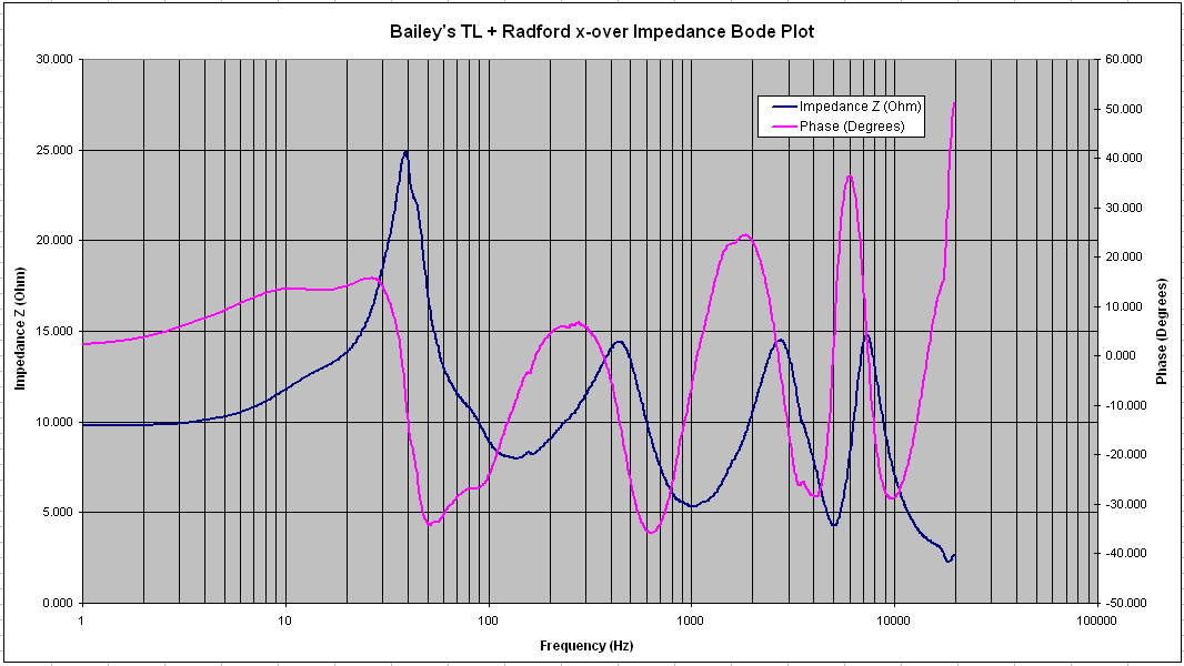

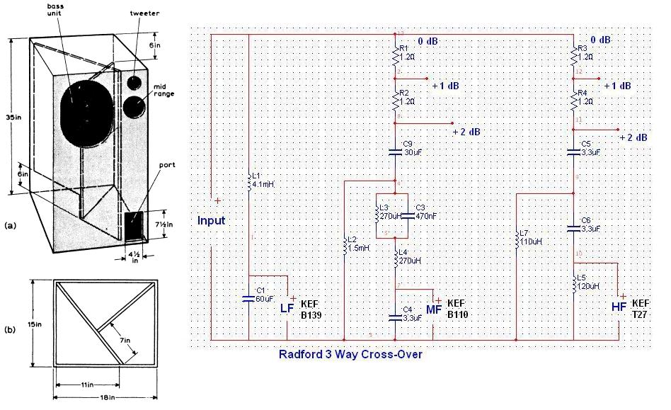

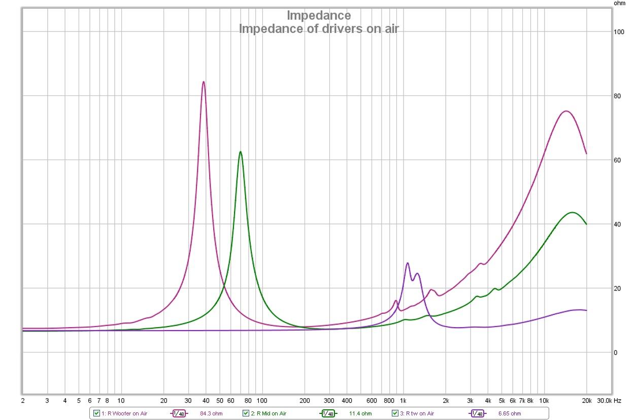

I give you an example
George

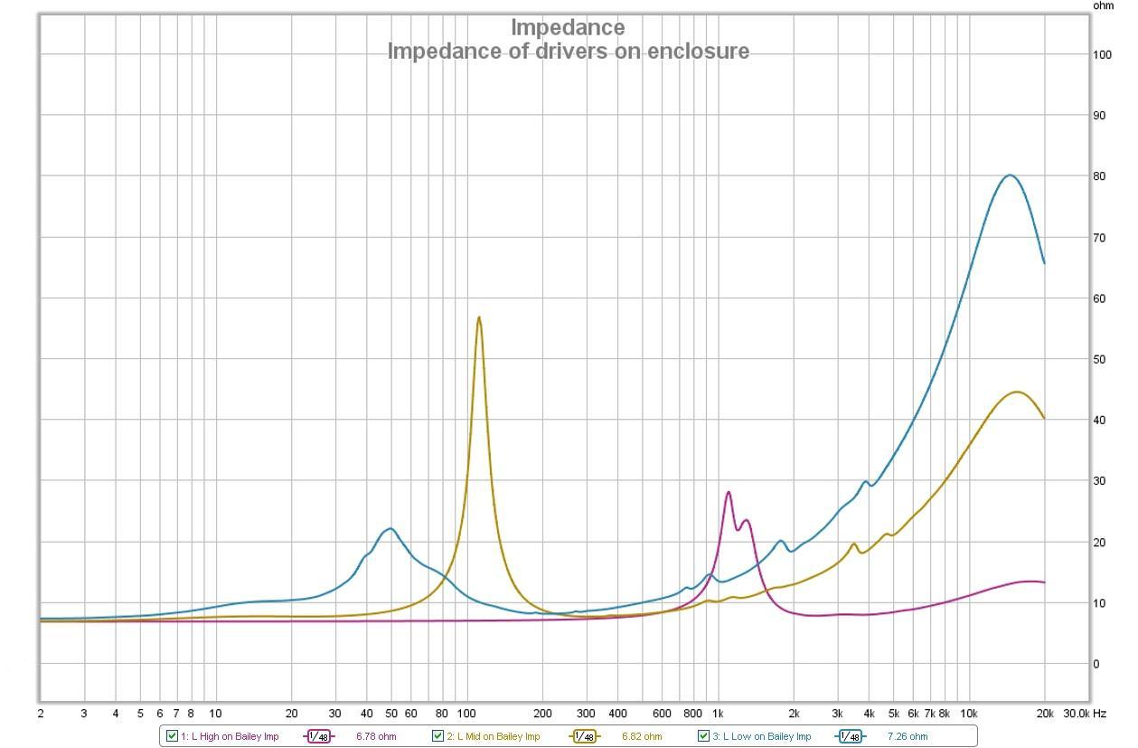

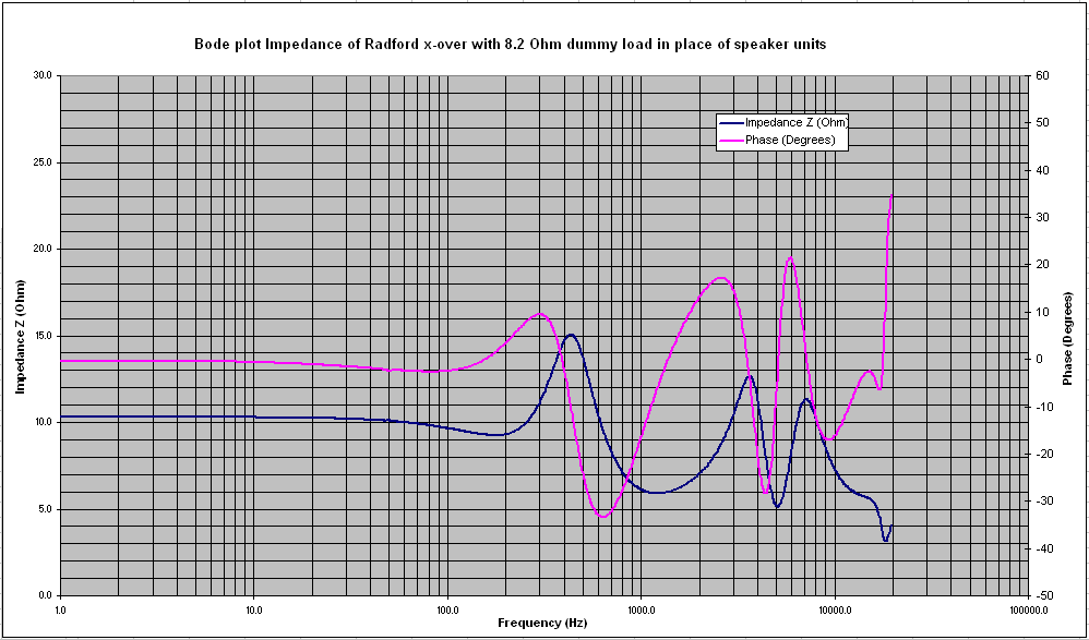

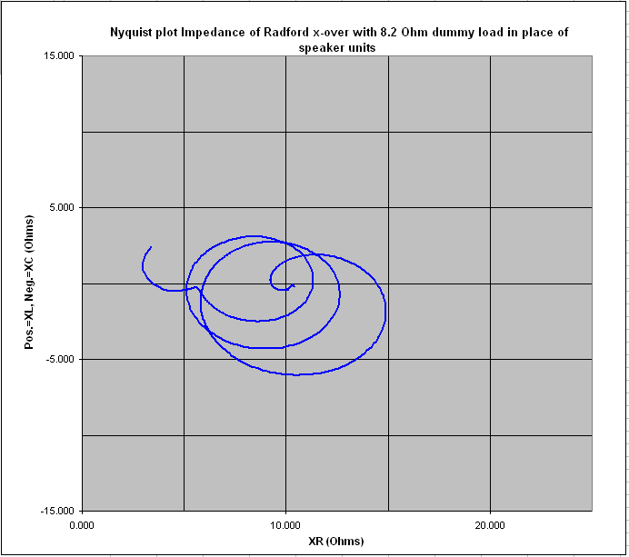

George
George, I do belive difficult loads require actual XOs and drivers to turn from reasonable to difficult. Look at the plots you procvided - the one depicting only the XO network is easier than the one of the XO network with connected drivers. That one shows a phase shift of +/- 40 degrees, which is not easy but is still far from deadly
George
George,
As I read your measurements at 20,000 Hz the HF drops to 2.5 ohms. There is shown in the schematic 2.4 ohms in series with the tweeter. Does it really behave as a .1 ohm load? What is the DC resistance?
George,
C3 is also resonating with L4 which is responsible for the bump. The resistors are optional and are switched out for EQ, so worst case would be to simulate without them.
