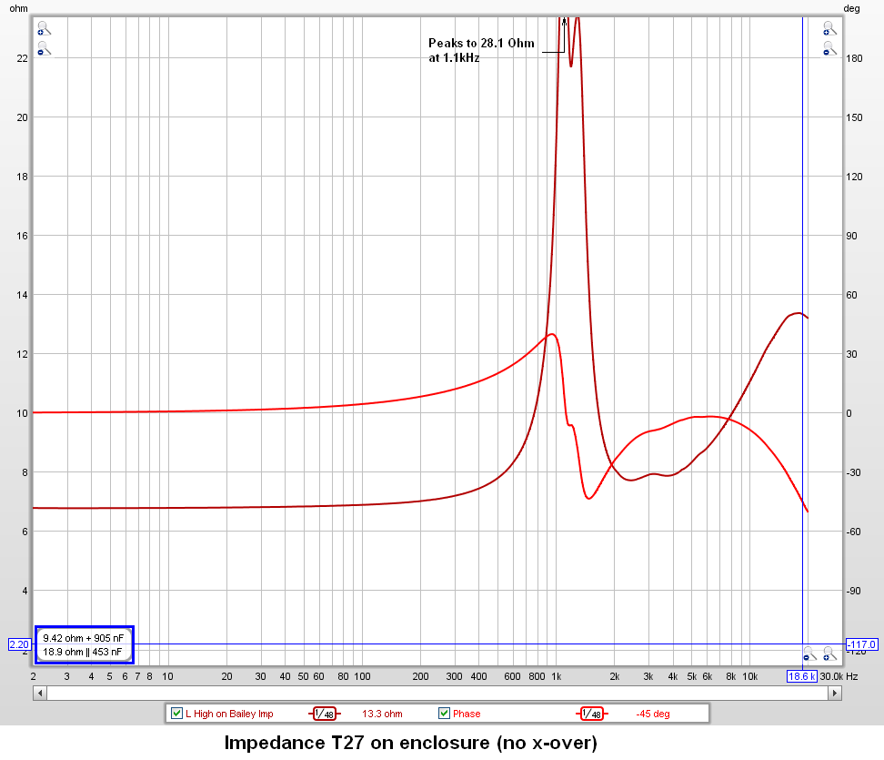

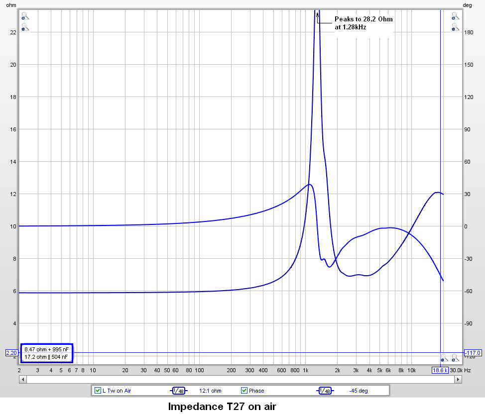

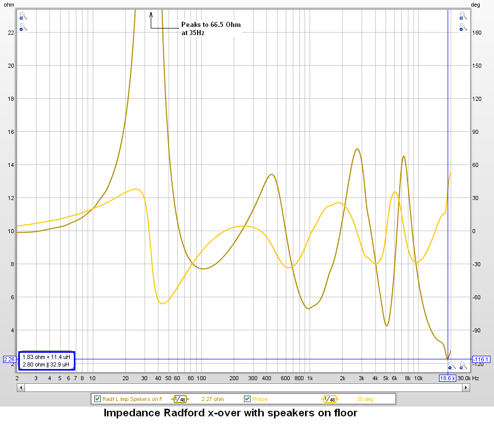

George,
As I read your measurements at 20,000 Hz the HF drops to 2.5 ohms.
Ed
The tweeter drops to a Z of 2.2 Ohm at 18.6kHz. It is 1.76Ohm XR and 1.43 Ohm XL, so only slightly reactive. But what is worrying and I haven’t measured is if the reactance goes sharply up above 20kHz.
There is shown in the schematic 2.4 ohms in series with the tweeter. Does it really behave as a .1 ohm load? What is the DC resistance?
From my notes, the measurements were performed with all the adjustment resistors shorted. The ohmic component then is all due to T27.
Rdc was 5.9 Ohm for T27, well within it’s specs
https://www.madisoundspeakerstore.com/pdf/kef/Kef Driver Spec Sheets.pdf
Compare the plots (including the Nyquists) with resistors replacing the drivers. Same LC but quite different results. The impedances with and without baffle show the high frequency loading increases.
It looks to me as if the HF is above the value of the dummy resistor and I don't see lots of extra phase shift on the Nyquist to account for the drop in impedance.
The dummy loads were all 8.8 Ohm
Attached are all measurements (REW V5.13) that can show what affects which.

The HF driver is indeed more of a load than the resistor. I would not expect a low efficiency soft dome tweeter to show the back emf drop. In the more common resonance the model (which I really don't like) is of a parallel RLC network. The other version of course is the series version. To get this behavior I believe requires a very stiff piston.
When I have time at my office I'll look for an example of a drop in impedance below DC resistance of a driver. Note in most of my work we don't use passive crossovers.
