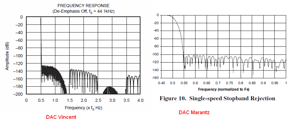

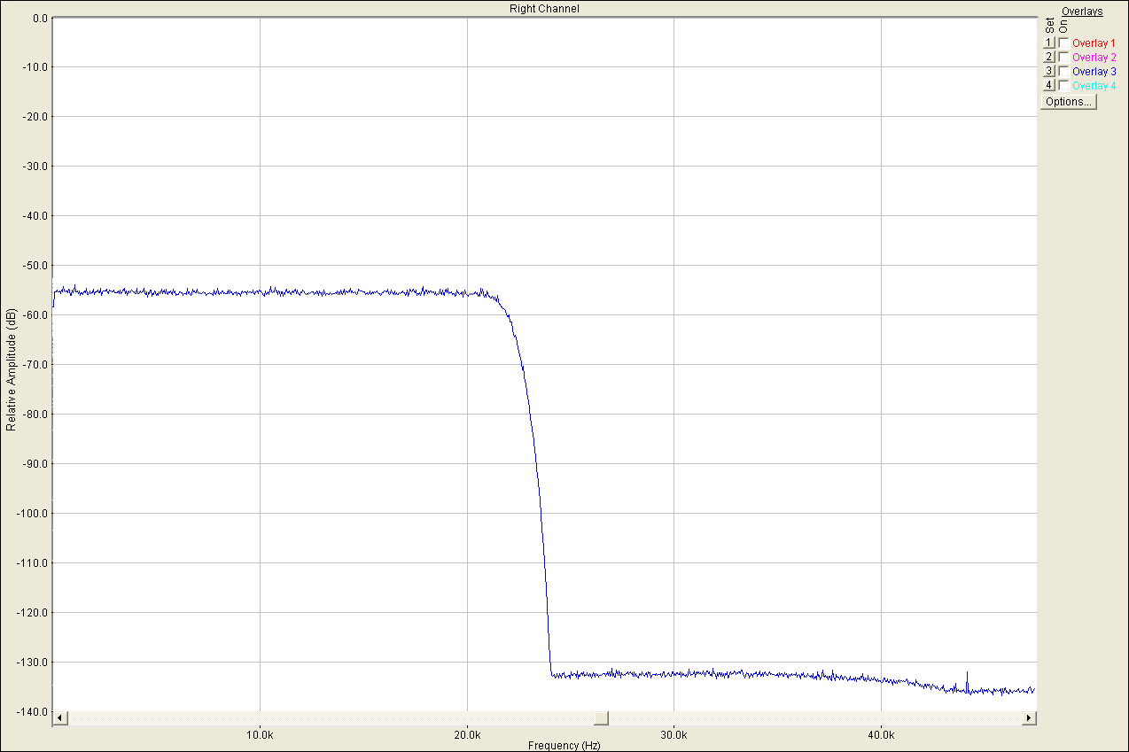

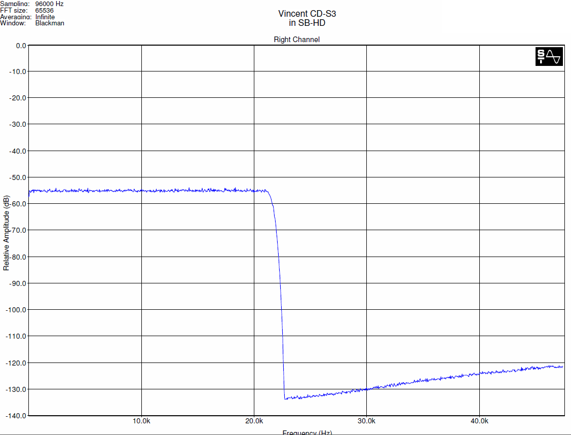

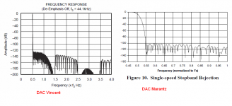

There is no way to avoid 22kHz brickwall in oversampling DAC. 22kHz brickwall is used as a reconstruction digital interpolation filter, to calculate values of inserted data points (inserted for oversampling). You only have some free space in output analog LPF with oversampling. Not with digital reconstruction filter.
Vincent CD shows no mirror with 21kHz sine, Marantz CD has a mirror frequency. Exactly according to DACs used.
Results shown are in conformance with datasheets.
Measured are soundcards and conventional players. Stop band and mirrors differ according to DACs used. In the attached image, the DAC on the left has no issues with mirror frequencies. Please note its stop band starts below 0.5 Fs. But the DAC on the right has issues, stop band starts at 0.55 Fs. So signals with frequencies close to Fs/2 create mirrors.
Vincent CD has no mirror of 21kHz sine, Marantz CD has the mirror spectral line. Just according to DACs used. Check the stopband frequency - 22kHz vs. 24kHz.

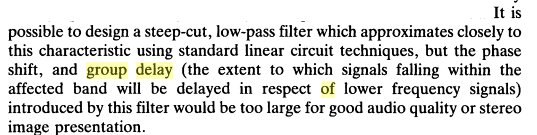

What you find in the cited reference is unfortunately bollocks such as this:
Several myths here;
(1) While analog filters that one finds in audio gear are usually very primitive in the cosmic scheme of things, they don't have to be that way because they are analog. It was the cost of implementation and the lack of sophistication of the designers (usually more of the former) that made things traditionally this way. Time delays, phase shifts, and steep slopes are all possible in the analog domain. It is just that such filters are costly and complex to implement in the analog domain.
When I was in my early 20's I worked with Doppler RADARs in the Hawk Missile system (an exceptionally long lived missile system that was initially implemented in the late 1950s and was still in use in Y2k) There were many different versions of it, and the one I worked on (the second version) was basically tubed. Two of the RADARs I maintained had about 400 tubes each. There were many circuits in that classified system that I only otherwise saw in some of the most advanced engineering texts in existence.
(2) The ear's tolerance for group delay is tremendous, especially >> 1 KHz where it basically lacks the hardware to discern phase. If phase shift or group delay are applied equally to all audible sources, > 1,000 degrees of it will completely slip by well-trained listener, even at lower frequencies.
Get the book i've mentioned before on the most up to date knowledge of phychoacoustics in hearing group delay. Thats all i will say as the experts have spoken (written).
Too bad the book is so forgettable that you can't seem to remember its name, because I can't, either.
What a recommendation for a book - this book is not even worth remembering its name!
But I may have an excuse, I may never have seen its mention.
