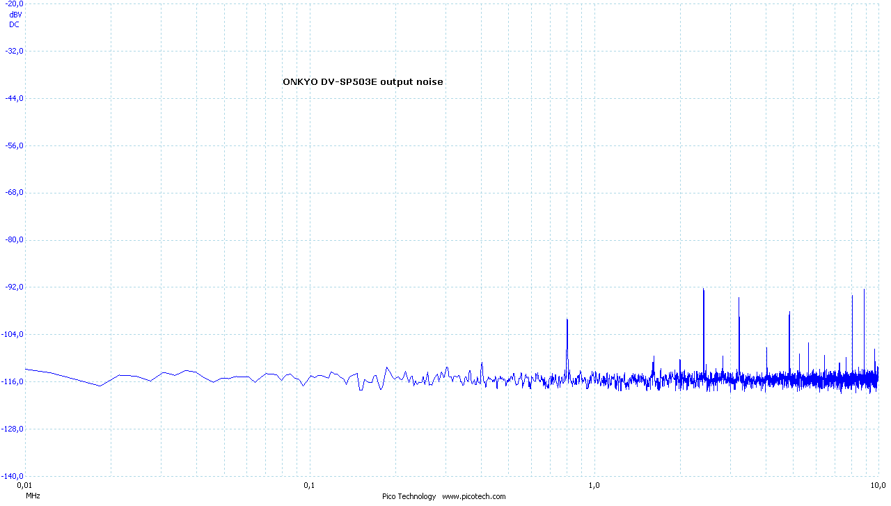

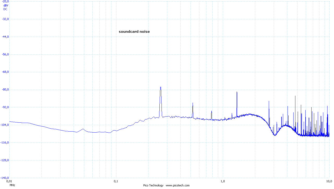

Two measurements of HF noise with 10MHz bandwidth, soundcard and Onkyo DVD player. Y axis is calibrated, dBV is dBV.
Yes, this cannot be seen with 30kHz analyzer, on the other hand narrow bandwidth is necessary to get resolution for noise and distortion measurement in audio band.

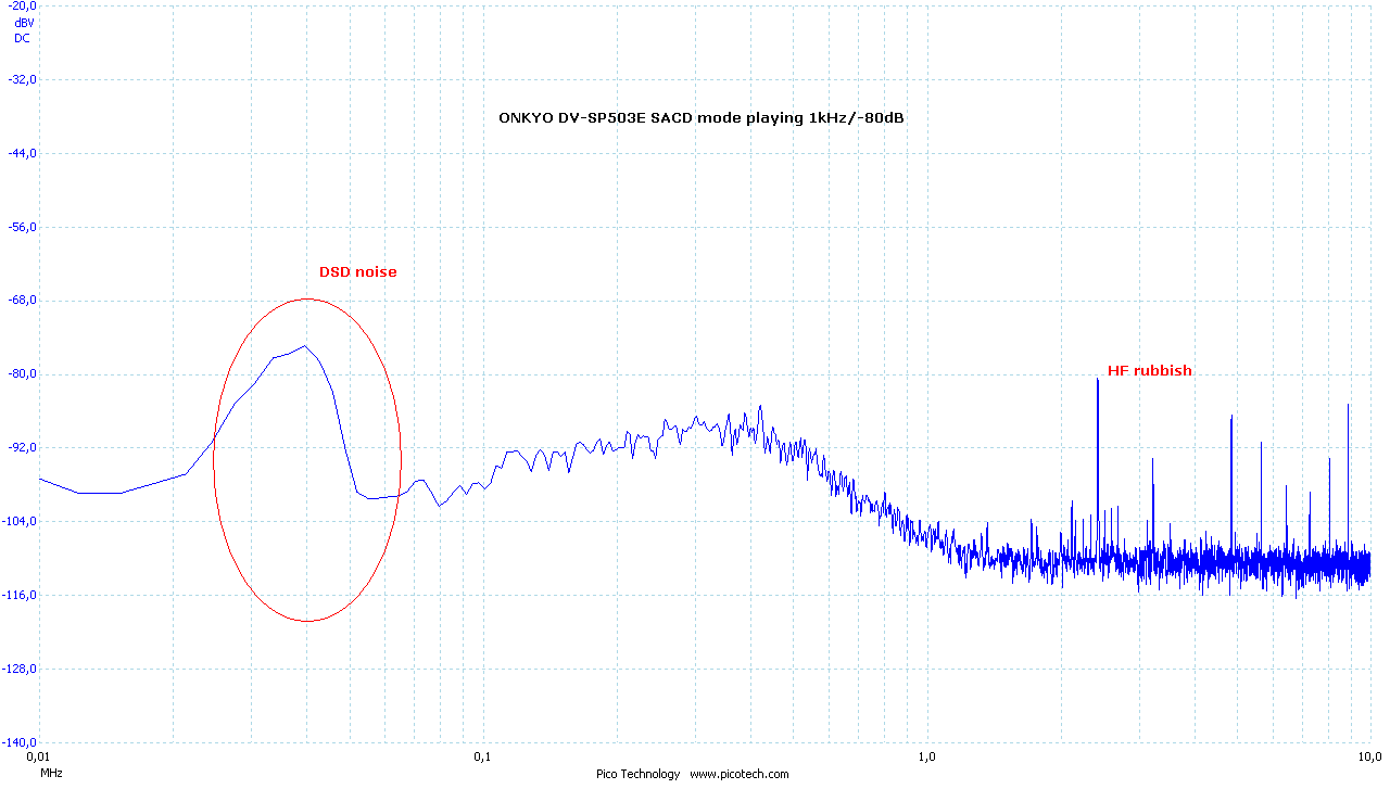

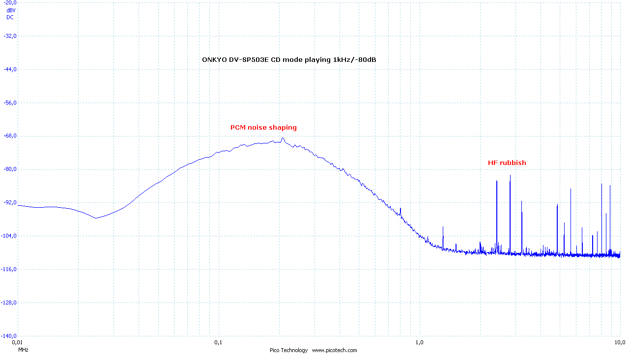

Previous images were with DAC playing no signal (muted). The situation that Richard mentioned becomes obvious with signal, when the DAC output is not muted. 1kHz/-80dB signal was played through ONKYO DV-SP503E in CD mode and SACD mode. Measurement starts at 10kHz, so we can see only noise. Note noise shaping in CD mode and DSD filtered noise in SACD mode. CD mode in fact creates more ultrasonic noise for this player.

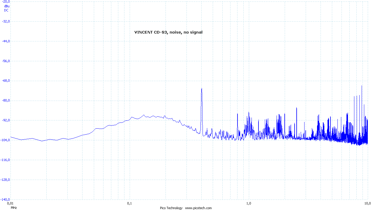

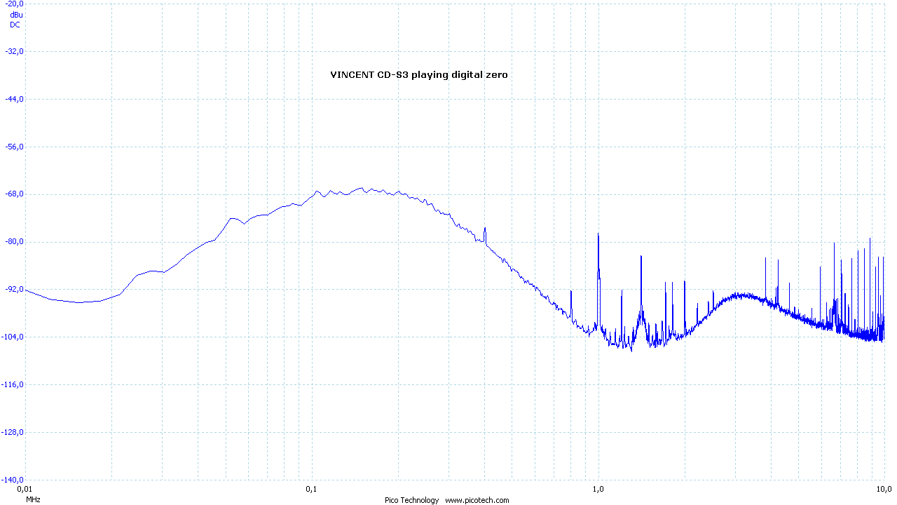

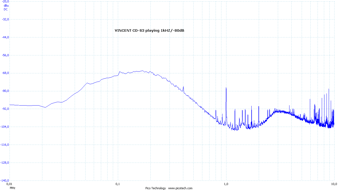

This is Vincent CD-S3 CD player with no signal, playing digital zero and 1kHz/-80dB.
So yes, there is an issue we know about a long time, but e.g. I was not able to make a proper analysis before, because I did not have a suitable instrumentation.

Why should one worry about ultrasonic noise signals whose amplitude is less than a millivolt in the context of normal line levels which are on the order of a volt or more?
Does someone have power amps that are so crappy that they produce audible IM when driven by signals this small and far out of the audio range?
Well, ultrasonic noise is higher in peak amplitude (the spectrum shows only frequency component amplitude at individual frequency) for the ultrasonic noise, i.e. in my measurements it is 20kHz - 1MHz approx. range. It is really "noise". So the Vp is rather in tens of mV. Above 1MHz we can see individual spectral lines of real HF rubbish and then we can quite reliable read the "noise" (not noise >1MHz in fact) amplitude of the MHz interference.
I agree that this should not matter, but IME it is not the case. Some 13 years ago I was quite wondering why there are sound differences between opamps, preamps, you name it. And started to design with respect to HF interferences - and it has helped a lot. Since that time, I have almost no issues with "digital sound", if the recording is good enough. But I did not have measurements good enough, just scope screen (which is not bad, though, only interference quantification is not very exact).
So I agree with you - in case you bear in mind HF interference from the beginning, it should not be a big problem. But it is a problem with many commercial products.
We had another point here, more important, IMO. Close to Fs/2 22kHz reconstruction filters behavior. I am sure that it can create intermodulations not in well designed amplifiers, but in tweeters. Audible intermodulations. And it can be easily proven. I am >60 and do not hear 19kHz, but 1kHz product of 19+20kHz test is audible for everyone and any tweeter always creates it, even if the amplifier has 0.0001% CCIF IMD. So this is the real issue, IMO, not the HF in a well designed component.
One counterpoint is that audio gear, particularly power amps generally has a high frequency roll off above 50 or 100 KHz. Figuring a gentle first order passive filter, response is 20 or more dB down above 1 MHz. So the tens of mV or noise are attenuated back down to the mV range.

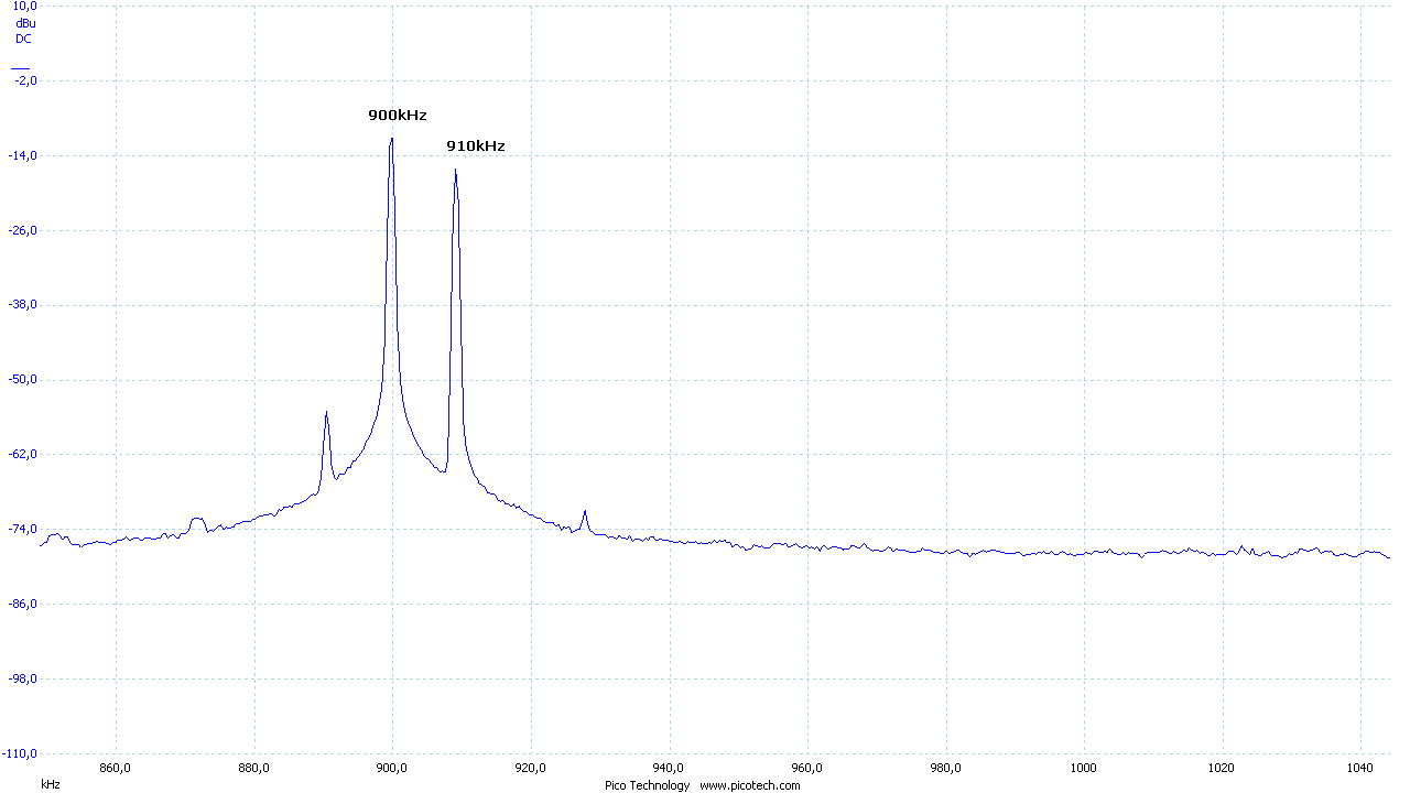

Stuart, the method is simple in theory, but difficult to get trusted results in real world. It is a HF CCIF intermodulation. I have one generator tuned at about 900kHz and the second one about 910kHz. The amplitude of spectral lines can be made similar as in the measured spectra. The test signal would look like attached. The problem is that one of the generators is too non-linear and difference tone 10kHz is created even by the method itself, not by non-linearity under test. So for a moment, I have to resign, but I will try to improve the method in future. Maybe a hint for Richard to try?
