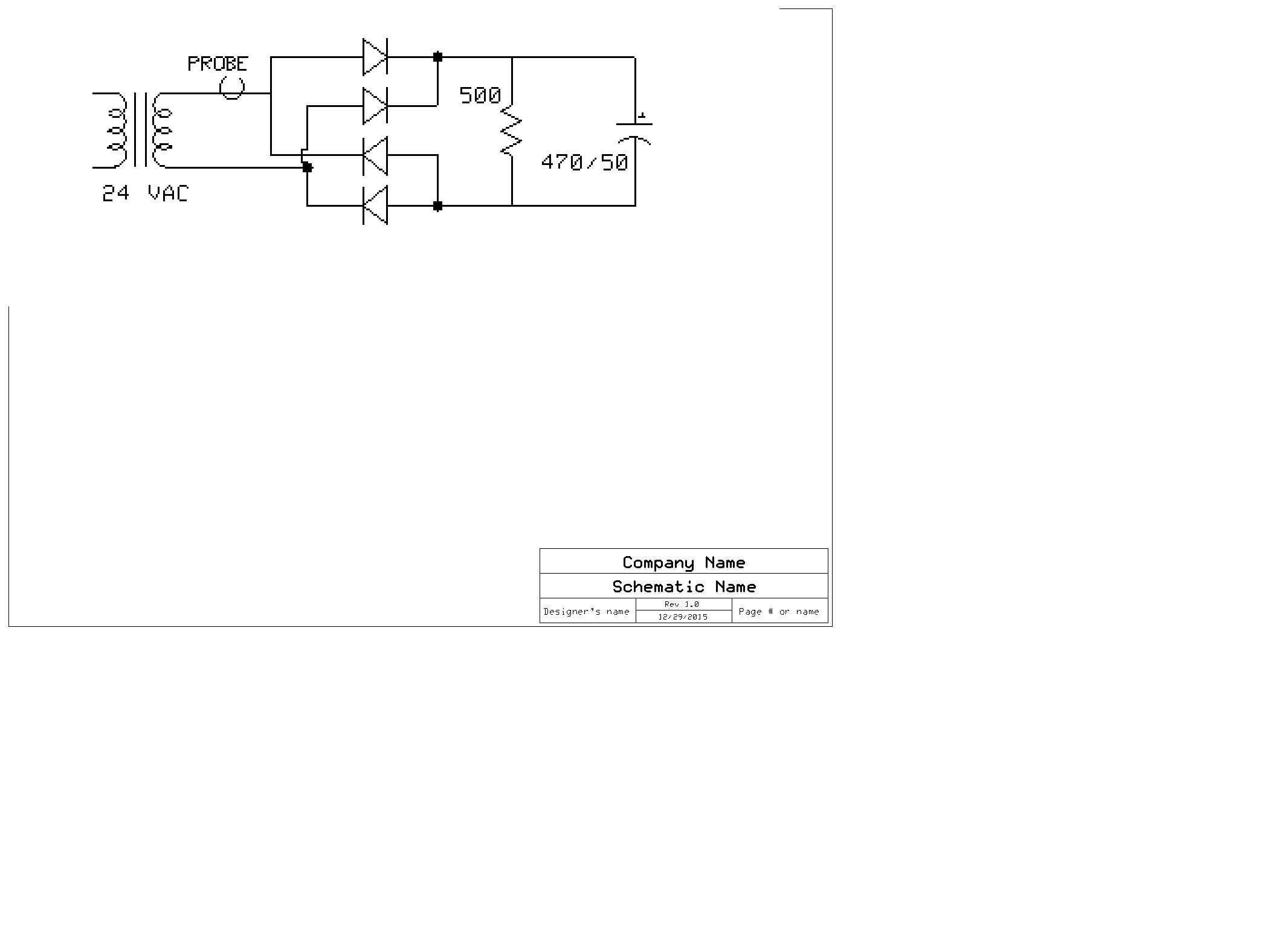

Now for a bit of new old stuff. I am determined to finish my power supply article/book before the end of the year.

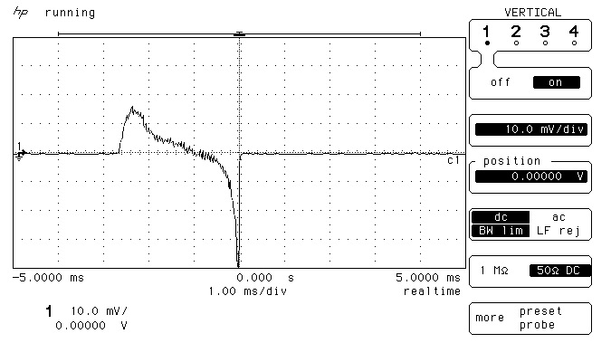

I just redid my diode switching measurements and here is the plot.
It shows the current into the power supply diode bridge. You can see the switch on, the rise in current, tapering off, the noisy switch off spike and even the line noise coming in while the diode is conducting. This was done with a small ferrite core being used for the current transformer.

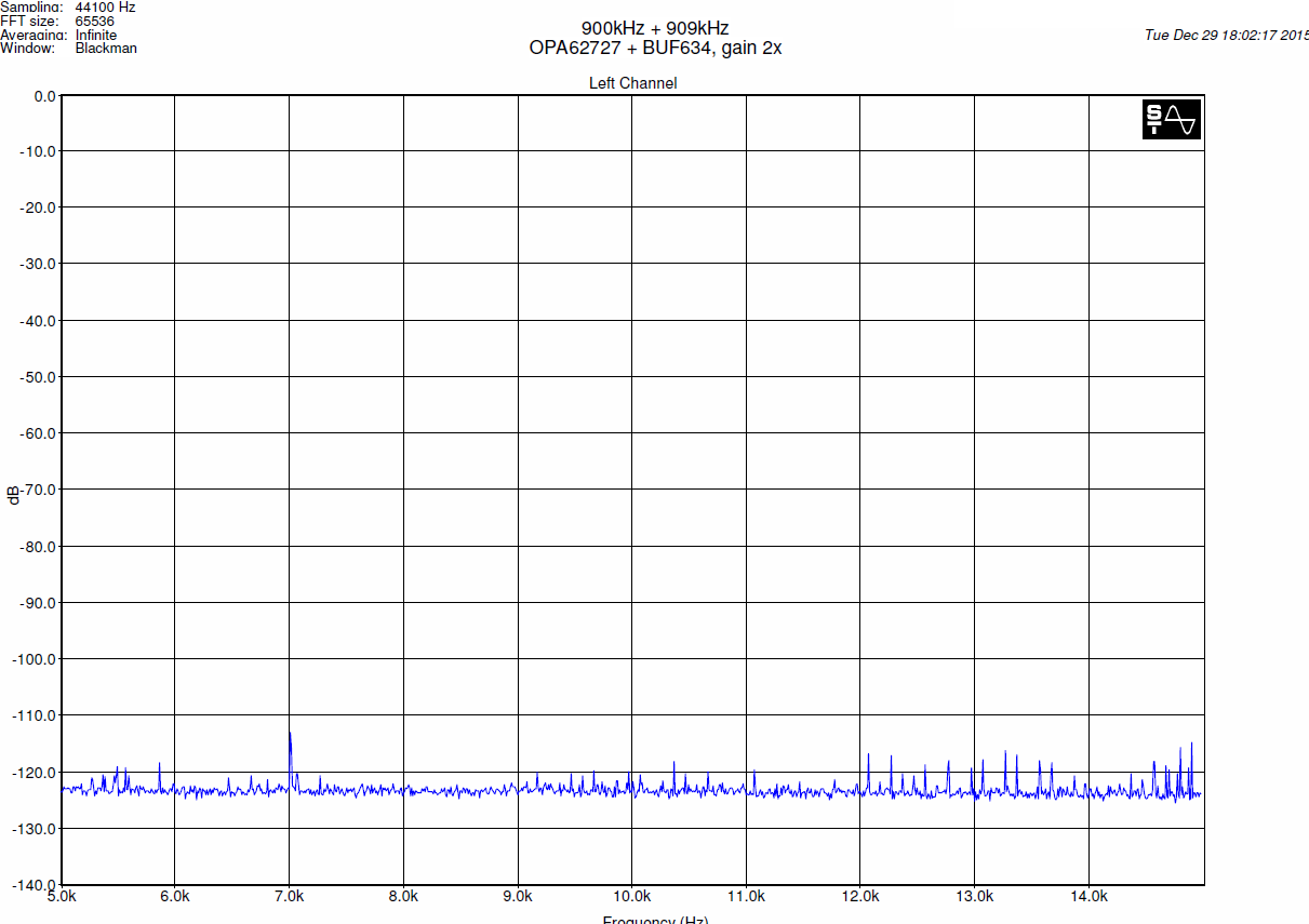

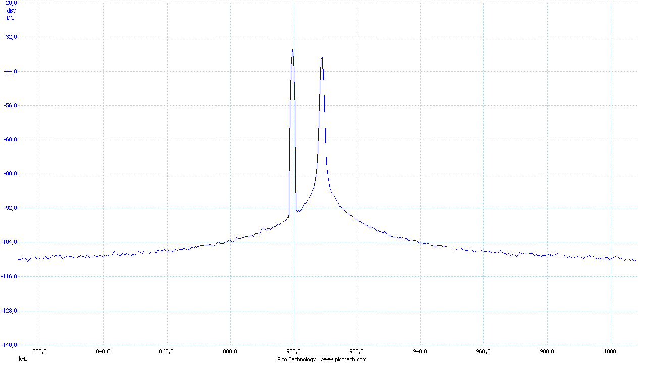

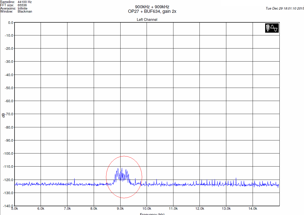

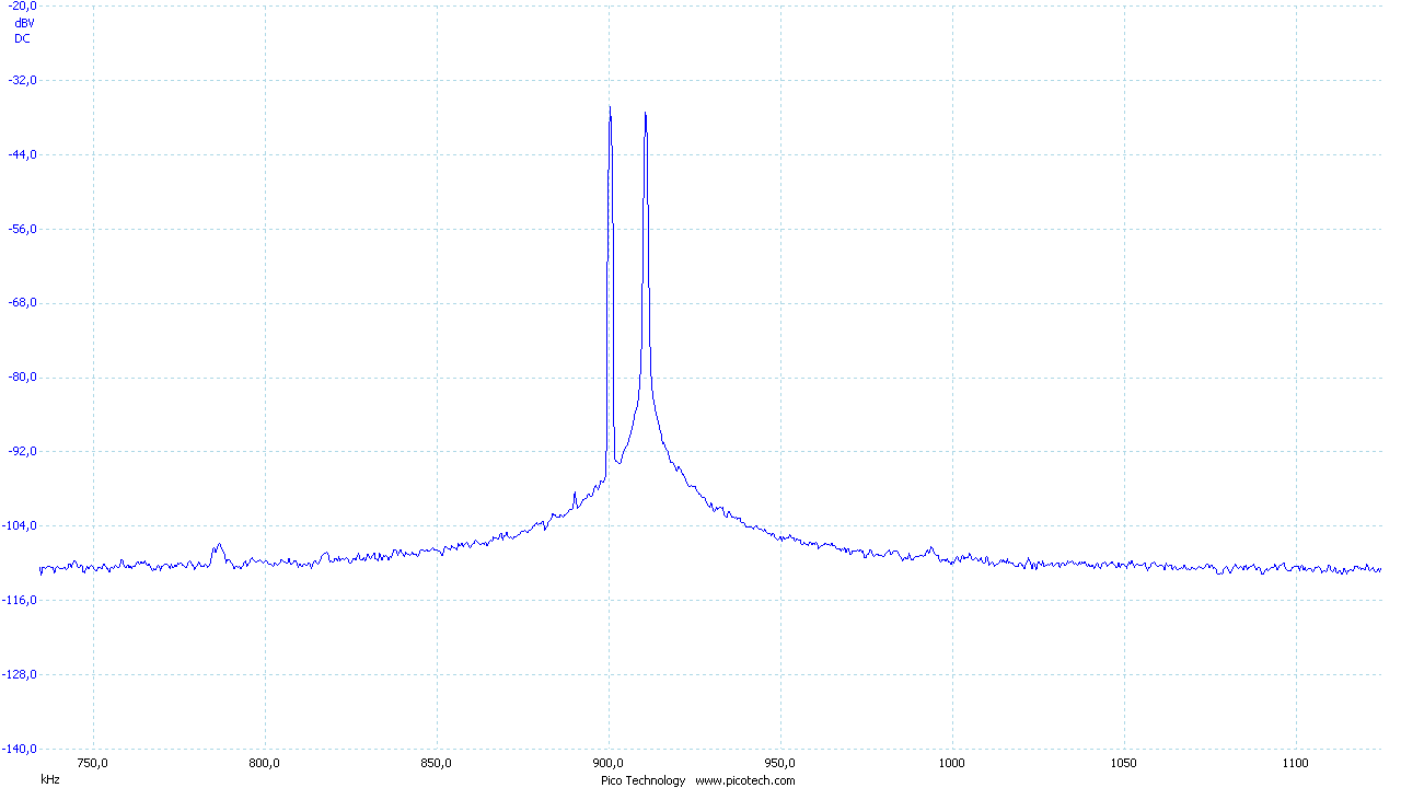

Got, though it is subtle. The tested preamp is opamp + BUF634, gain 2x
1) OPA627+BUF634
2) OP27+BUF634
See test signal (Y scale calibrated) and measurement of OP27 and OPA627 versions (Y scale relative, but same for both versions). There is a difference tone cluster in the OP27 version spectrum, the cluster reveals instability of one of the oscillators. The OPA627 version is free of difference tones.
Behind the preamp there is a 15kHz double RC filter to protect soundcard input from HF frequencies. Without that filter, the soundcard makes its own intermodulation products.
Should be noted that at the preamp input there is a cascade of two RC filters, 680R+68pF and 1k+330pF.

That supports the notion that FET inputs (such as in the OP627) are much less susceptible to HF IM compared to bipolars, which has been my experience as well. And the OP27 is a pretty decent bipolar. I suspect if you were to try a (bipolar) part with considerably lower input stage current you could get a good deal more energy at the difference frequency.
A consultant who did the clean-sheet-of-paper designs of automotive amps for Harman migrated to exclusively-JFET-input amps after a while, as the customers got more and more picky about susceptibility to RF, and while the RF environment got worse and worse.

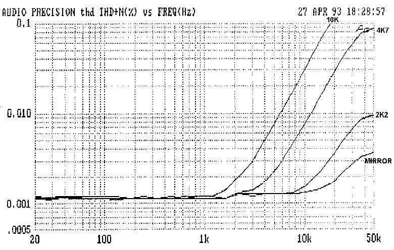

OK. Thats is telling me something about your amplifier. Then it does Not have the rising thd distortion seen in many amps.... it is wide band and low distortion at HF to begin with.
Do you have any amps with the typical rising thd at the high freq. at 20KHz and test one of those for distortion with 50-100KHz HF.
Typical being of this distortion curve shape:
The question I had for myself to answer is the typical GNFB amplifier with its falling nfb and increasing distortion, cause more distortion in audio range when HF is present?

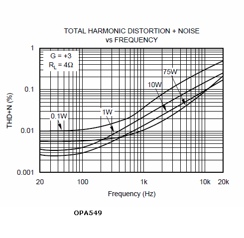

I have some amps that would fail in a HF test. One of them is a chip amp based on OPA549 (power opamp) with high cross-over distortion and very low slew rate (9V/us). It will perform badly, but what does it say? No one today would design an amplifier the way like OPA549, same as no one would use uA741.
I do have one or two another amplifiers that have THD rising with frequency and with not very low distortion, maybe I'll try one of them.

It isnt just old amps... you still see this distortion shape in T&M reviews and in receivers etc. Many do not have low distortion at HF.
Let's contrast those typical curve shapes with a modern amp design that I did for a well known company. This amp barely reaches .005% thd at 250W/8 at 20KHz. Using 80KHz analyzer filter.
I have no HF issues with it or similar.
