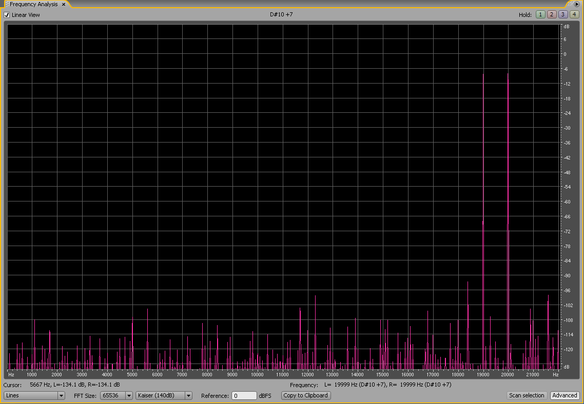

No dither used for the test CD signal generation? It should be clean, normally. This looks like undithered.

I am analyzing a few wav files from CD players done with various excitation waveforms and these two give almost identical FFTs (same equipment, same setup)

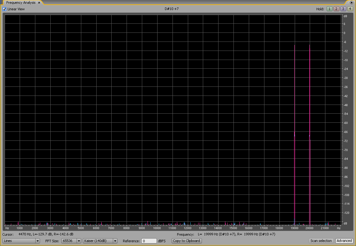

George, links to dithered and undithered signals (to burn to CD, EAC is best, do not use WMA player or similar)
http://pmacura.cz/19+20_dithered.zip
http://pmacura.cz/19+20_undithered.zip

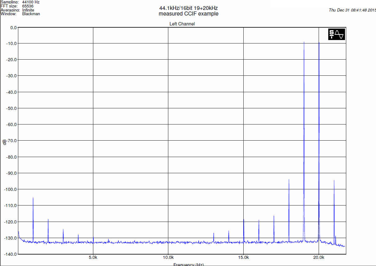

Please see the spectra of the dithered and undithered signal and spectrum of measurement of analog output with dithered 44.1/16 19+20kHz signal. You should see only 19kHz, 20kHz and intermodulation products, that must be only multiples of 1kHz. No quantization error lines, please.

And I was wondering what this repetitive pattern at the FFTs may mean…

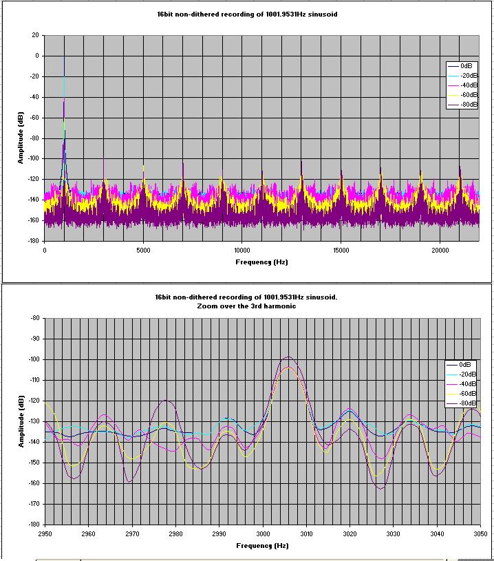

There may be some interesting –useful- outcome in the end by using these non dithered waveforms. I notice some promising strong waviness resulting, waviness of the kind you mentioned in posts # 77184, 77200, 77205, 77215. I’ll look into it later when I compare results using dithered waveforms.

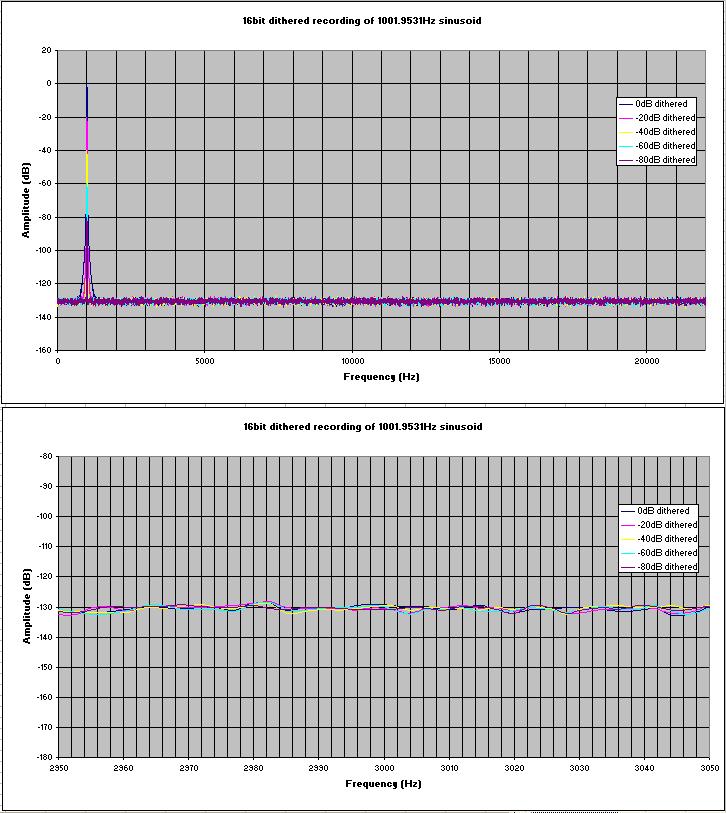

For now, two FFTs from non dithered vs dithered sinuses I had done last Feb ( and this is that really worries me, I should have remembered this. My memory fades away).

It is not the measurement that is dithered, test signal is dithered before burned to CD!!! Every 44.1/16 PCM/wav must be dithered, including music and every mastering step! 40 years ago this was not well recognized and was the source of bad sound of some early digital recordings. Measurement is always the same, independent on dither yes/no of the test signal.
We usually meet the lack of essential knowledge, here. No "better equipment" is able to cure this. If wrongly used, the result is wrong.
