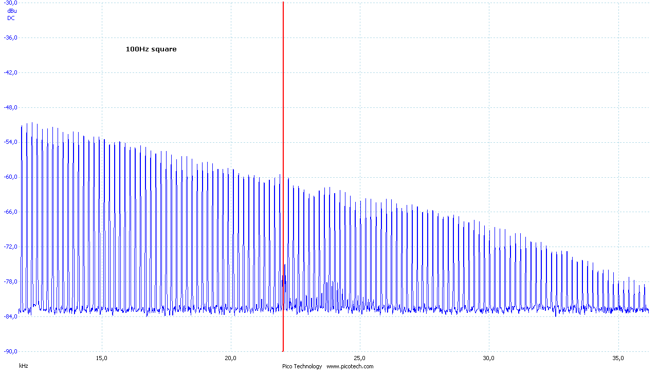

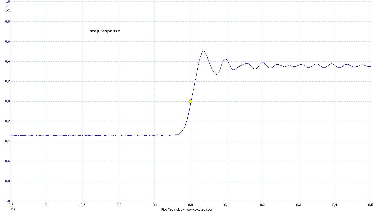

Another example of really poor reconstruction filter. Measured signal is 100Hz (44.1kHz) square at soundcard DAC analog output. Measuring sampling rate is 6.25MHz. The filter may look "OK" visually (no pre-ringing), but as a result there is a train of mirror images.

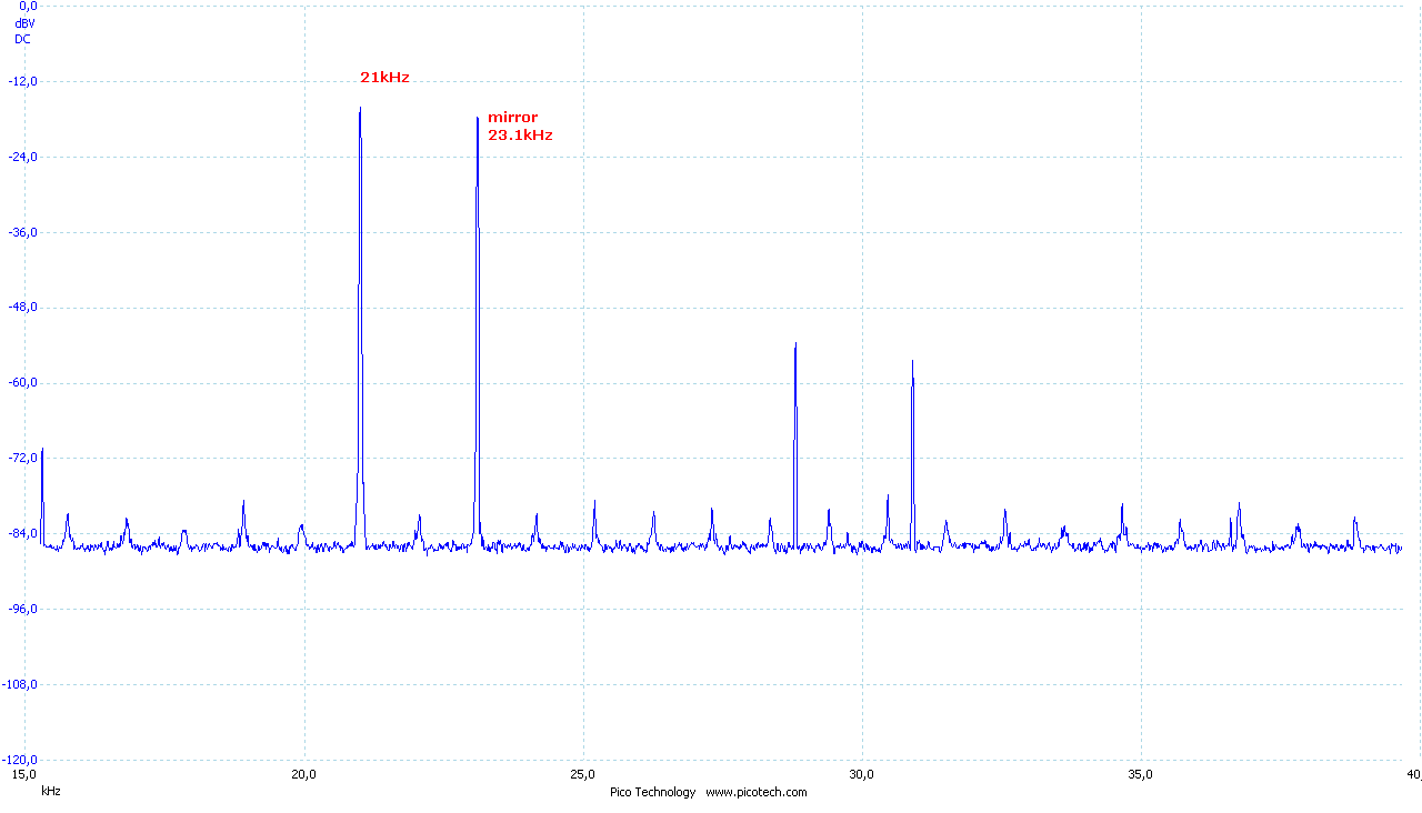

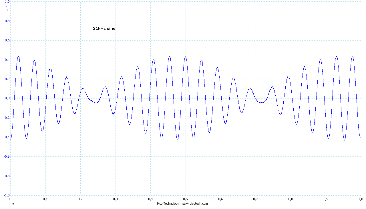

I am sorry, but you did not get it, maybe I was not explaining enough.
1) it is not a result of graphics and it is no simulation. It is an output of sound card digitized with a very fast digitizer. The "modulation" in time domain is another view to twin-tone in frequency domain. The twin-tone is a result of mirror image spectral line, which is 44.1 - 21.5 = 22.6 kHz. This is a result of not enough high steepness of the reconstruction filter. Please check the attached images.
2) everything you wrote about filters is OK, but it is a pure theory. I have measured dozens of CD players and sound cards and I am showing an usual and common behavior of real implementations.
3) it is an Oversampling DAC, quite up to date (AK).
This neatly demonstrates why avoiding the output filter, or not making it steep enough in order to minimize ringing simply leaves one with Nyqvist related problems. Better to go for 24/192, accept the slightly higher noise floor and be done with it.

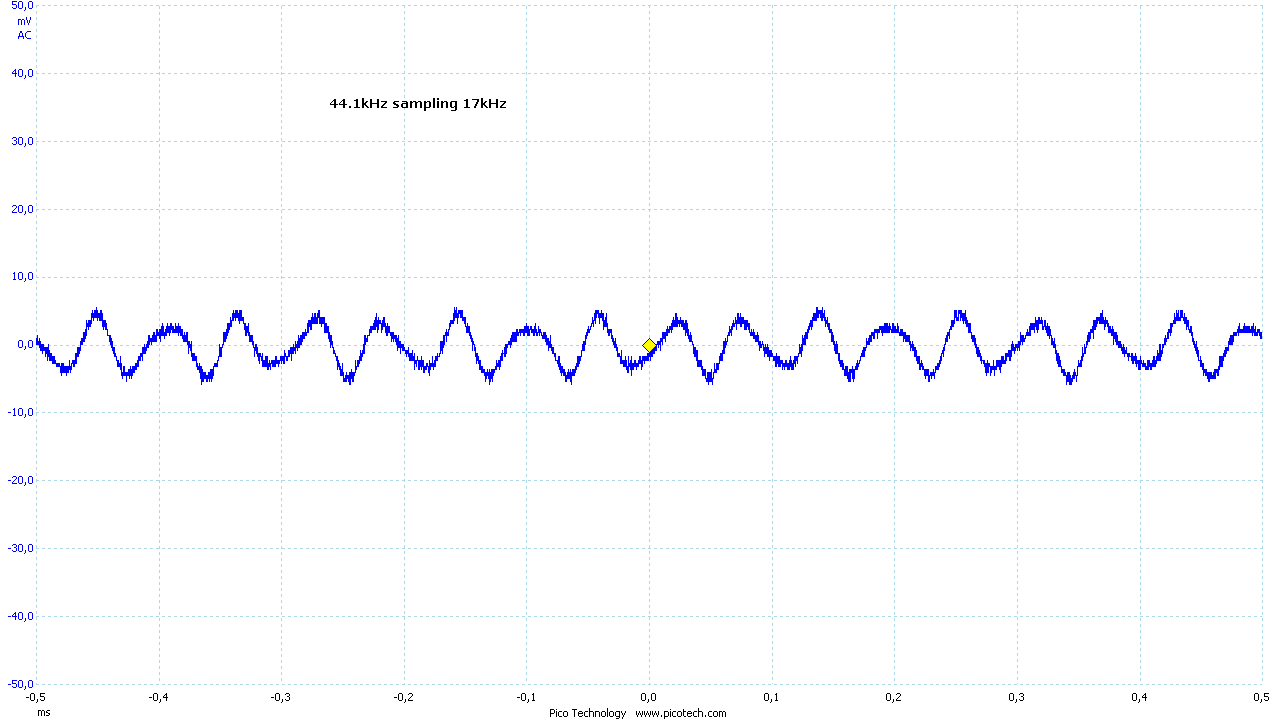

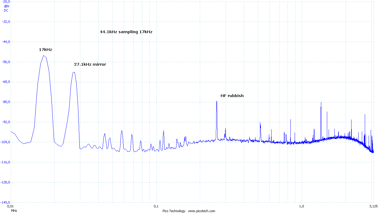

Reconstruction in real world is really an issue. Last one, it is a small signal 17kHz (i.e. audio signal) in 44.1kHz sampling. The reconstruction filter is very poor (but no pre-ringing!!! 😀 😀) and also please note HF interferences in MHz, at the analog output.
As said several times, let's go higher sampling rates to have enough margin for audio band signals.
Someone might say "no problem, inaudible". But please think about intermodulation products in tweeters and I can guarantee these examples will and do create audible intermodulation products in tweeters.

Not really - the explanation for the apparent modulation of signals whose frequency are very close to the Nyquist frequency comes out of modulation theory. Basically we are moving from AM to SSB.
Once again - the reason of "modulation" is a mirror image, F(sampling) - F(signal). Close to Fs/2 signals, reconstruction non-ideal brickwall is unable to avoid mirrors. Mirror makes a twin-tone (similar to 19+20kHz CCIF test tone) and this causes "modulation" with frequency F(signal) - F(mirror).

I believe I got it, hehe😉. That is a problem of interpretation and communication only. Any interpretation based on spectral is a pure theory, because the "spectrum" doesn't exist in reality, this is only an other way to describe the signal, which is primarily described by its time run. The "mirror" component shown is an inevitable product of sampling at 44.1 kHz. If reconstructed properly, this component will not be present in the resulting signal. This is - according the theory - possible only if an ideal brickwall filter is used, or, more generally, an filter achieving infinitely big attenuation above certain frequency being lower than a half of the sampling frequency. In fact you said this. If something like "modulation" or "mirror" is observed, than this is a consequence of the imperfection of the filter. You did say it, too. And, this match with the theory exactly, if applied properly. The only difference between our interpretations is that I say the modulation or mirrors described in the digital domain are the inevitable product of sampling, so they are artifacts, existing in digital domain only, which existence can be proved basing on the certain interpretation of the signal structure only and which are not returned into analog domain if reconstructed properly.
The fundamental problem is the all real signals are continuous, the digitalization is an purely analog process and the "digital signal" is a mathematical fiction in fact, a subject of certain interpretation only. No doubt this interpretation is very useful, but it is necessary to bear in mind its limits.:hohoho:
