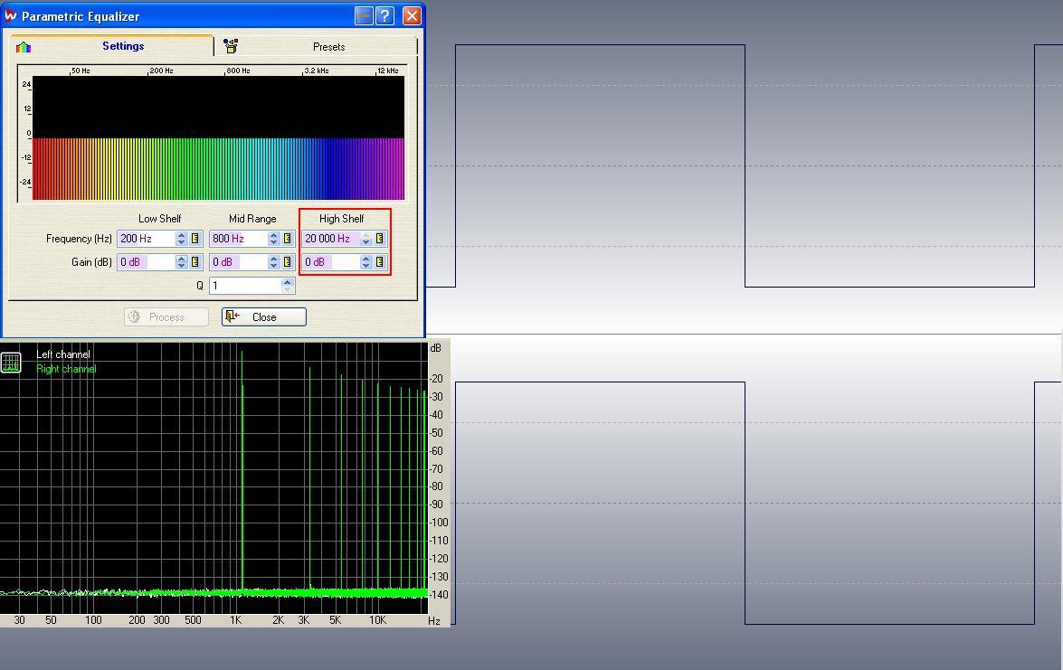

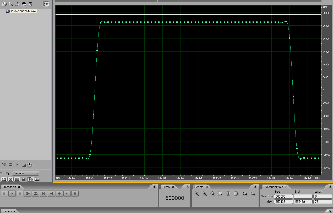

The Gibbs ringing is just a function of a step response (as in square wave) low pass filtered. Having it is correct, the maths insists on it. It is not causing the HF noise you are seeing, which 'may' cause issues down stream that is worth filtering out. For me its whether any effect can be measured that is interesting.
That Gebb phenomenon ripple occures when you have an input signal BW or Tr that is faster than the ADC/DAC system. When you filter the input transistion times down slower the "ripple" reduces. I can watch this happen because I can vary the Tr and Tf of the step transition of the sq wave via the HP-3012B controls.

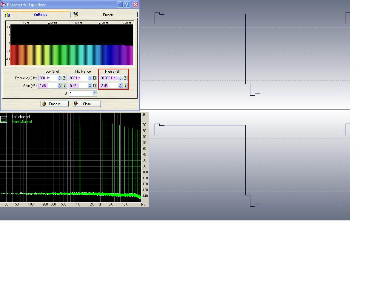

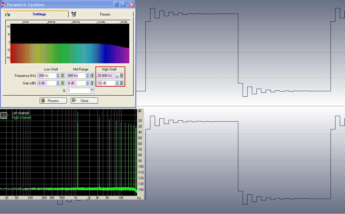

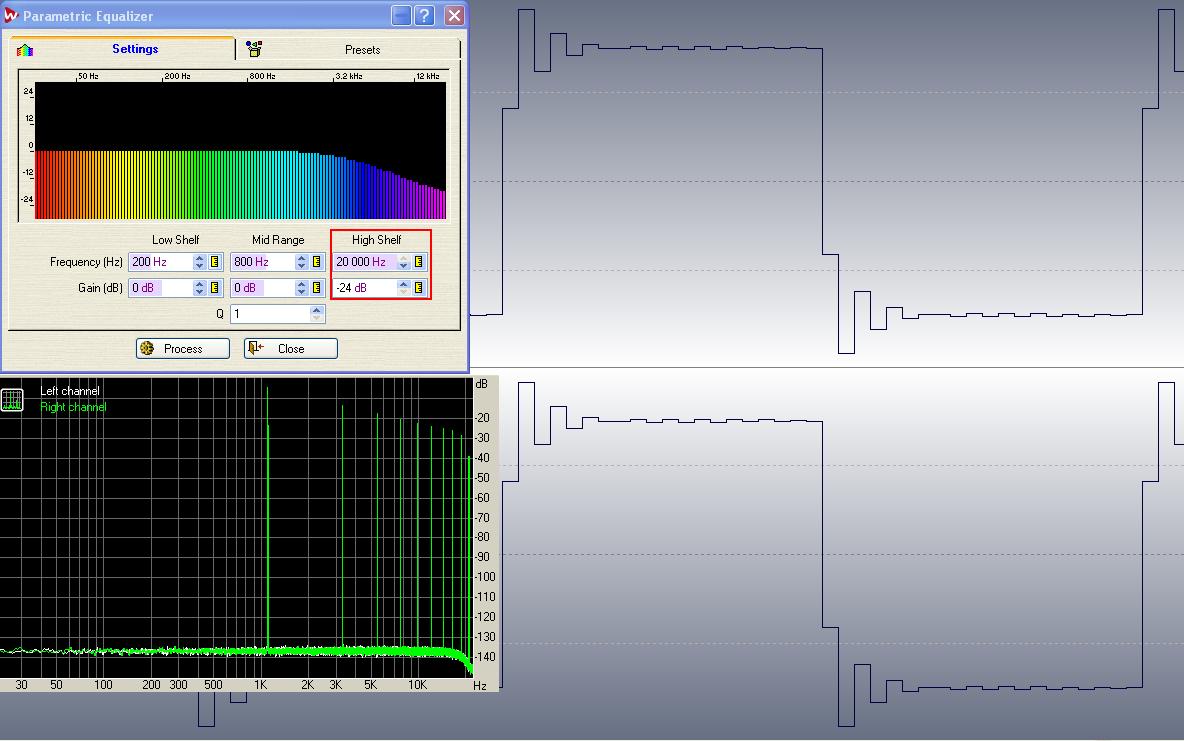

I was confused from the beginning when you said that HF limiting the output of the DAC for to reduce the out of band noise, reduces at the same time the sqw waviness as well.
The opposite is true regarding sqw waviness. The more HF limiting we apply at the DAC output, the less out of band noise comes out of course but then and due to HF limiting, the more waviness is observed on the square wave tops & bottoms. This is the Gibbs phenomenon
I know that. Again. I know that. I still found it useful indicator of where the best place to put my filter cut-off along with the spect analyzer data. it will give you the best compromise freq. for your filter design.
