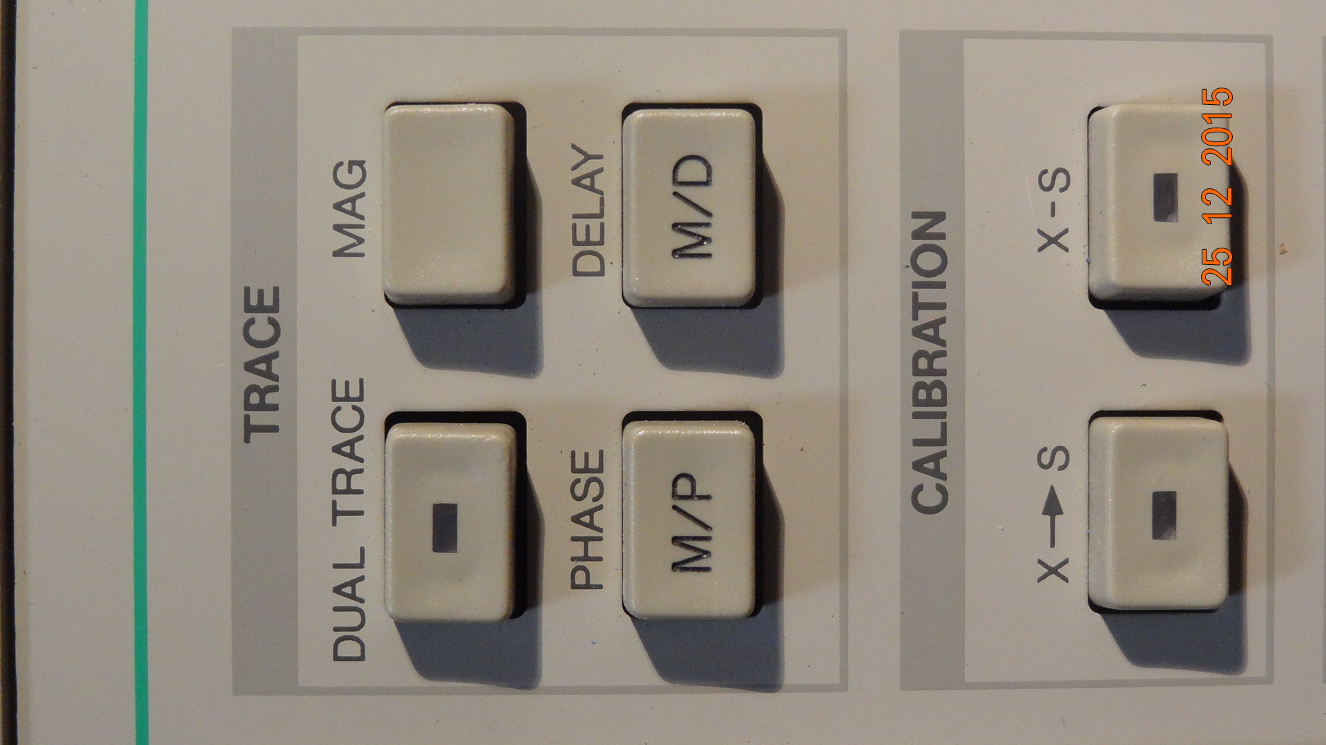

I think I found and explained a good way to find the best compromise for filter cut-off with a given recorder/player.
I do not know how many people out there can measure GD or design GD correction filters. But the results i hear is promising and worthwhile.
A DIY variable group delay equalizer would be nice to see. I used such equipment with the military to condition data lines. Wish there were some consumer PRO versions today.

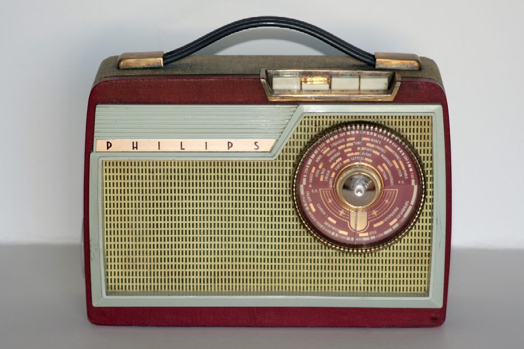

Yes, it is Christmas and the beatles are now available to listen in streaming.
Remastered, I dicovered a lot of details I never heard before (HF filtered or not).
A lot of details, but, Oh, Lord, the magic is gone. Or my youthfulness with my old transistor radio (Germanium) ?

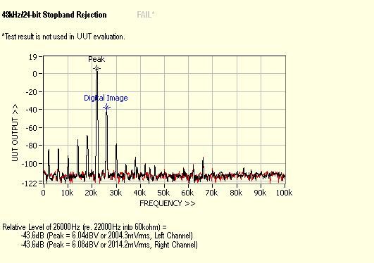

When you are dealing with a situation like I had..... a less than ideal filtering situation, besides the HF removal, you can measure GD and with that info, start a correction process.
I am re-listening with the added filter... WoW!. That flat dull sound is gone and much more life-like and clear/focused. I think I am going to listen to music all day today.
I am so impressed with the result, I am not taking it out and have another ML-9600 coming to keep for R&D and more tests. I also have an OPPO 105D coming..... will check it as well.

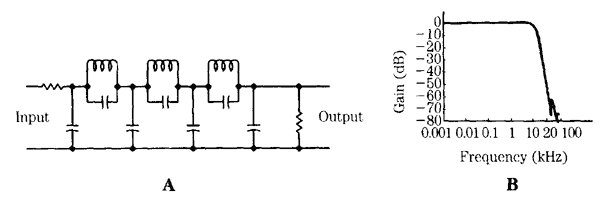

Does-it applies to an analog signal (out of a DAC), with analog filter ?
Yes, because the Gibbs Phenomena is due to the mathematics that is common to all brick wall filters, whether analog or digital.
The last CD Player or DAC that I know of that had analog brick wall filters was the CDP 101 (1983). Some editions of its service manual had schematics of the brick wall filters, which looked something like this:
Only with a lot more stages of filtering - I think about 20! Even with all that complexity and expense, its performance was relatively poor compared to the digital filters that followed it.
You can find out more information about brick wall filters here:
http://www.analog.com/library/analogDialogue/archives/43-09/EDCh%208%20filter.pdf?doc=ADA4666-2.pdf
