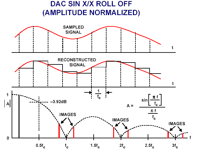

You need a brickwall LPF before Fs/2 (in a non-oversampling case) after the DAC even if the input is perfectly band-limited. Nyquist-Shannon does not work without a reconstruction filter.
The DAC output is going to be a series of steps, no matter what. That needs to be filtered to produce the original input.
That's where 8X oversampling helps. I mean real ones, calculating intermediate values. Then, an softer low pass filter with a trap at 8X Fs will be enough to smooth the curve.
