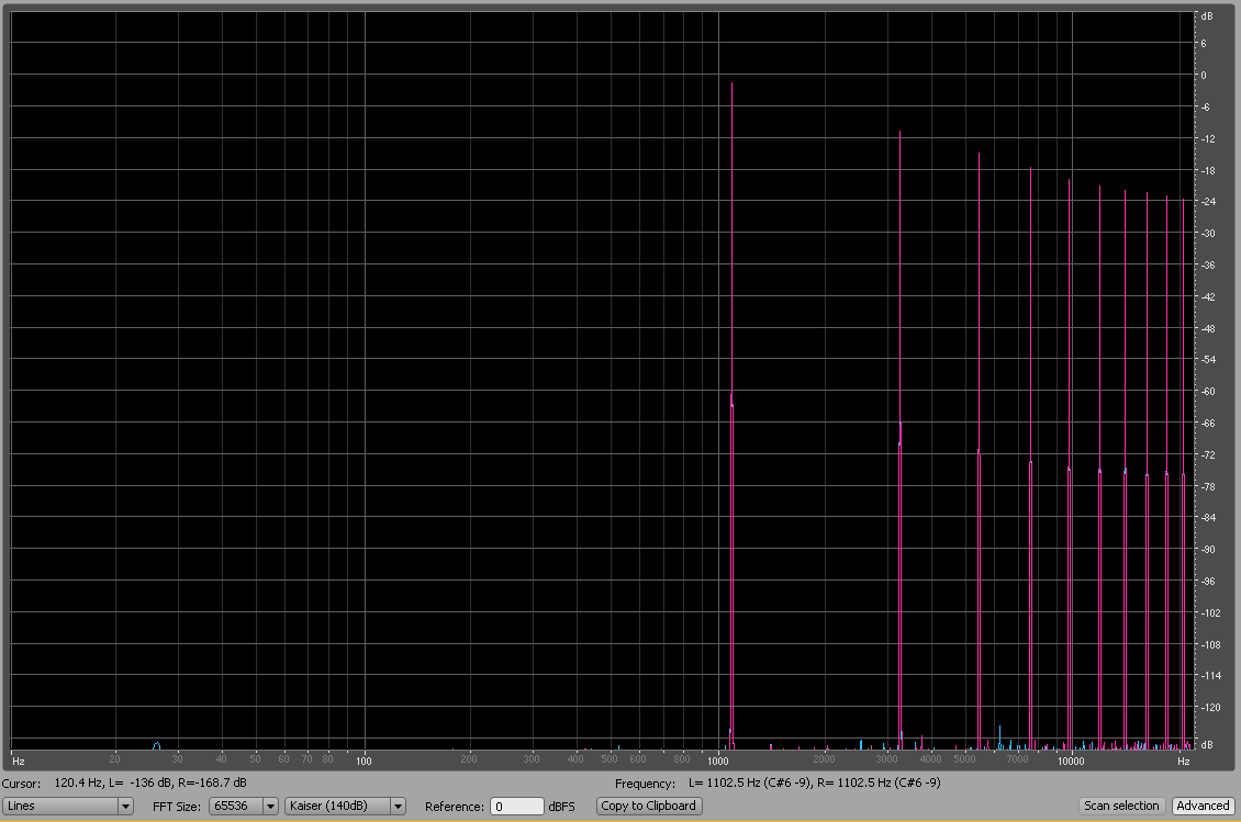

The truth is that DSD signal with enormous HF content is very clean in audio band, like this -120dB FS signal.
That's what I would have guessed, but I don't have a DSD to test it on, and one could argue that my electronics designs aren't fazed by HF but are somehow atypical. Presumably, the sound card you used doesn't have exotic analog circuits?

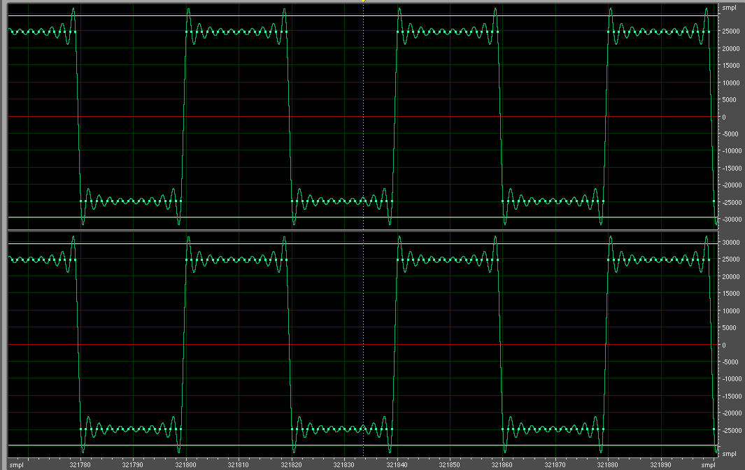

A file for Richard to burn onto CD 🙂
Yes, a 16bit reference square, created by software without any ADC involved. Should do the trick 😉

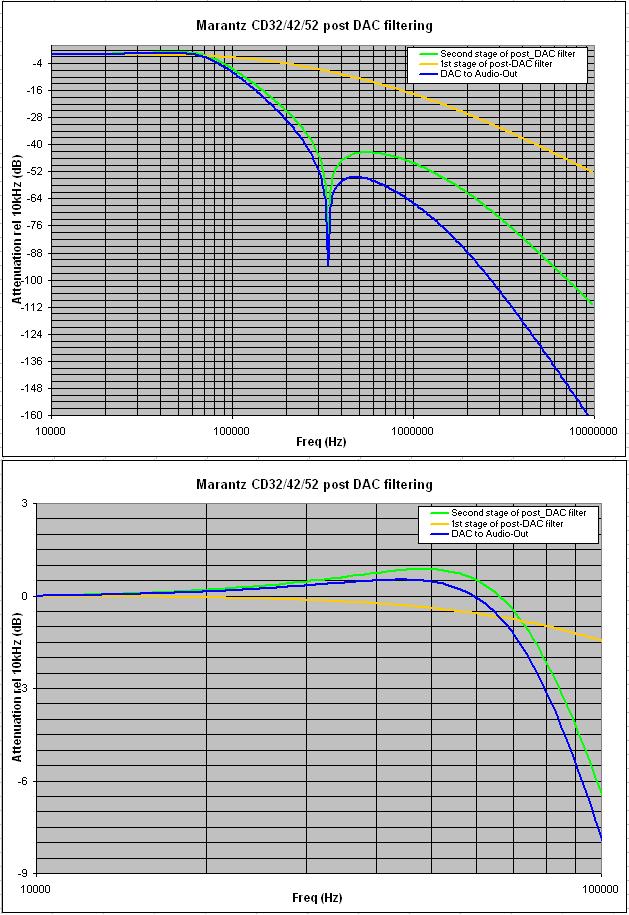

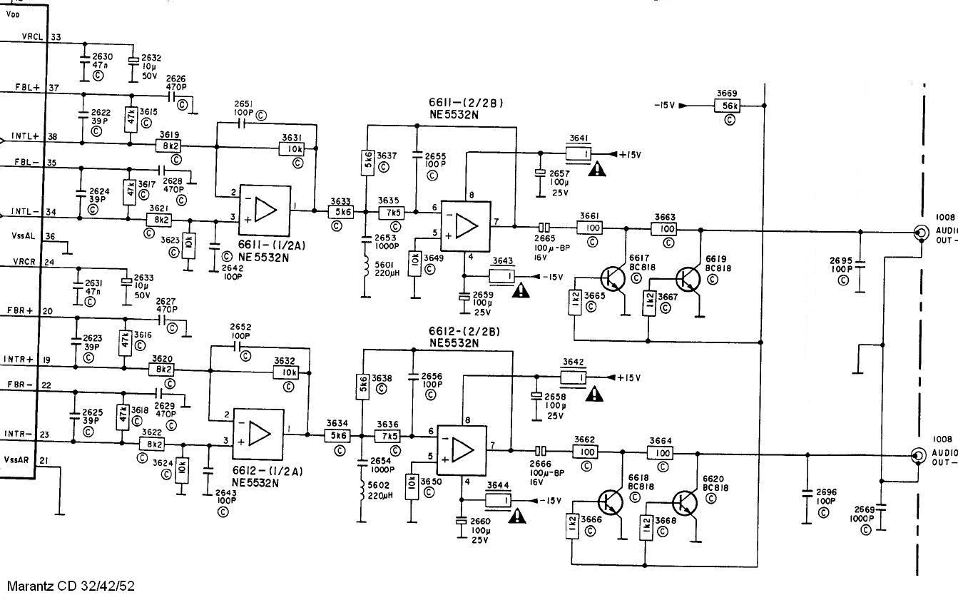

This is strange. I have yet to see a single CD player in the mid/low price range that is build without a post DAC analog LP filter (at least a copy from DAC’s application data sheet)
Some background info if you find the ripple and HF noise on your analog output:
https://www.maximintegrated.com/en/app-notes/index.mvp/id/3853
Thanks for the link. I didn’t know that the “zero order hold” has an effect of a sinc function (an LP filter)
The “active equalizer” shown in Figure 7a is a simple 6dB/oct LP filter (with the values shown –3db at 1.8MHz) and is not an analog filter whose frequency response is approximately equal to the inverse of the sinc function. What do I miss?
