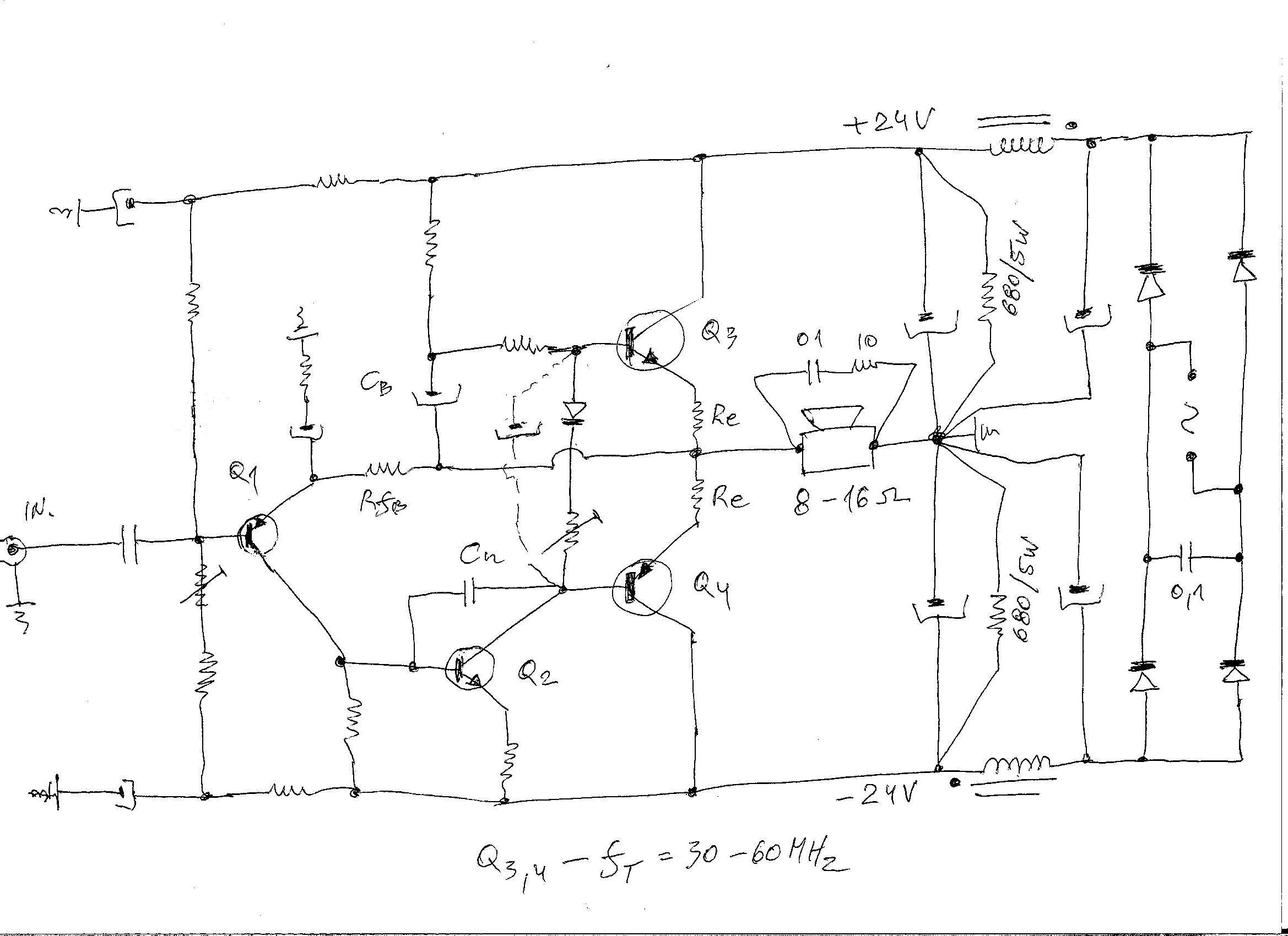

By all accounts, the simplest decent sounding amp - albeit low power - has to be JLH's 10 watter - but in the split rail version (Richard, this is less than the idle power on your amps . . . 😉
Even NP was impressed . . .
Hi Bonsai !
I wonder why nobody have tried to made that simple JLH 10 - 15 W A class amp variant but now using modern very fast complementary BJT OPS , using same simple JLH topology with only four BJT supplied from split rail PSU ?
Regards !

Hi Jacco !
I know that NP article , it is just one very good variation of old JLH idea/ A class amp design, which basically is SS translation of Williamson tube amp ,
My idea is different , simple singleton 10-15W A class amp without BJT phase spliter , which relay on modern very fast complementary power BJTs for OPS , here is the rough basic schematic .
(Note , there is no CT on secondary coil of main power Transf. , just virtual floating ground formed with two 680R power res.)
