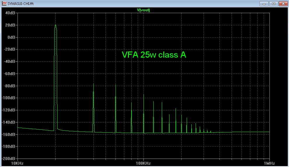

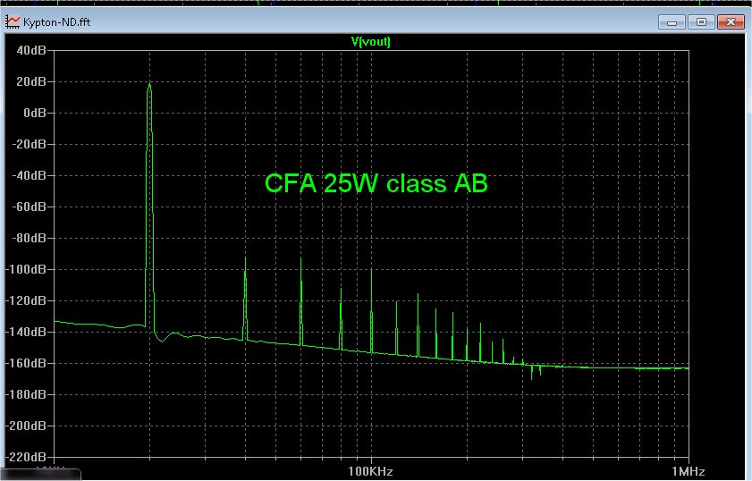

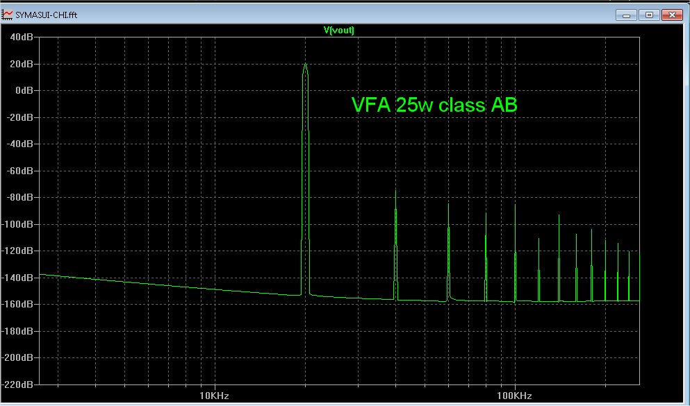

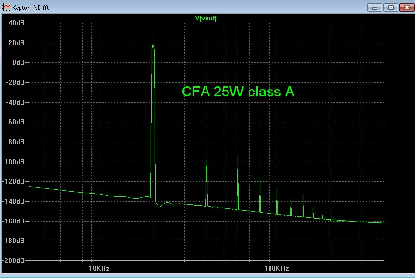

I went a bit further and compared 2 amps -
Both are -
-about 65db CLG at LF , had to simulate at 25W so I could run either class
A or AB.
Two low gain amps , one is a symasym and the other a NAD CFA (with the diamond).
The first 2 (1/2 attached) are the CFA. Second 2 (3/4 attached) are
the VFA.
The CFA , besides cancelling harmonics without AB artifacts , seems to
suppress them quite well while in AB.
The VFA gets much worse doing the same simulation. You can improve
the VFA with more bias in AB .... but it can't match the CFA.
On the real amps , I could not see the X-over "glitch" on the CFA at 0
ma. I could easily see it on the VFA.
You called it "suppression" - I understand you cannot correct the
non-linearity at the X-over region with just FB.
But , "suppression" is something desirable .... at least for measurement.
This is just a curiosity with these two designs .... the sound of
both these input stages is MUCH more that adequate (no fatigue with
either).
OS
