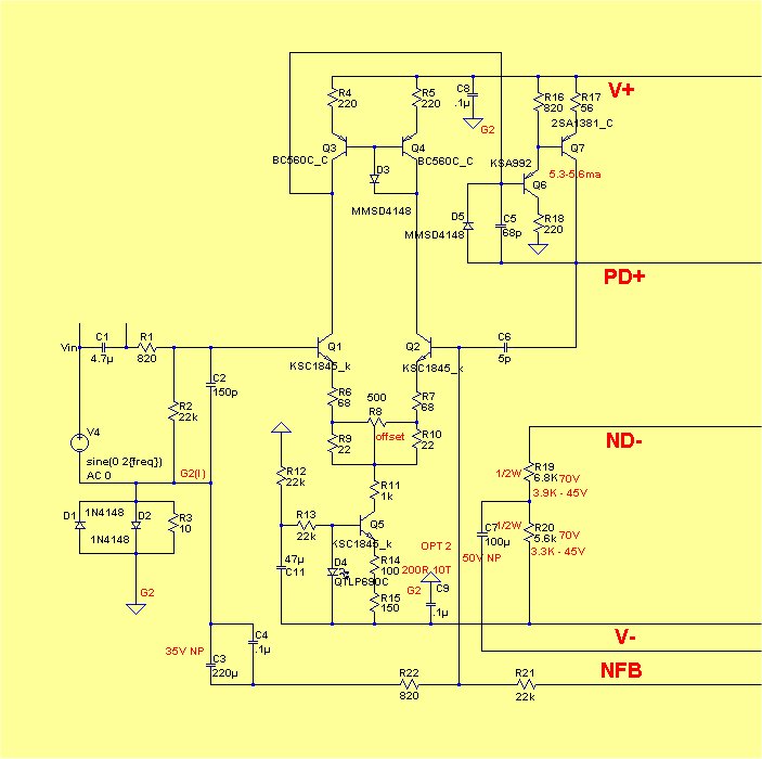

That many can do much better than that. I assume you're including all transistors for a single channel? An AKSA style amp might beat that twice over at 7 transistors per channel.
Having posted that Dyna schemo, this would actually be a potentially interesting game.
But when small signal transistors are very inexpensive, unless you believe in the numerosity/complexity dogmas, use what you need. It certainly isn't about cost, and well-considered, it usually isn't about diminished reliability.
And be nice to them, and perhaps they will be cooperative. Yes it is a bit late.
A "dogpile" design will do 20-30ppm (below).
7 devices + 5 for a EF2 = >30ppm 20k.
7 devices + 7-9 for a more powerful EF3 = <20ppm.
That circuit with a pair of MT-200's/EF3 would trump any typical
department store offering.

The amp Richard mentioned use 10 transistors in the IPS, 12 transistors in the OPS (two pairs of drivers and four pairs of output transistors), 4 transistors used as a CCS and 2 for the bias spreader. All that to get 220 W/8 ohm before clipping, I would say that is not so many of active devices for the power and quality of the sound it can deliver.
Damir
The number of transistors I mentioned vs distortion is a general guideline. Note the test frequency.
OS, what's the HF loop gain on your two amps? Are they the same?
It's interesting how the harmonic structure is different. With VAS loading, you can tune the balance between the seconds and thirds.
