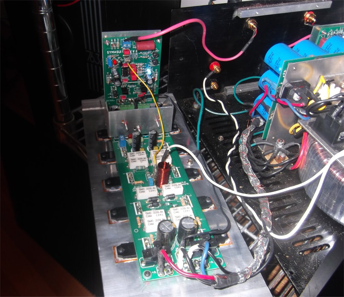

The Symasym was the amplifier I was talking about. When others used similar matching and good output transistors their results were very similar to mine. That silly little amplifier sounds really good. I was looking for a utility amplifier around 50 wpc when I decided to build that one, it exceeded expectations on all counts. I can hardly wait to try one of yours (building up funds).
-Chris
Well , buy up some of those cheap MT-200's at digikey (while they last).
(below) that is the forums biggest symasym , you can set it up with
the MT's for 400 watts (OMG).
Had to cascode the original sym differential +VAS, and servo it to
swing 150V P-P.
"silly little amp" ? .... the original is very close to the HK680 , one of the best
reviewed <1K$ amps out there.
It was the last of my creations I built in july , I'm still liking it - MUCH !
OS

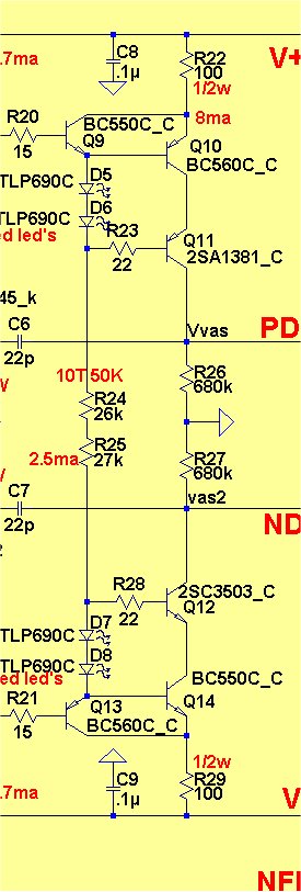

PS - I've seen a 400W clip on this Baxandall ,I can't understand why
"high -end" OEM's have not used this VAS on 3K$ amps yet - it is superior.
edit - why not this on any pass or parasound amp ? (below).
My tests show it to be quite unique .....
OS

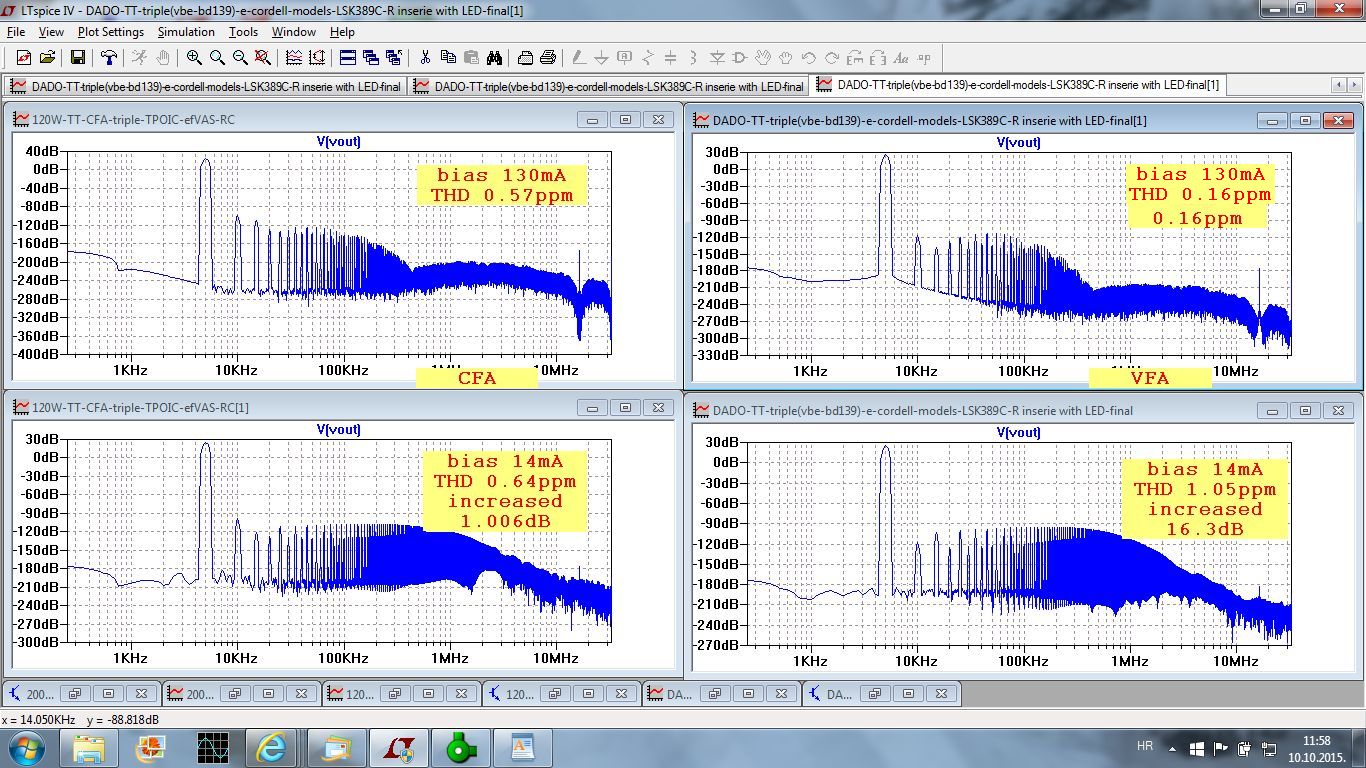

In fact , the current CFA "fetish" is quite easily explained. A >200V/uS
slew seems to error correct the AB X-over glitch down to nearly
class B (no bias). THD will stay PPM right down to 10ma on one of
my "kypton ND" input stages.
OS
How did you come to that?
I just reduced bias and tested 1k thd. The oliver bias conditions do
not apply to fast CFA's and Japanese sankens.
OS
OS
"A >200V/uS slew seems to error correct the AB X-over glitch "
My question was about that, not Oliver bias conditions...
What I found was high SR in particular sounded more accurate even if the THD was increased.
Figure that out.
THx-RNMarsh
Figure that out.
THx-RNMarsh
That is what I also discovered , some designs exhibit their lowest THD
at what would be considered a non-optimal class AB bias.
Symasym and other current (VFA) input stages have a lot longer group delay -
they are not fast enough to do this , and need a stronger 60-
75ma bias to "bottom out" (THD wise).
OS

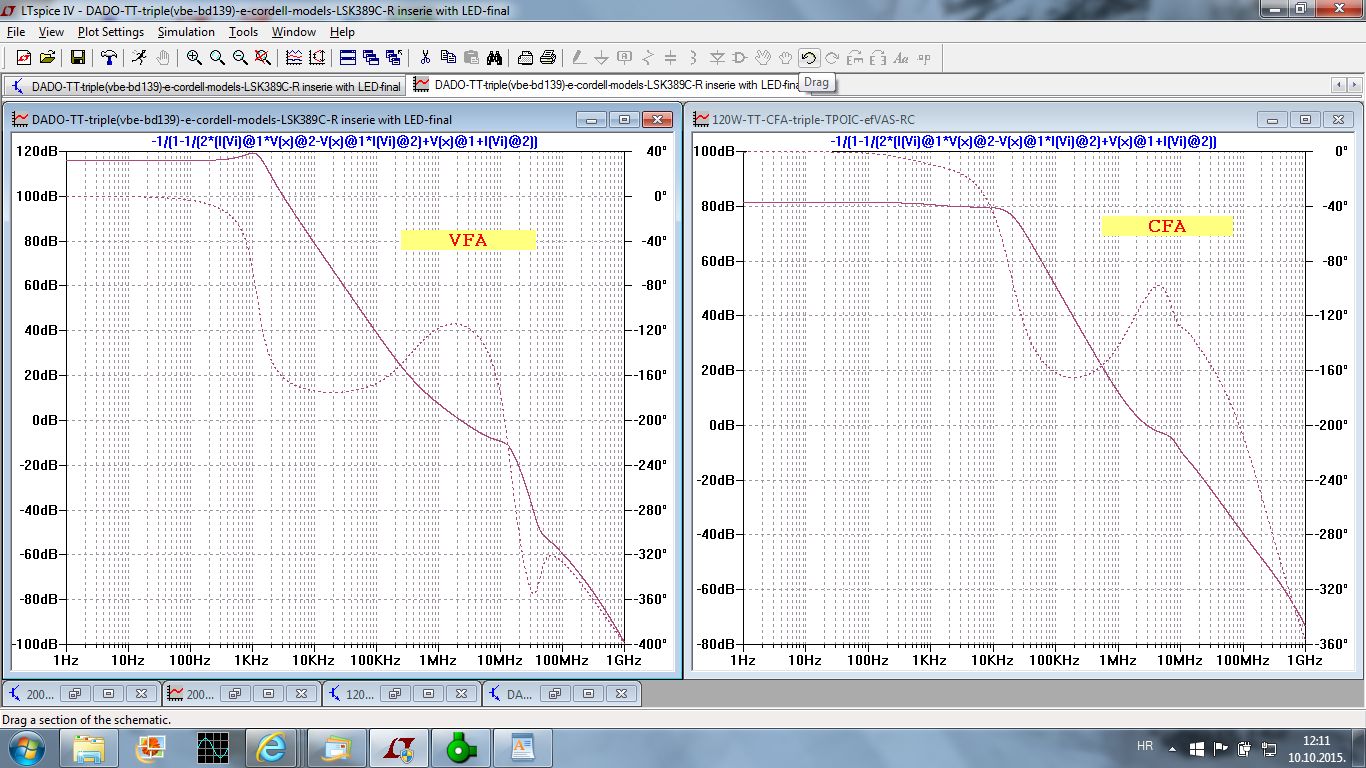

The available NFB at high frequency can make optimal bias not so important, not Slew Rate.
Simulated two amps with same OPS (ThermalTrak), one VFA with quite high Slew Rate (more then 200V/usec) and one CFA with higher Slew Rate (abut 400V/usec) and very different Loop Gain plots. The VFA with high gain of 117 dB up to 1kHz but then goes down, and the CFA with 80 dB up to 20 kHz.
The FFTs with optimal and suboptimal bias shows that.
No SR is doing that.
Damir
I found the same ;-)What I found was high SR in particular sounded more accurate even if the THD was increased.
Figure that out.
Tried some explanations. No one is really convincing on an intellectual point of view. The overkill slew rate ? The expansive behavior ? Current on demand ? The little extended flat phase bandwidth in closed loop ?
One thing is sure (for me), CFAs sound more fluid, natural, easy listening, specially in the long run (less fatigue) than the same devices arrangements (same VFA and OS) in VFA.
May-I request international support against the fundamentalist horde of LTP's fundamentalists that will surely melt on me like a grasshopper's rain ?
