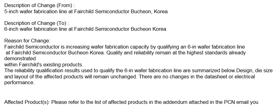

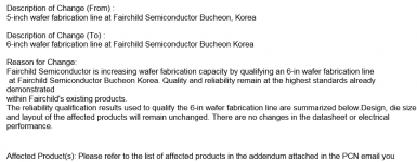

I just got a notice from Mouser that there's a Product Change Notification on a Fairchild "Soft Recovery diode" I recently purchased. It's a fairly new and fairly high tech diode
  • 30 amps
  • 200 volts
  • Recovery softness factor (tb/ta) is spec'd and guaranteed: 0.6
The datasheet (link) is Copyright 2008.
The PCN says that they are upgrading the fab, from 5 inch wafers to 6 inch wafers. Oh by the way, MOS LSI made the 5 inch to 6 inch transition in the late 1980s -- twenty five years ago!! I imagine Fairchild's capital equipment must be fully depreciated by now.
