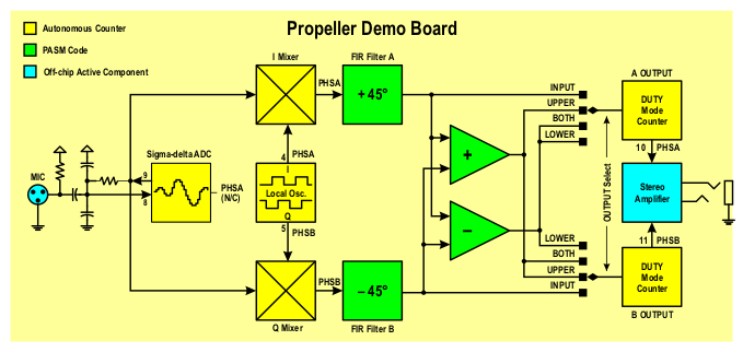

Folks,
I am having an off day. I want to build a frequency shifter in analog. I have a sine-cosine oscillator, a buffered signal, a 90 degree phase shifted signal, multipliers and summing amps. All I want is the lower shifted band. I have done this before but my memory has failed me today. Anyone want to refresh it?
