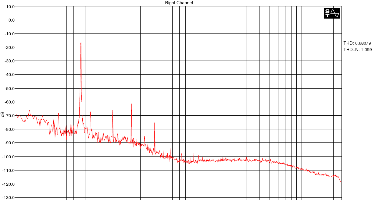

Regarding Bob's question on higher harmonics in vinyl distortion, maybe it is also a question of distortion of the vinyl measurement record cut (and of course a question of cm/s), here is another plot, with harmonics only up to 4th:
