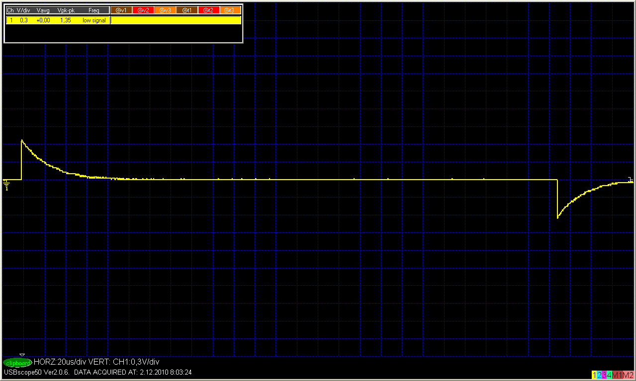

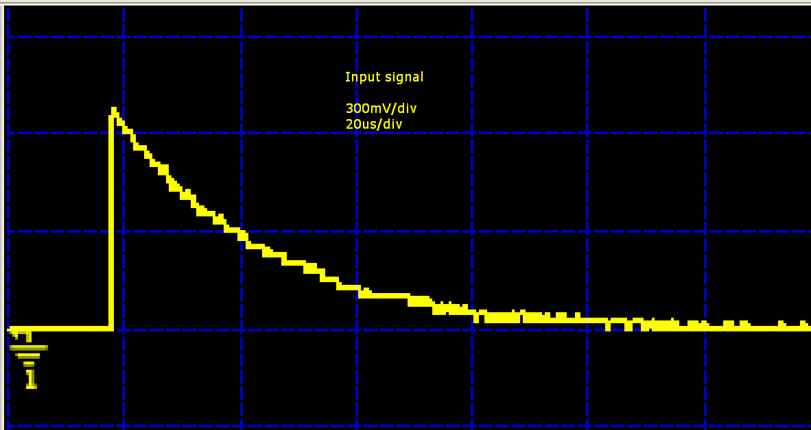

To fix it, only needs a simple high frequency roll-off.
Maybe there is one somewhere in your system anyway, so it's OK.
edit: This is just a simple paint drawing - not very accurate.😱

Please look at Fig.7. It is a calibrated 5us/div in the horizontal plane. You are now showing 20us/div. Why not tighten up your scale so we can more easily compare?
By definition, you should be able to reproduce a good 10us rise-time square wave with the input pulse as shown by either the TIM test waveform as shown on Fig.8 which is similar to Fig.7, when you adjust for horizontal scale differences. After all, what goes in, before passive pre-emphasis or differentiation, should come out, is my first guess.

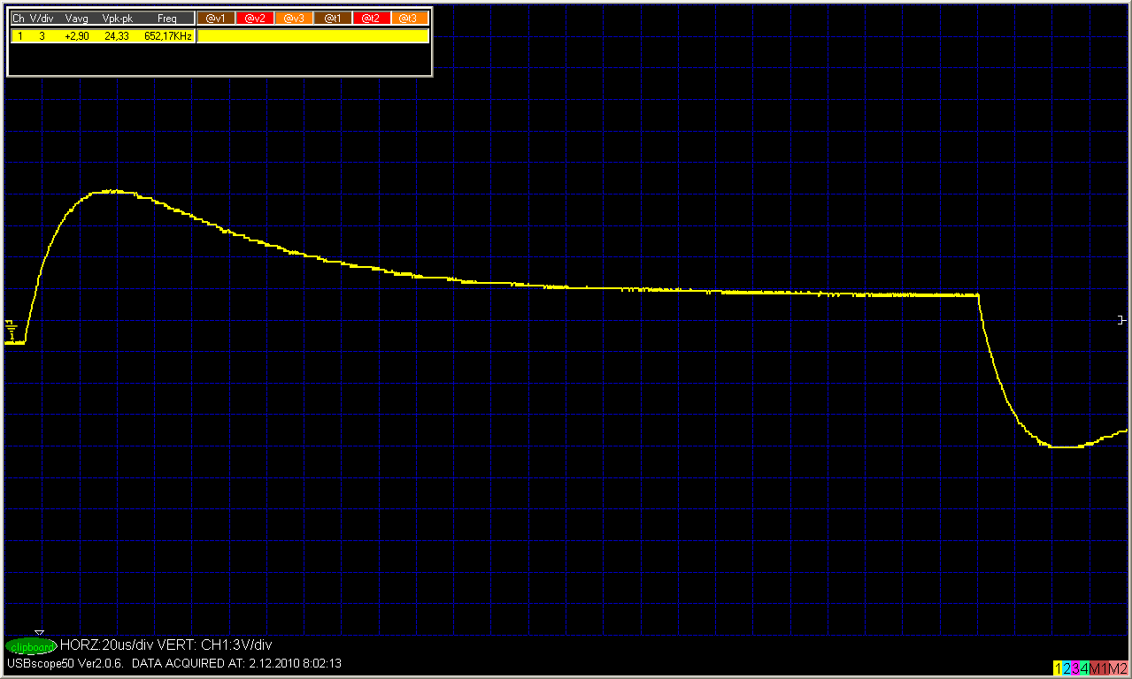

nice images from your phono stage. Are you willing to share your circuit?
I have reviewed your paper. The plots are for small signal (Fig. 8, in 10mV/div, e.g.). My measurement was done with 675mV of input signal amplitude, 1.35Vp-p, and with faster rise (shorter rise time) of input derived square. I have verified the result of measurements by math simulation, and results computed by SW are same as those measured. So I have no need to rearrange the measurement for conditions that are less severe, just to make them same as in your paper.
